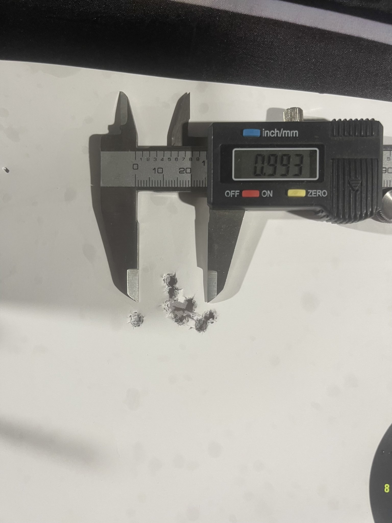

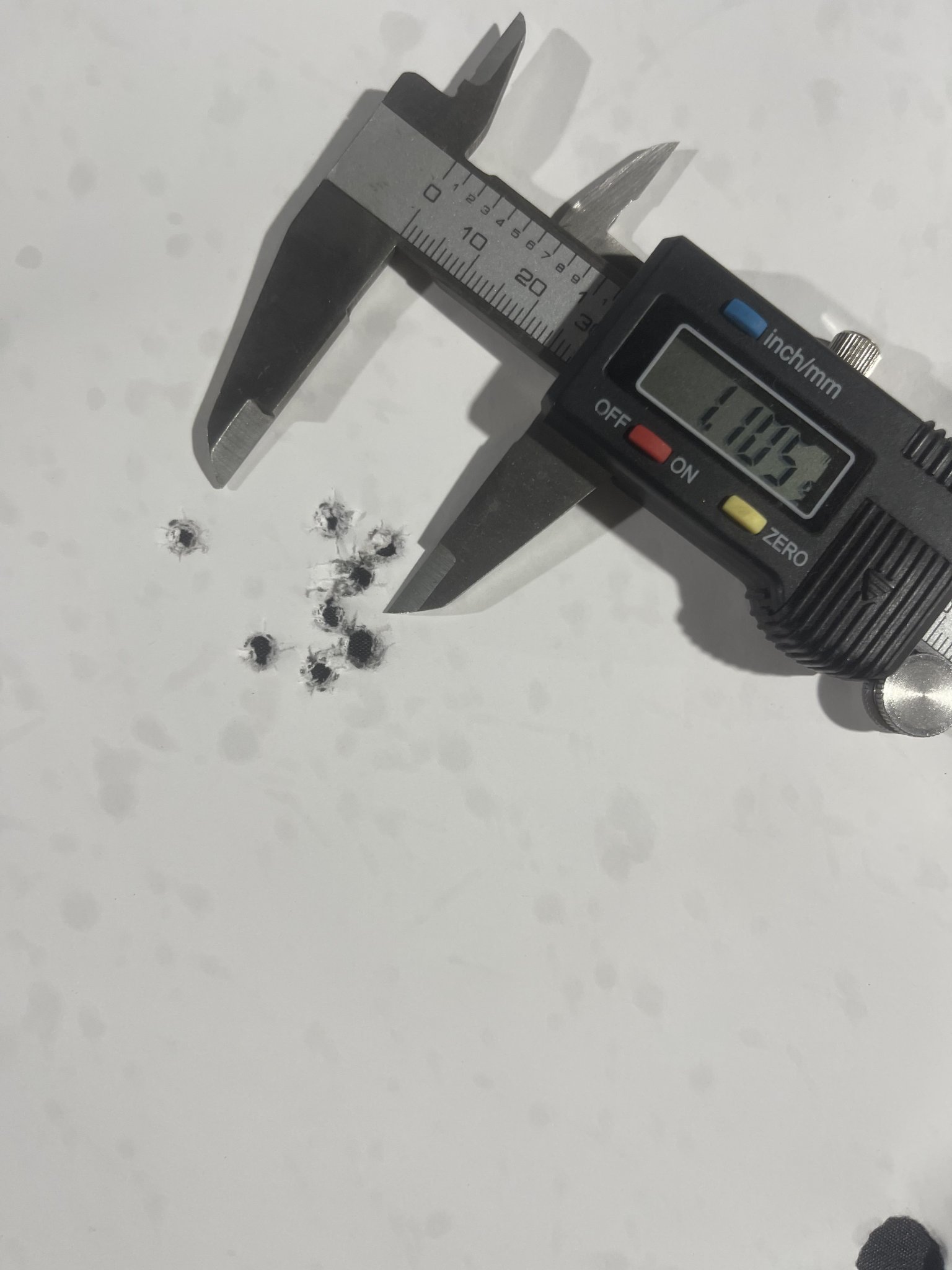

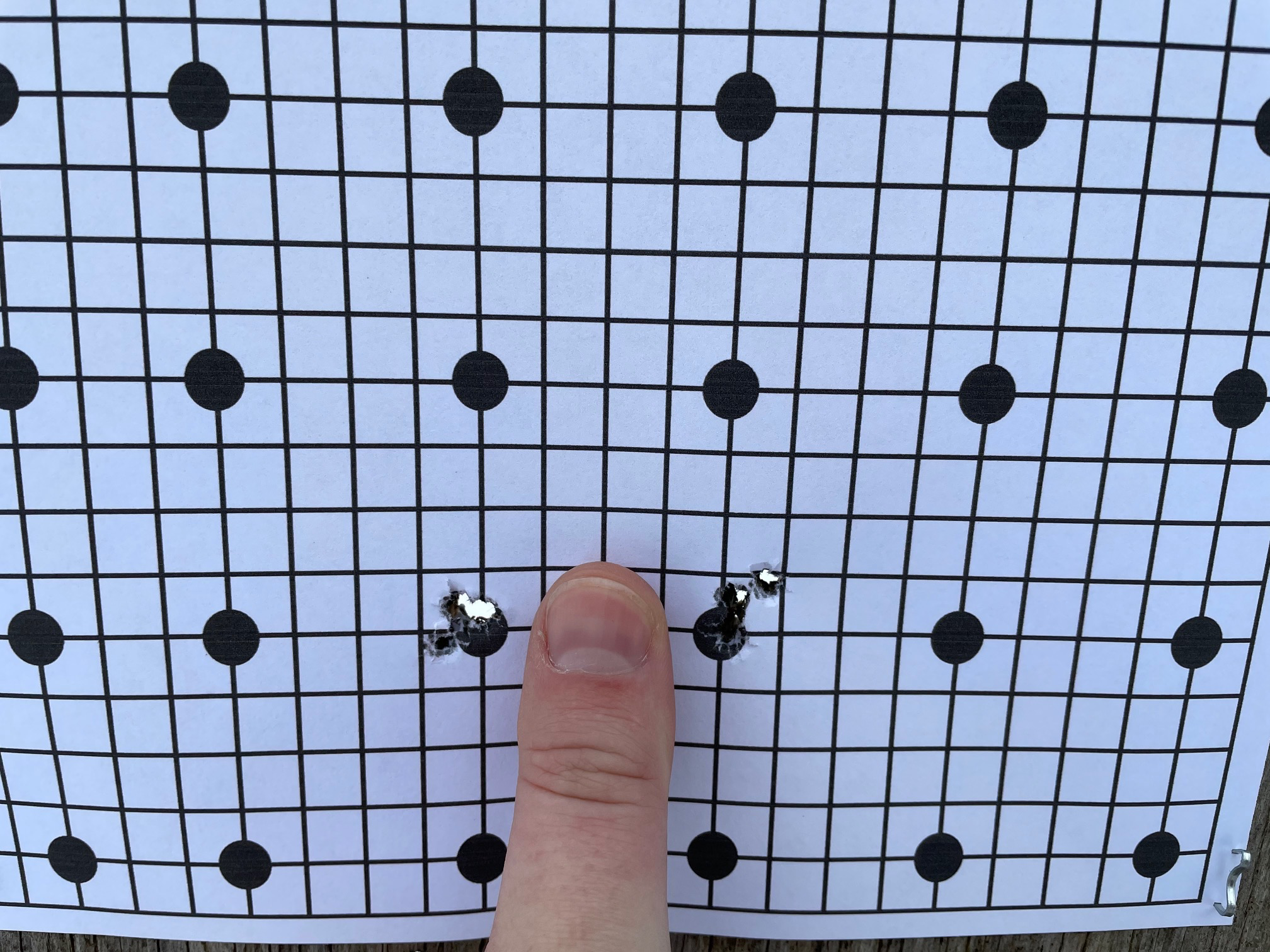

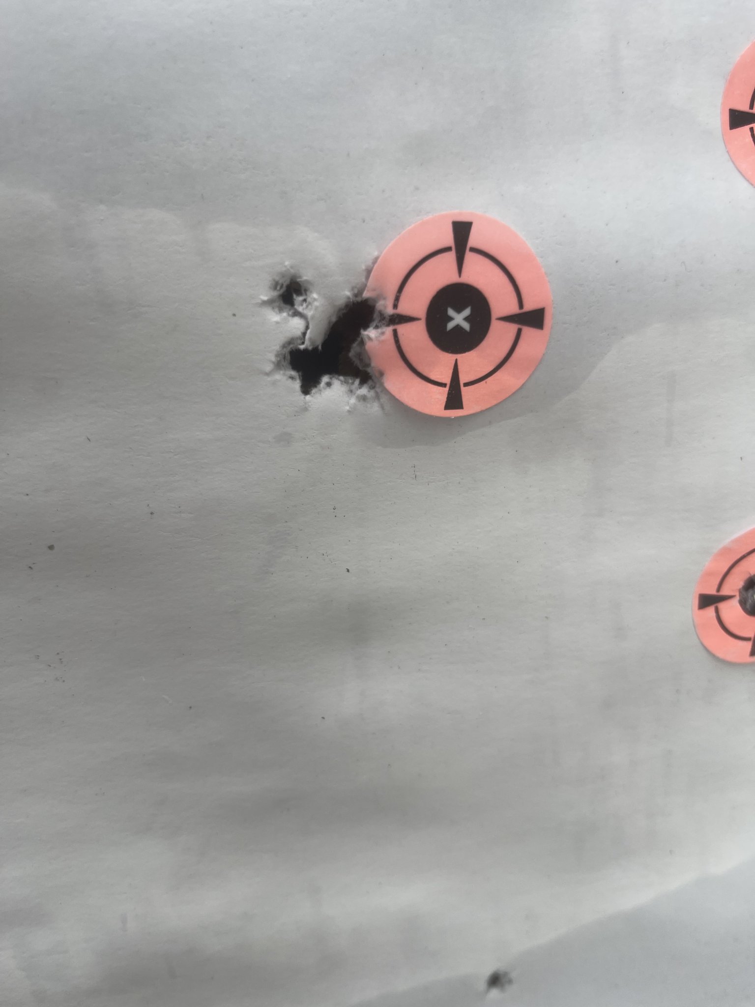

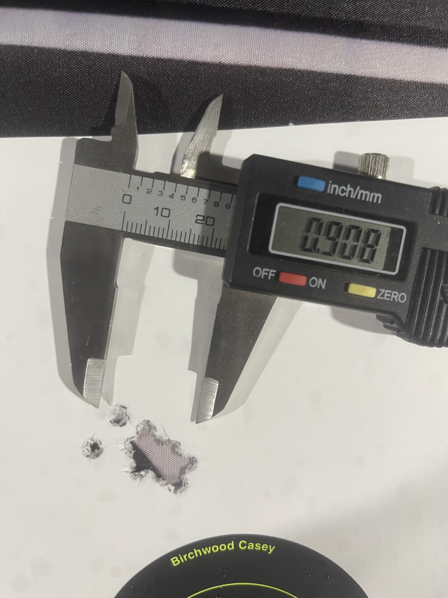

    So I shot it. Now this isn’t competition worthy I’m sure but it surprised me. You can literally see where the gun was shot suppressed, moisture collected only to one side of the barrel when it was laying on its side and caused some corrosion. I wish I took pictures but I definitely wasn’t happy about leaving it sit at some point with the can on.
    I’m sure it was up at our camp where we pound through a 500 round box of SK between a couple rifles over the weekend and I left the can on
    Anyways took it out for the first time this year. Up to a rainy and cold 35°
    Shot one group at 50 yards. Took me a couple shots to get on paper as the new DNT wasn’t bore sighted. Shot out of my kids bedroom of a plastic folding table
    50 yards. 8 shots of SK LR. I had 10 in the mag and I took the first couple to get on paper
    Next I moved to 100 yards. Shot the rest of the 50 round box. My drop showed 6.1. Not realizing that was in moa I donated the first few rounds to the swamp behind my target
    This is the last 3 groups at 100 yards. 30 consecutive shots with only 1 round which was the first of that group going outside 1 MOA. Otherwise 29 shots inside 1 MOA and think like 27 inside 3/4 MOA
    Doesn’t seem like anything is changed as this is how it shot before.

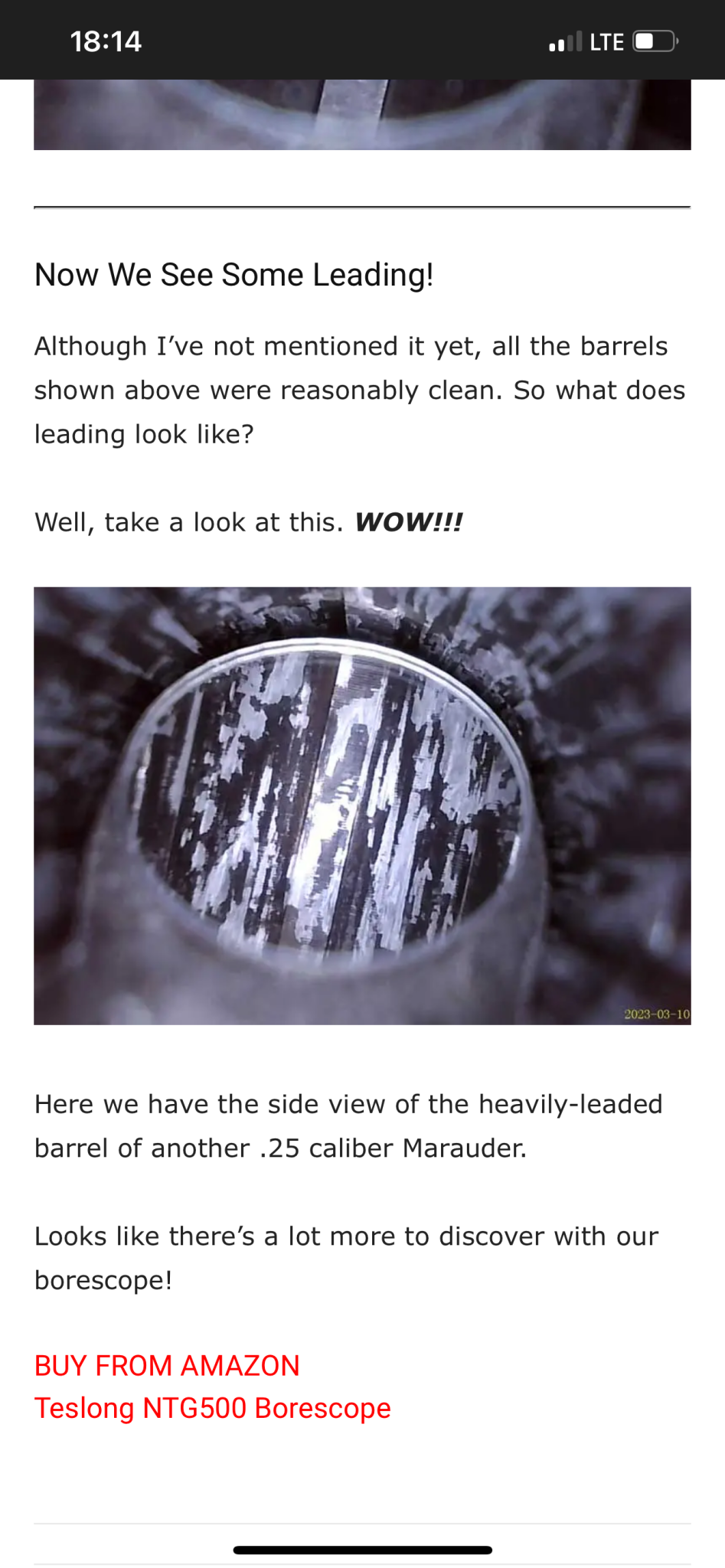

    No. I should have snapped some pics. I’ll post a similar image I found on internet. It’s more of a white looking spot. Perfectly clean bore. See all the lands. Then a spot that goes probably 5” from the lands forwards and on the left side only of the bore. Just in front of chamber. Right side is perfectly fine. These images are similar. You can’t really see the rifling in that area
    I’m open to learning what it may be. First time I’ve scoped my .22 other than just looking at the carbon ring. Never seen this in my rifle calibers
    Looks super rough in my bore scope. I cleaned with carbon remover. Then went back and cleaned following the procedure on the bore tech rimfire blend bottle. No change to this portion. The rest looks great
    Says leading in this pic from an air rifle
    Reactions: BowChamp
    No. I should have snapped some pics. I’ll post a similar image I found on internet. It’s more of a white looking spot. Perfectly clean bore. See all the lands. Then a spot that goes probably 5” from the lands forwards and on the left side only of the bore. Right side is perfectly fine. These images are similar. You can’t really see the rifling in that area

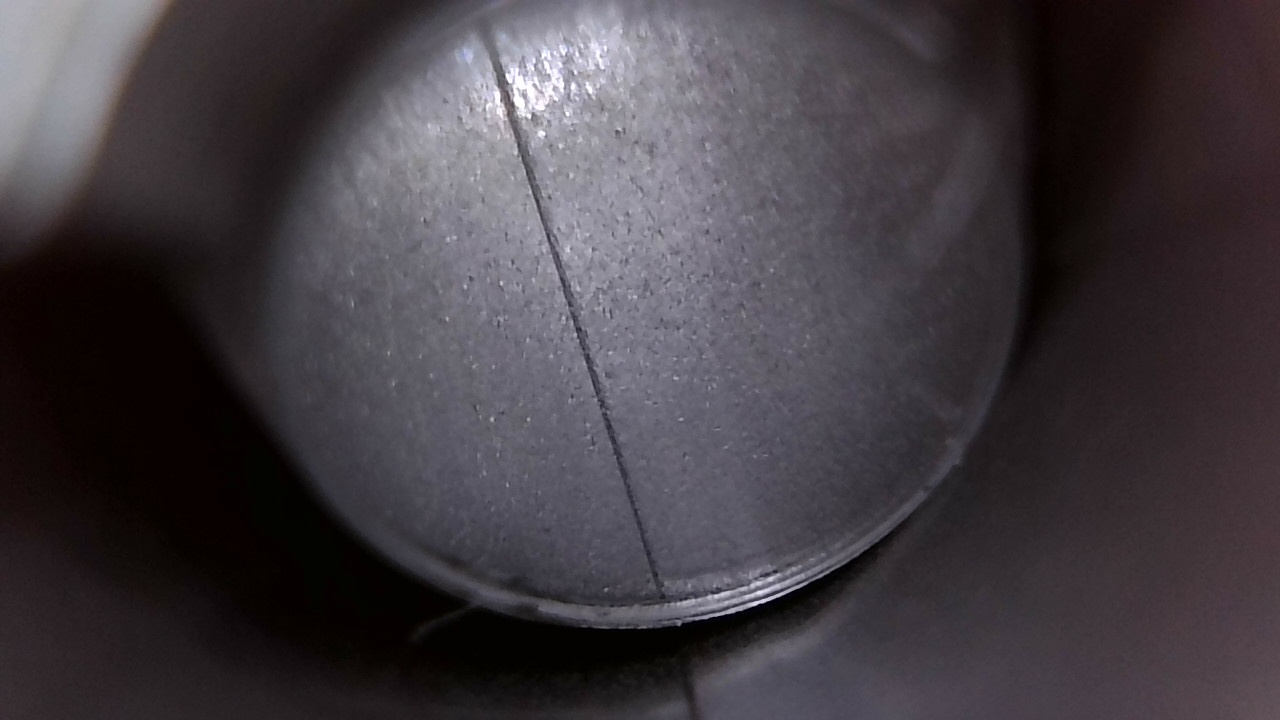

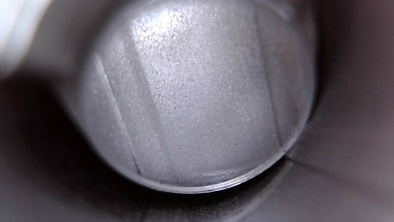

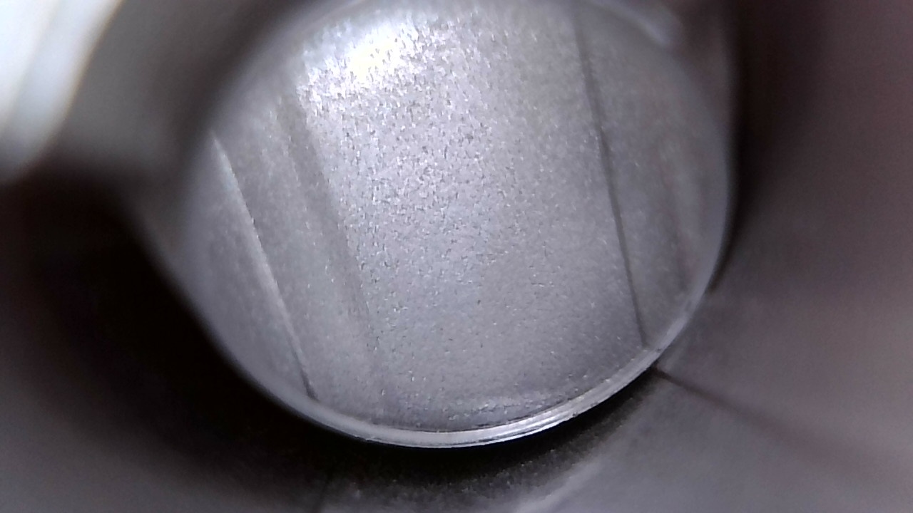

    Is it closer to chamber or muzzle? Pics of your barrel would be great.
    I didn’t grab pics then shot a box of ammo over it today. Maybe I can try tomorrow to see what it looks like. Really irrelevant now with the fact I see no real change in performance after shooting. Which is why we all advocate shooting to see what the target tells haha
    It’s in front of chamber area on left side. Like moisture accumulation then laid the rifle on a table. Or an issue in that exact area. I can see parts of it where the lands start. Then forward maybe 5”. Some more down the barrel as well but not as bad. Same thing all on the left side of the bore

    It looks almost identical to the pic above. But mine has less detail between the grooves/lands. I’m still learning as well. I plan to take this thing to several hundred yards on steel coming up so don’t want it hampering my velocity spread either
    View attachment 8632328View attachment 8632329View attachment 8632324

    Yes that accuracy is good, unless you are getting large ES/SDs lot testing of ammo is more likely to get an improvement than a new barrel.
    The rifle shoots good based on those groups. it is worth of shooting in any NRL22 or PRS Rimfire match.
    I agree, clean the chamber and push a wet patch down the barrel, call it a day. That's good for a factory Bergara, might get a little better with some lot testing. Another case of throw away the borescope and look at the target !
