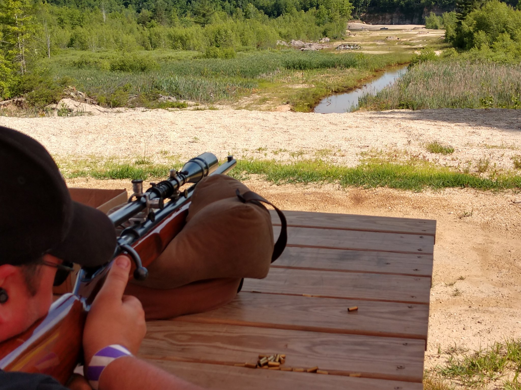

    I recently got grandad's Model 37 Rangemaster shooting again and was hitting targets at 400-yds with it, albeit those hits were walked on to target like artillery! Anyway, I had a blast ringing steel at 178-yds all day with an old box of Federal my cousin found and gave to me.
    I do have some questions about this rifle....it belonged to my wife's grandad and he passed 20 years ago before we met. It must have been his trainer rifle as it's set up just like his 1903 that he used at Perry in the 50's and 60's. I just swap the Unertl back and forth from this to the '03.
