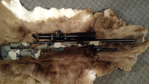

I had mine out today. GAP built 308 on an FN SPR.
I have a FN SPR, and love it. You gotta love a McMillian stock and chrome lined barrel that shoots sub moa. That gun is a lifer !

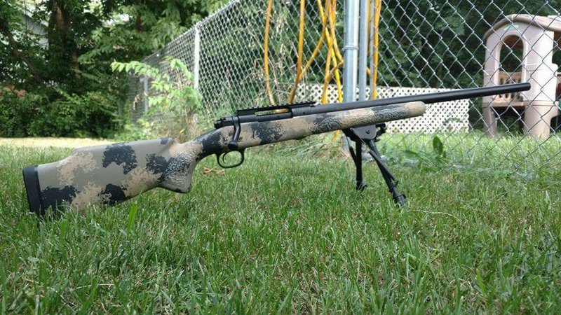

My main hunting rig is built on a push feed M70 action. I got there totally backwards from the normal direction, but I still love it. I purchased a box of stocks at an estate sale. Most were for Remington, one Ruger, and this Winchester takeoff from a heavy barrel tactical rifle. I tried to sell it, but nobody wanted it, so I found a donor rifle and had a barrel installed.
Sent from my SAMSUNG-SM-G891A using Tapatalk

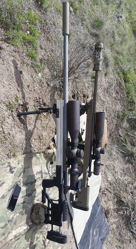

I use one. M70 push feed in 7mm Rem Mag, Black Hole Weaponry 24" 10-twist heavy barrel. Built specifically to launch 150-168gn pills from a bench or prone to 1300m. Wears a Choate varmint stock (chosen for it's heavy weight) and a SWFA 16x42SS optic (because I won't have the 2 grand for a good scope for it till mid-summer).
https://www.youtube.com/watch?v=2r9vK9OySYg

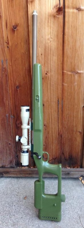

I'd like some more details on this barrel block setup.
Young’s Gunsmithing in Sand Coulee, Montana builds them. He's a very good Winchester Smith. He can use about any A-series McMillan stock, most of the Manners stocks or anything else that has a decent sized fore end. About any action too. This is his “medium block”. The block measures about 5.5” long. He’s also got a 4.5” “light block” for use with off-the-shelf MTU, HV, M24 contours, etc., and “heavy block” that is about 7.5” long for very long heavy barrels. He mills threaded columns and secures them into the stock for the DBM so that the action remains completely free-floated. This stock was actually inletted for a SA rem 700. He just removed material to fit the long model 70 into it.
This rifle weighs 13.6# as pictured. The block is aluminum and the barrel shank is machined to fit within the block so there is really no weight that has been added to the rifle. The barrel is a custom contour which is essentially a Sendero with an extra-long shank. I am sold on this setup. I’ve never shot anything that is so consistent. I don’t even get a POI shift when hanging a suppressor on it.
