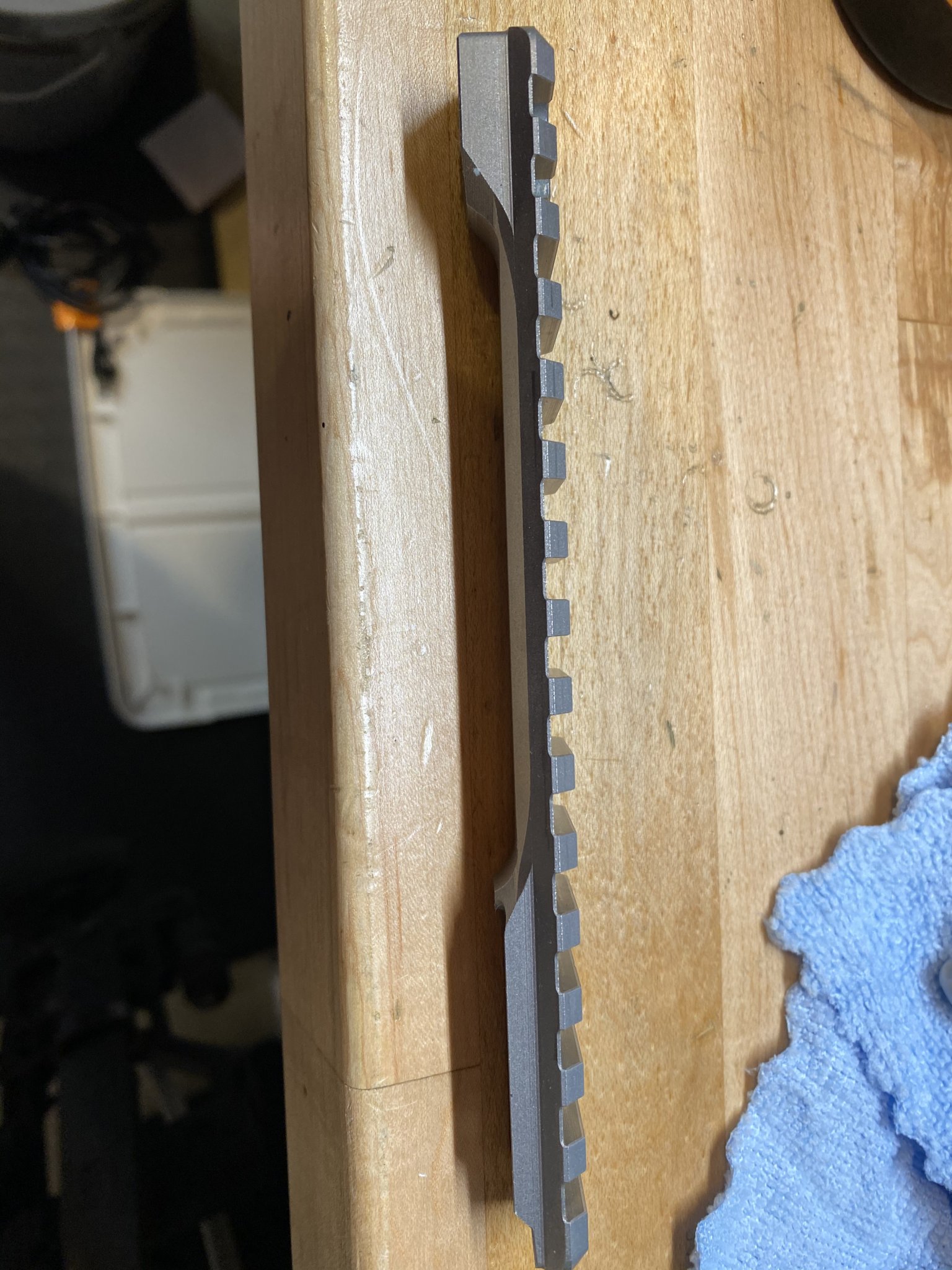

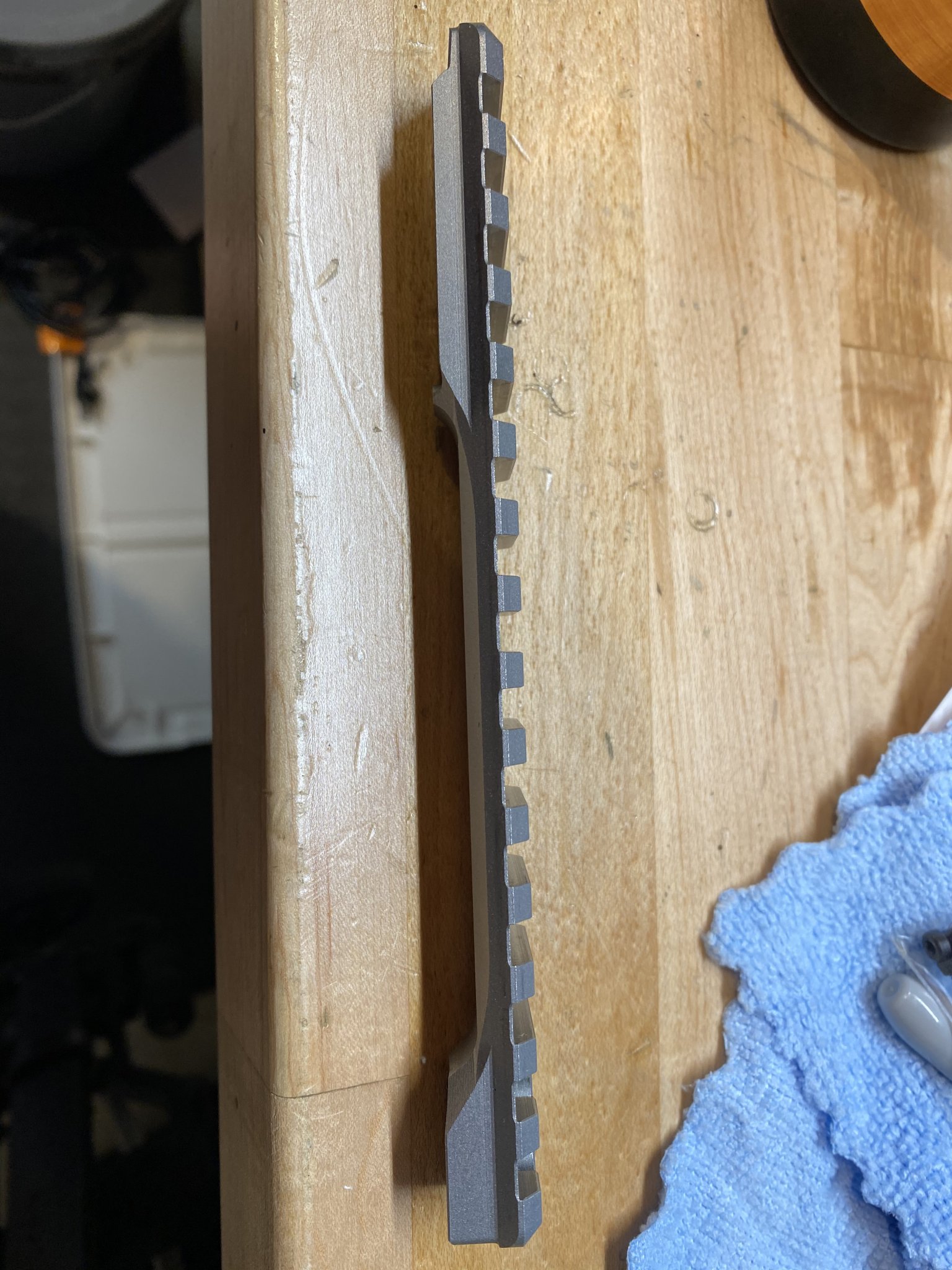

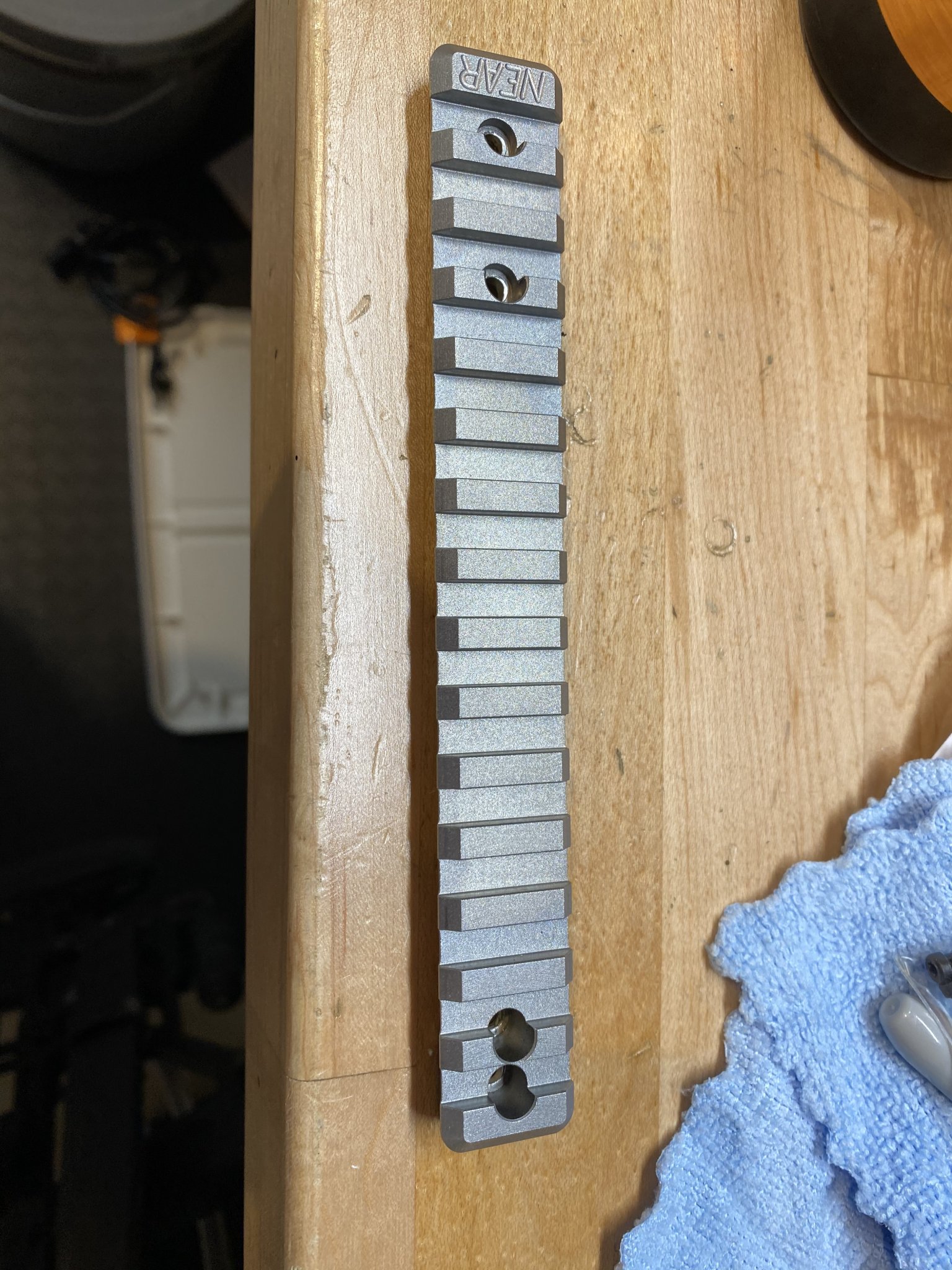

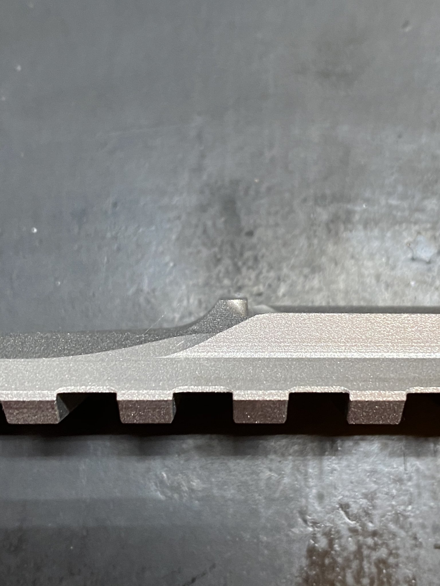

Richard Near.... did my custom M70 Safari Grade Magnum rail with the wacky hole spacing.
(rifle is gone but I still kept the base because it took me a year and a half to find one… Even Seekins hosed me on the promised rail for that rifle... waited 3/4 of a year, called him a few times, and one day I just got my money refunded on the credit card with no explanation for why he dropped the ball... and it’s not like I was calling him all the time bugging him for it.)
i’ll post a picture of the near rail... its fantastic...
Reactions: stello1001
Example of Richard Nears work and designs

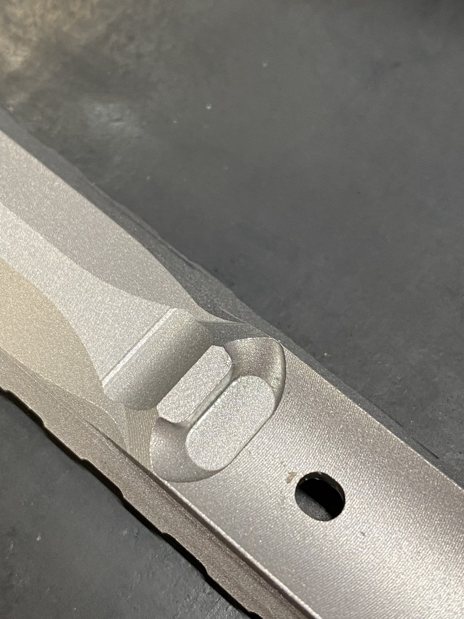

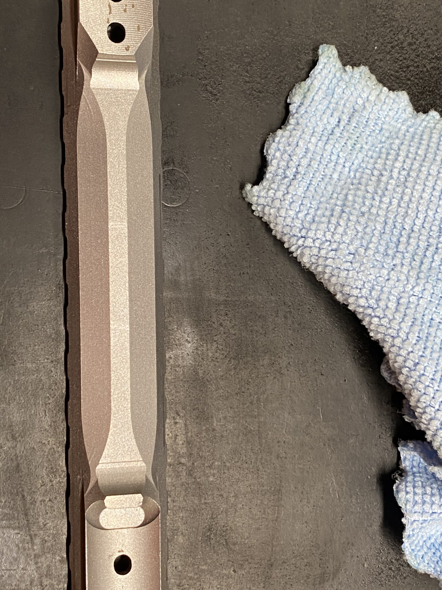

Now if you take a look at the bottom you’ll notice that it has a relief cuts so they can work on either left or right handed firearm...
And that there is a recoil lug for the base To keep to keep the scope from moving the base in any capacity...
View attachment 7372069View attachment 7372070View attachment 7372071
View attachment 7372074View attachment 7372075View attachment 7372076

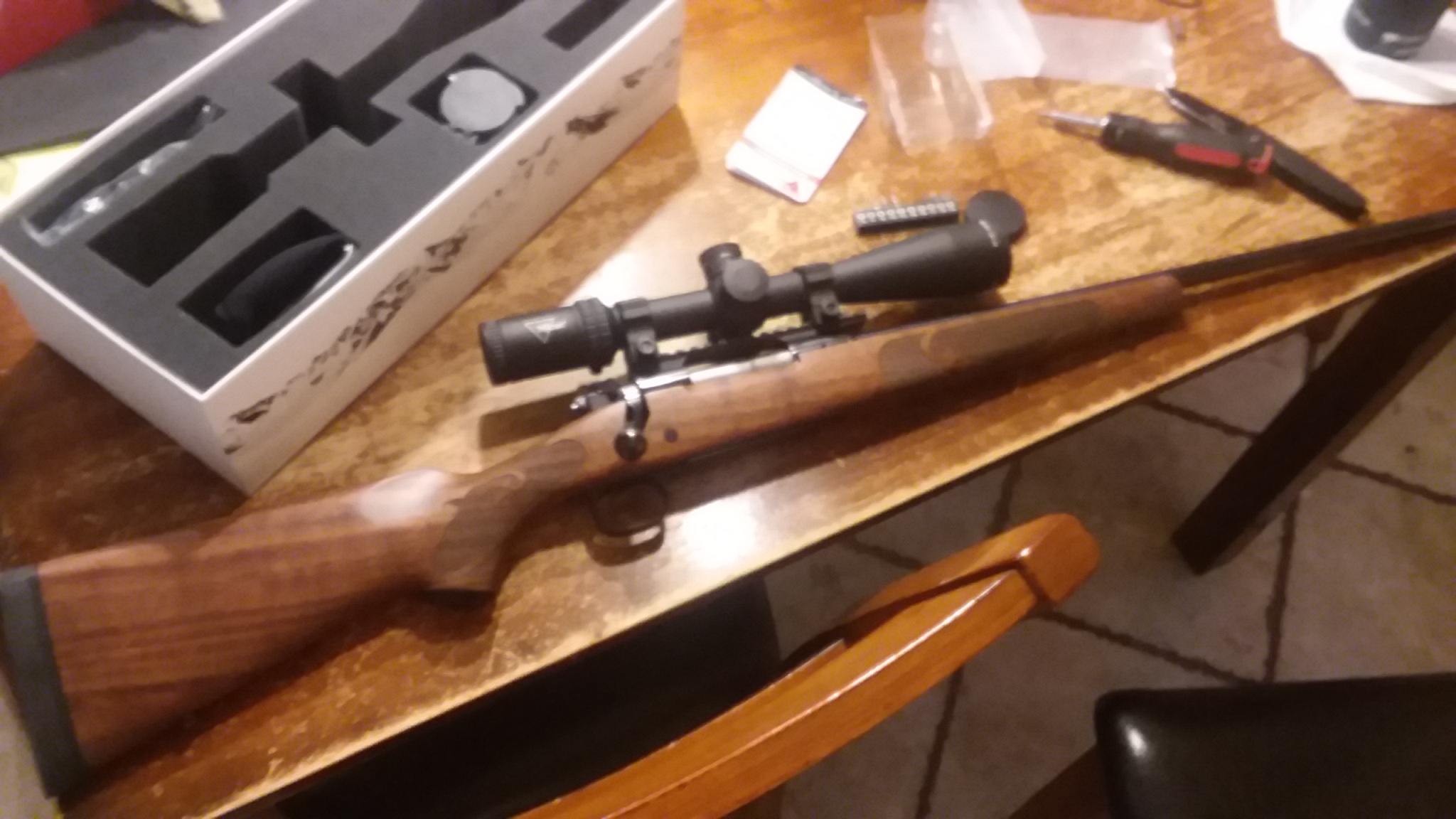

And we are finally in business. Went with the Nightforce mount offered to me by TerryCross.
I used a video by Ryan Cleckner to make sure I'd mounted the scope straight.
A possible variation occured to me on how to mount a scope if you can't be sure the rifle is perfectly straight (not what I did here).
