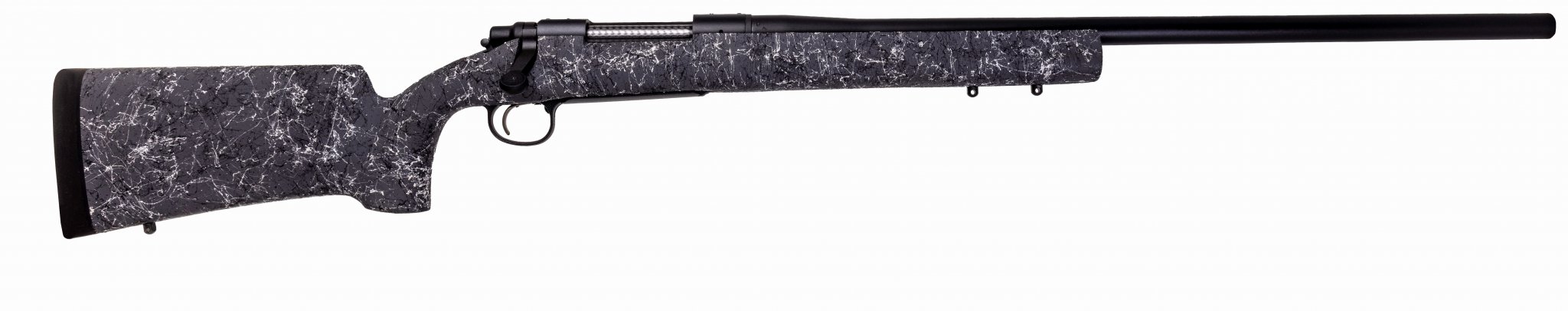

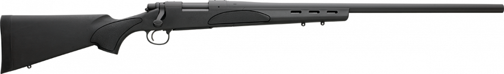

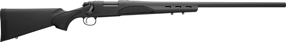

I am planning to do a build on a Remington model 700 platform in 6.5 Creedmoor. I am looking at KRG Whiskey 3 chassis with a Trigger tech Diamond trigger so not worried about the stock trigger or stock. I am trying to decide between the new 700 Long range and new 700 SPS Varmint. Both are new production models with 5R riffling. The main difference is the long range has a concave target style barrel crown but both have a 26" heavy duty barrel. So my question is which one of these guns would you suggest for a build like this? This is my first build and first bolt action rifle so this is all new to me. I don't know pricing but I assume the long range will be a couple hundred dollars more then the SPS Varmint. Thanks for the help!!

Buy the cheaper of the two If you plan on changing the stock and trigger anyways. They will both shoot about the same after your changes. If your budget is a little flexible, look at Tikka or a custom action and a prefit barrel.
I've got a couple custom 700's and one that's about to be. If I had it to do over again I'd have bought a custom barreled action from the get go.
Not sure about the new remingtons but right before they went under I wouldn't even take a chance on a new rifle from them. I hunted cheap used rifles just for a donor action.
I voted for the SPS since you plan to change out the stock anyway.
That being said, I went through this recently and ended up buying a custom action instead.
I started doing the math on buying a lower end tikka and then changing the trigger and stock and barrel... Ends up being about a wash.
In the long run, I think you'll have a better product for about the same price and won't be throwing parts away.

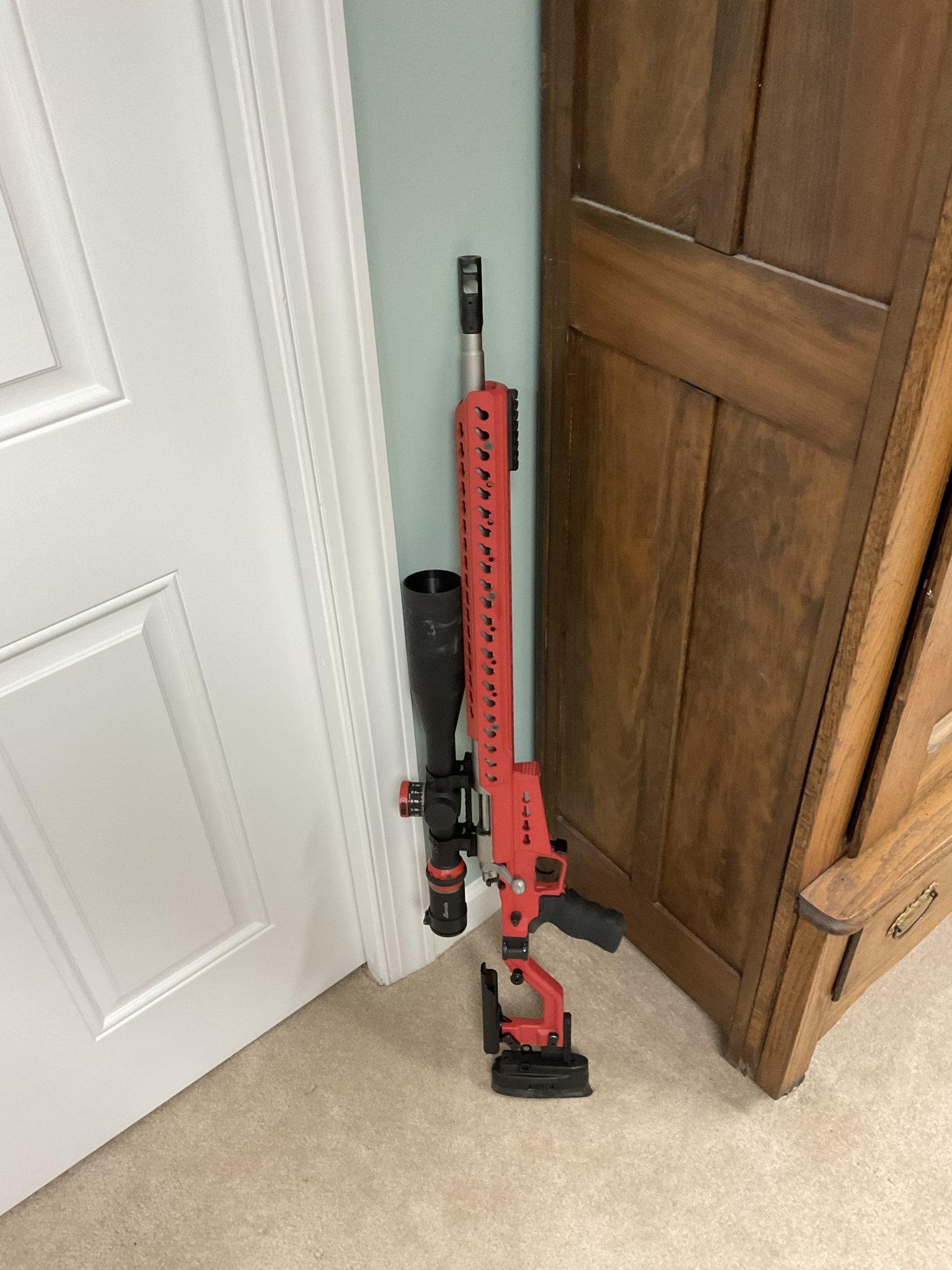

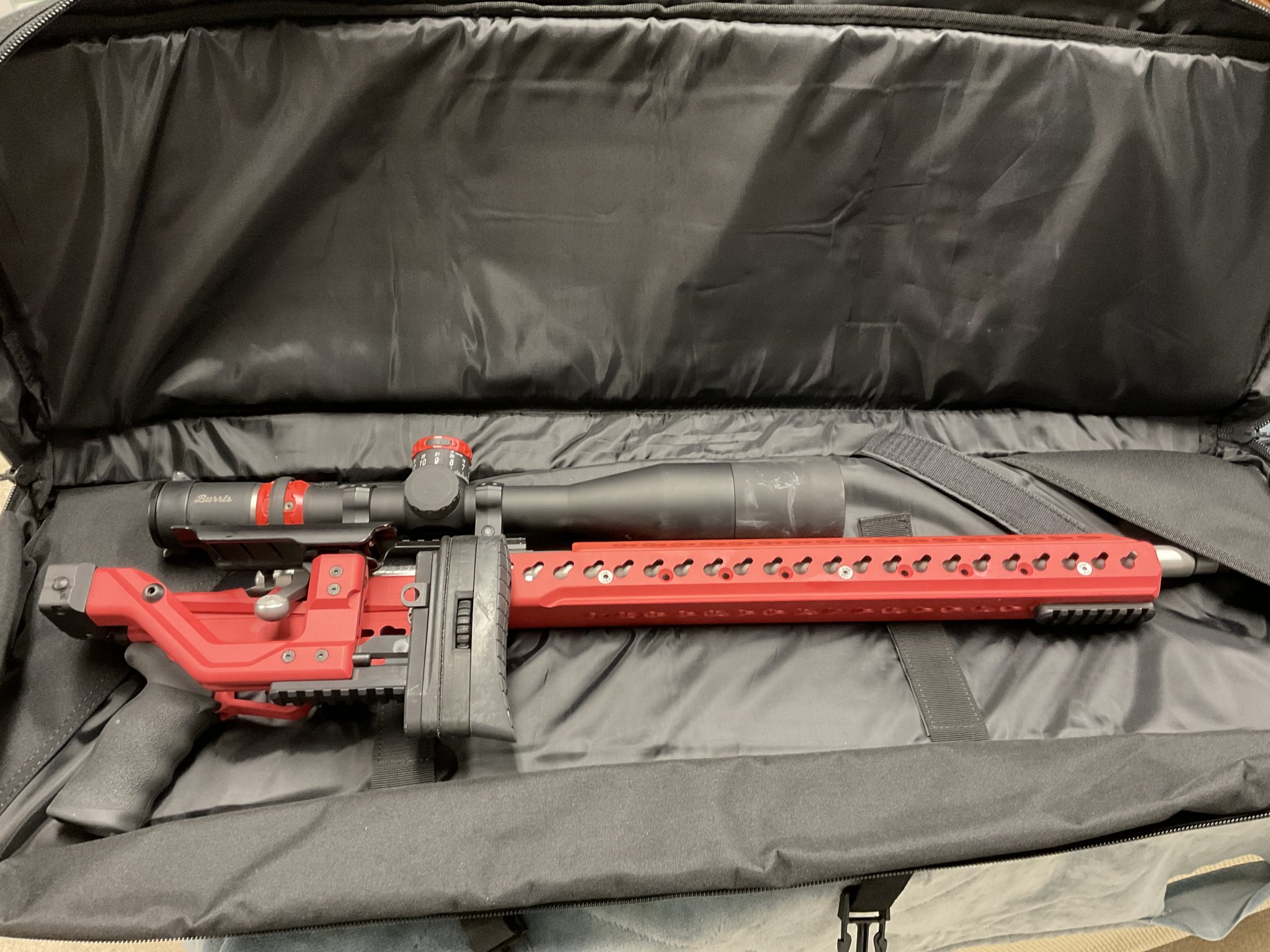

I used my SPS. The chassis turned it from a 1.5” @ 100yards to .5”. The factory stock was awful. Only thing different about it is the Timney trigger. The action is smooth, it feeds from the plastic AICS type mags, and is accurate enough for me and the silhouettes. Enjoy not spending Barrel and Smith money, if you can💇🏽
View attachment 8042141View attachment 8042142
What chassis is that ?

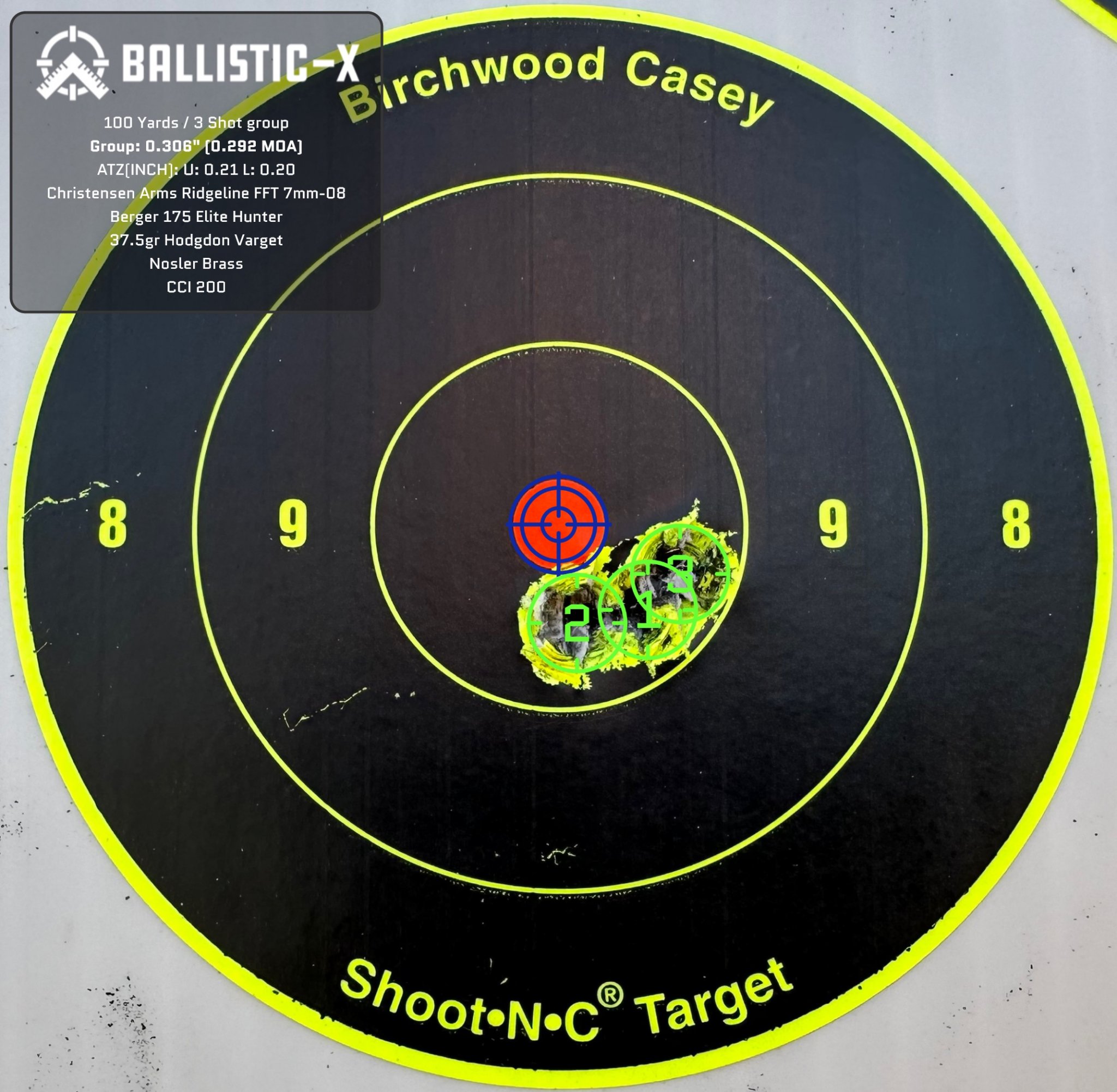

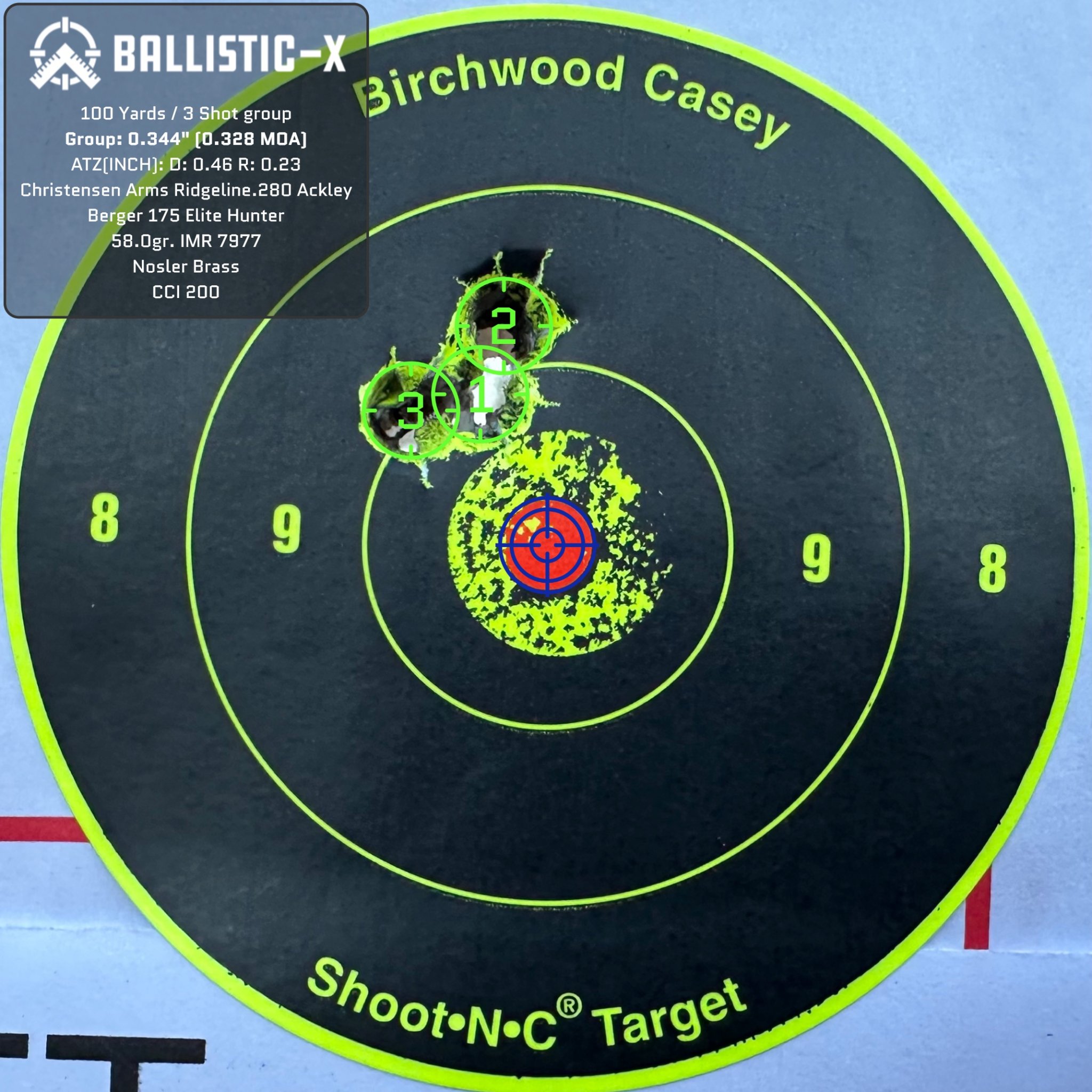

Get the 24” barreled option. It’s already threaded with a matching thread protector. Get a TriggerTech Diamond for it, and then drop it in your chassis. GTFG with zero smith work, hassle, or headache. 👍🏼
I have 3 CA rifles, and they are well-built. Essentially, they’re a custom 700 clone action, that’s extremely smooth with tight tolerances not requiring smith work. Both of my Ridgelines shoot in the 0.3xx” range with handloads. 👍🏼

View attachment 8042513View attachment 8042514
I have factory Remingtons that will do that, one from 1961 with thousands of rounds through it .
