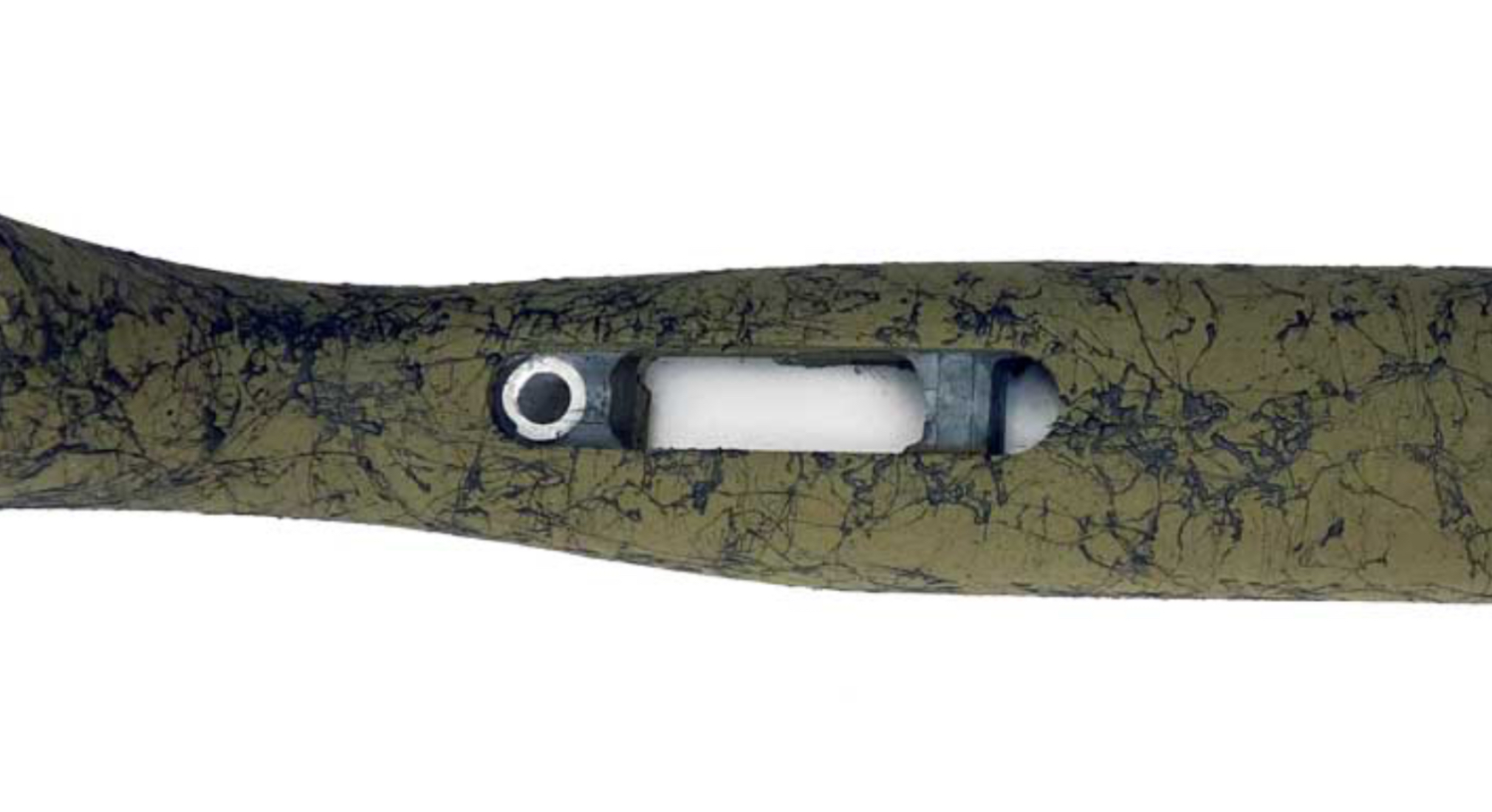

ADL Model. Struggling here but I’m sure I’m an idiot and missing something. The HS Precision stock has a void, open space where the front trigger guard screw would go. This void goes all the way up behind the mag box. So there is nothing to screw the screw to. Is this a stock that requires a single hole trigger guard? If so does the front slide in and overlap or something. Any links to help or buy whatever this stock takes would be great. Thanks.

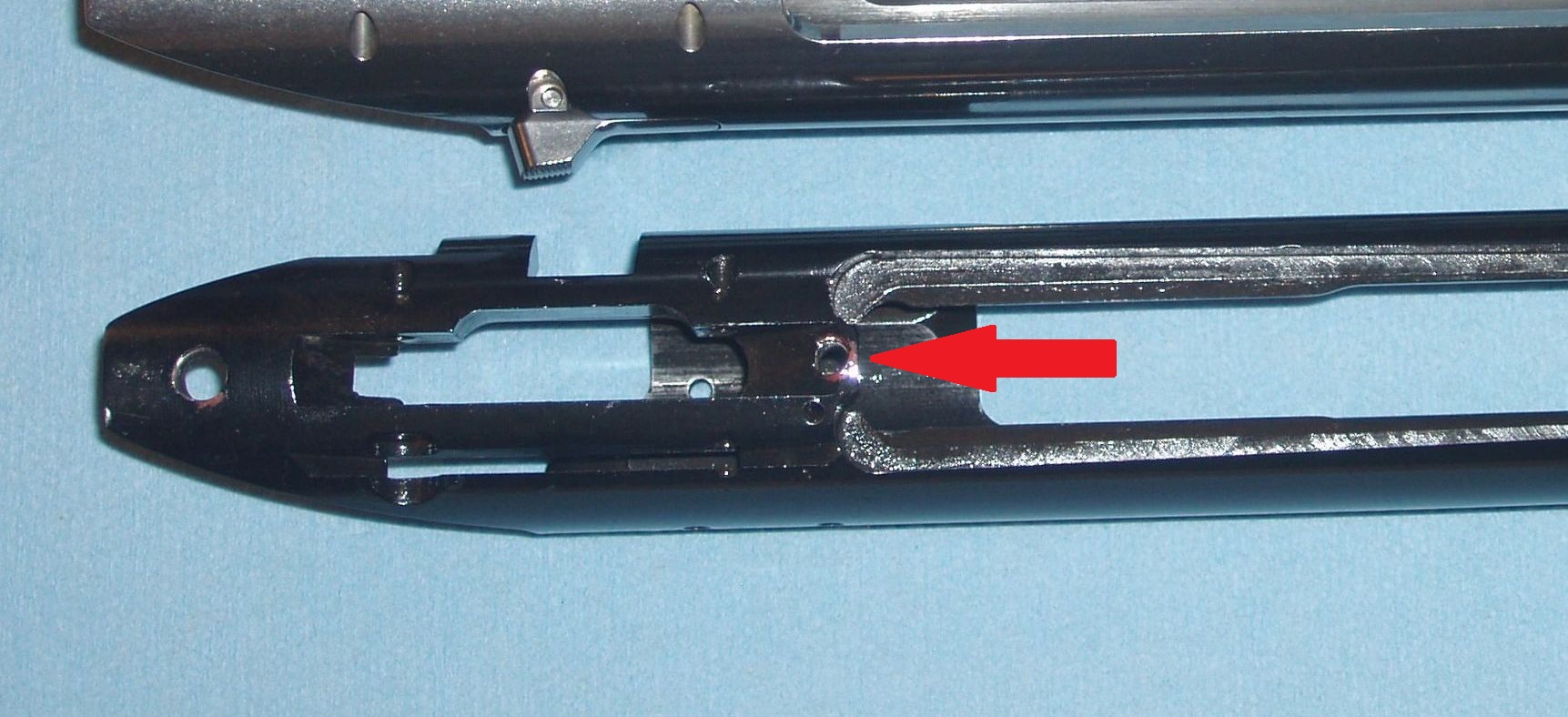

that screw doesnt get torqued on an ADL like the front and rear.
Just put it in and good to go.
Not sure if any action besides a rem 700 has that hole though.
None of my customs do anyways
Thank you for the comments. I should have mentioned its a Bergara Premier Action. Looks like it does not have the normal screw hole the standard Remington 700 actions have. So I guess I will find a one hole trigger guard or epoxy a screw head. Thank you for the pictures as well. Love coming here to learn more!
