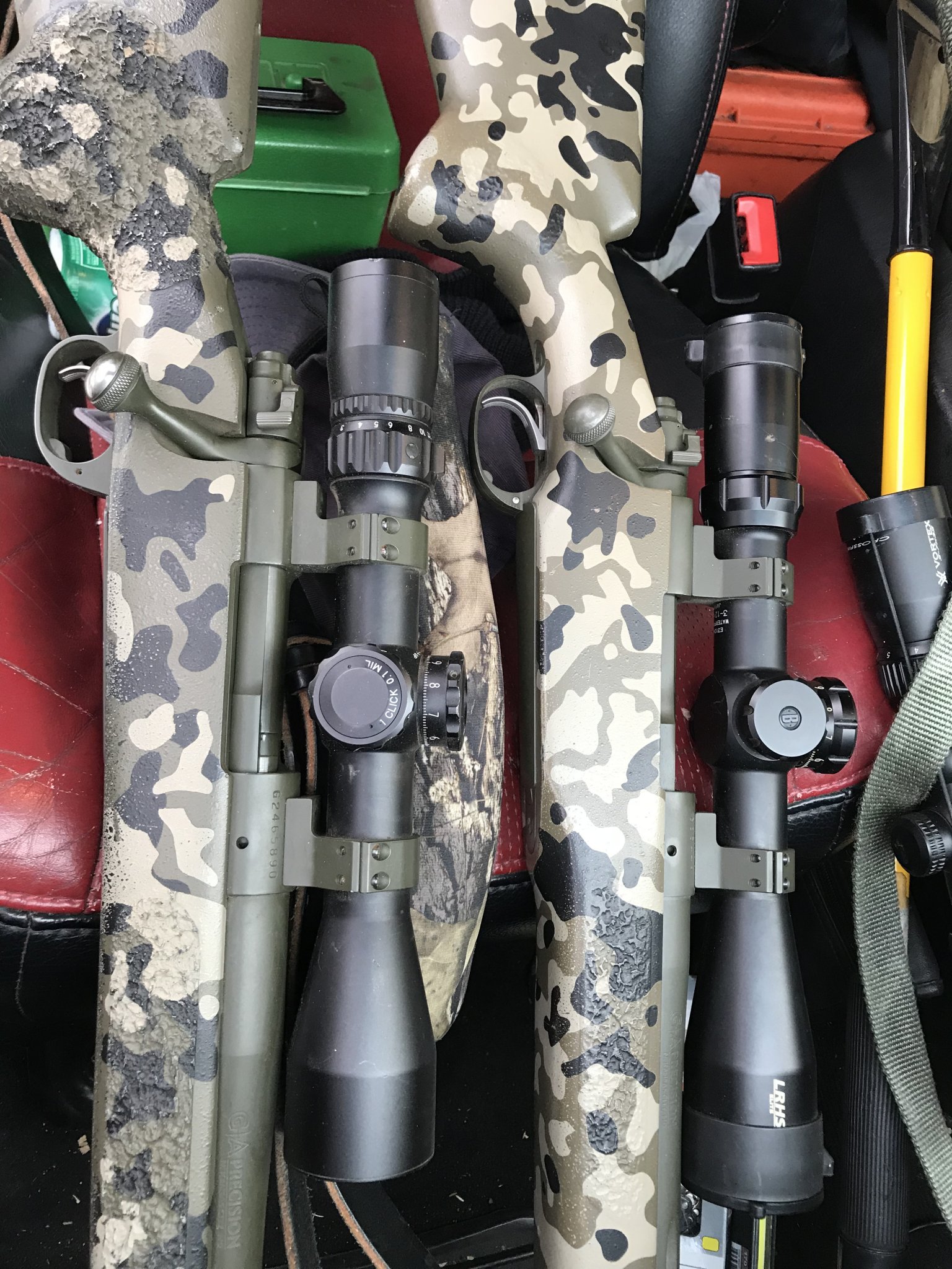

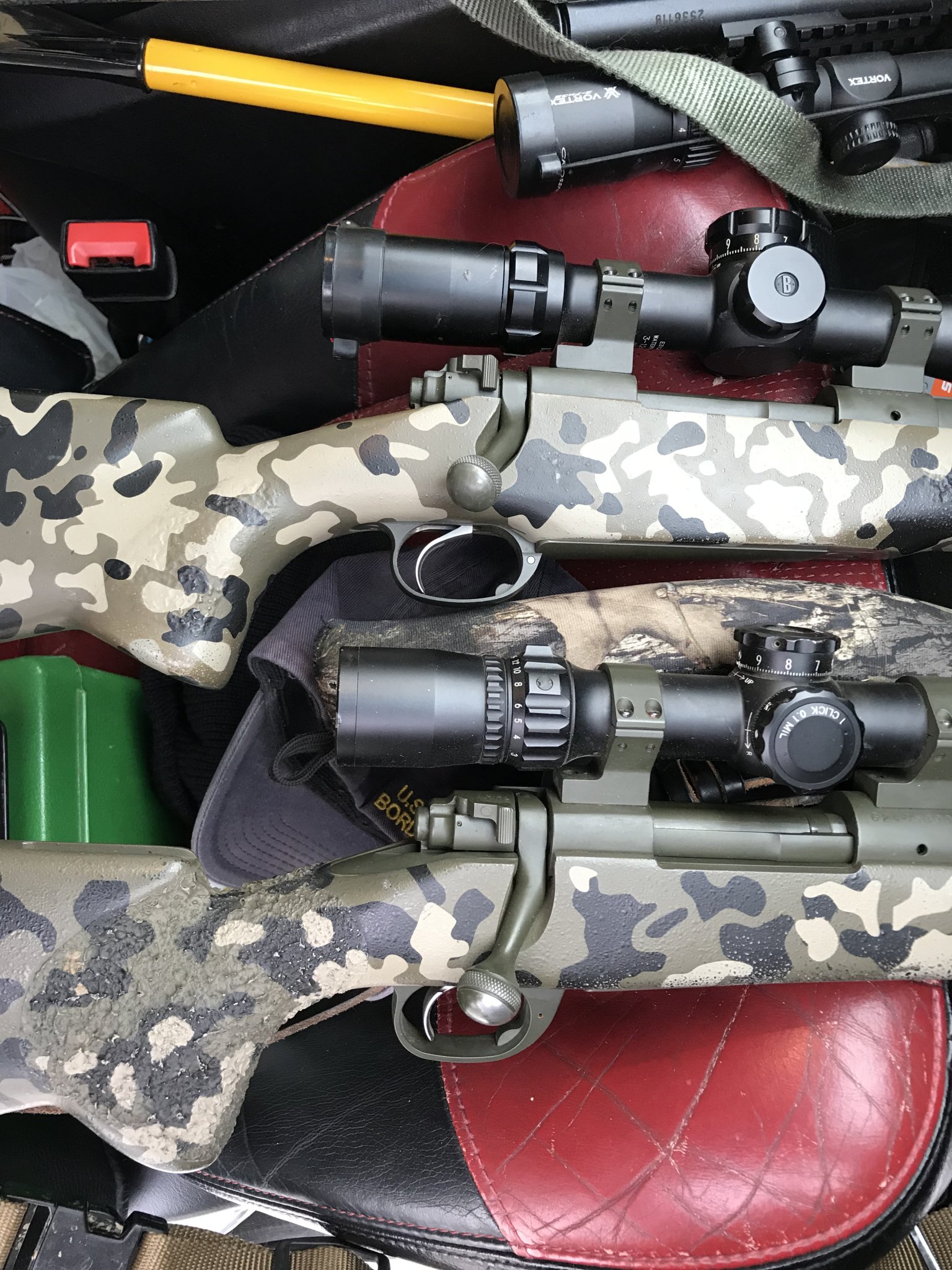

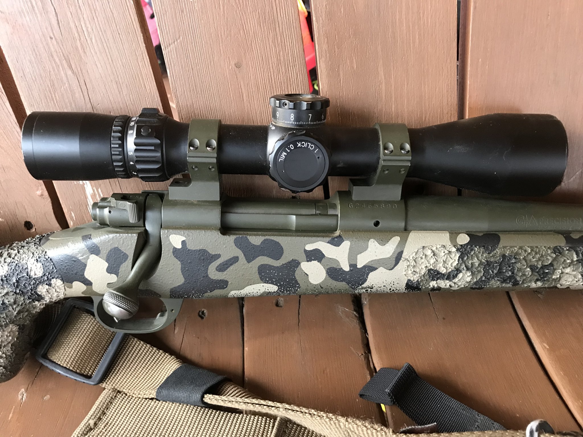

I love the Model 70 and the Mauser 98's for hunting rifles, I have gone into fine detail as to why in other posts so if interested just search on my name. No earth shattering reasons just what I appreciate in a hunting gun that is used out to 500 yards.
A few years back I decided to build a pair of classic hunting guns pretty much identical except for caliber, 7x57 and 9.3x62. I have a couple of decent English walnut blanks to stock the guns with. Now what action, I picked up a couple of Sears Model 50, before you puke on the Sears gun understand they were built on FN commercial Mauser 98 actions a good if not great action for a hunting build. The only mods I will do to the actions is to install a 3-pos swing safety on them, like the Model 70 has always had. The model 50's are sleepers, if I did not know better I would have thought what kind of quality would a Sears gun be, I have bought the Model 50's from $300 to $350, a pretty good price point.
Sorry to derail but thought I would point another possible path for a hunting gun.
They are both Manners MST’s, stock work by GAP and painted by Custom Gun Coatings.

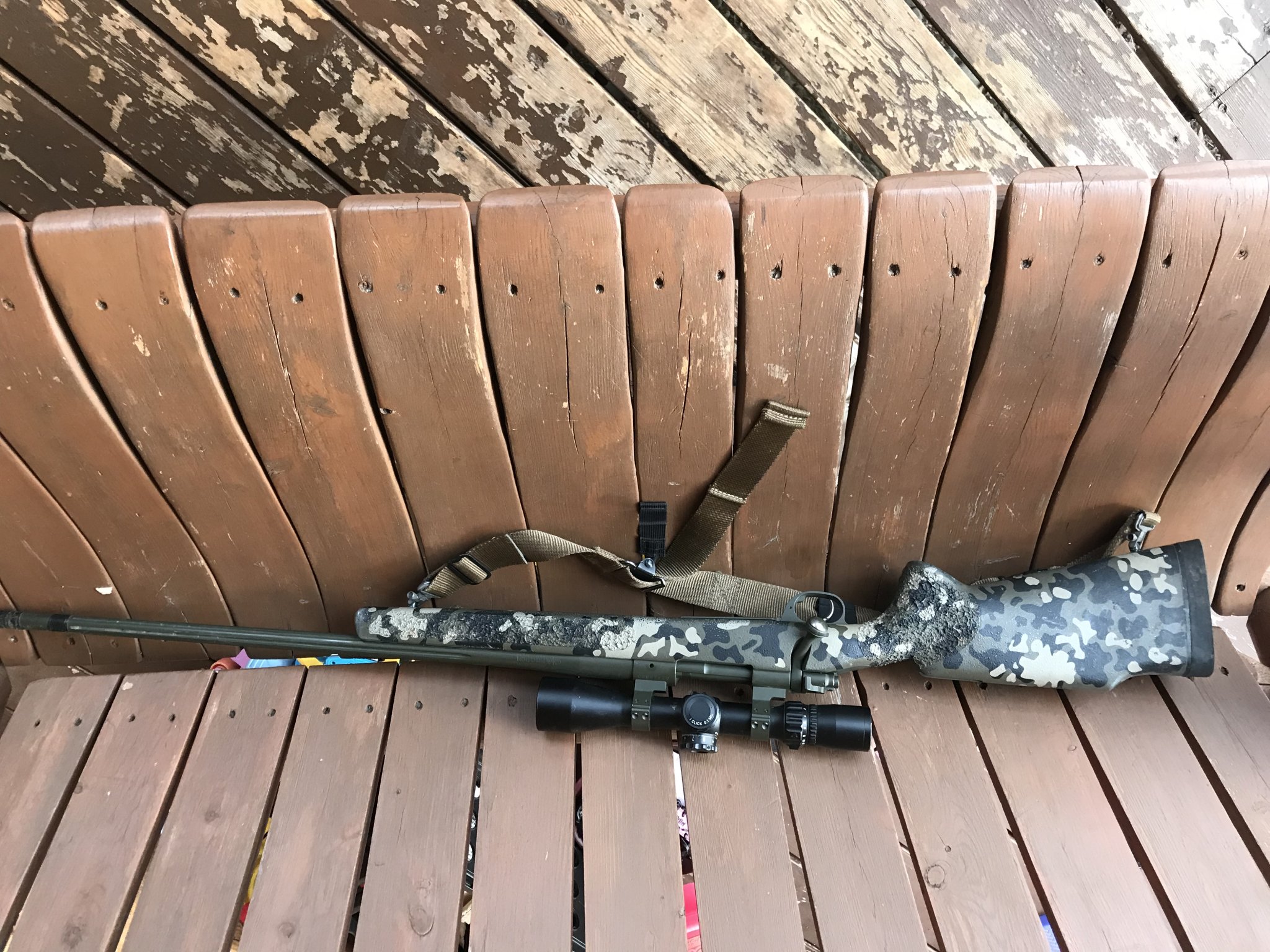

FYI. Tim Roberts the owner of Crescent Customs loves the M70’s, if your going custom may want to keep them on your radar. He used to work for GA Precision before starting his own shop. I am sure there are other great shops that work on 70’s

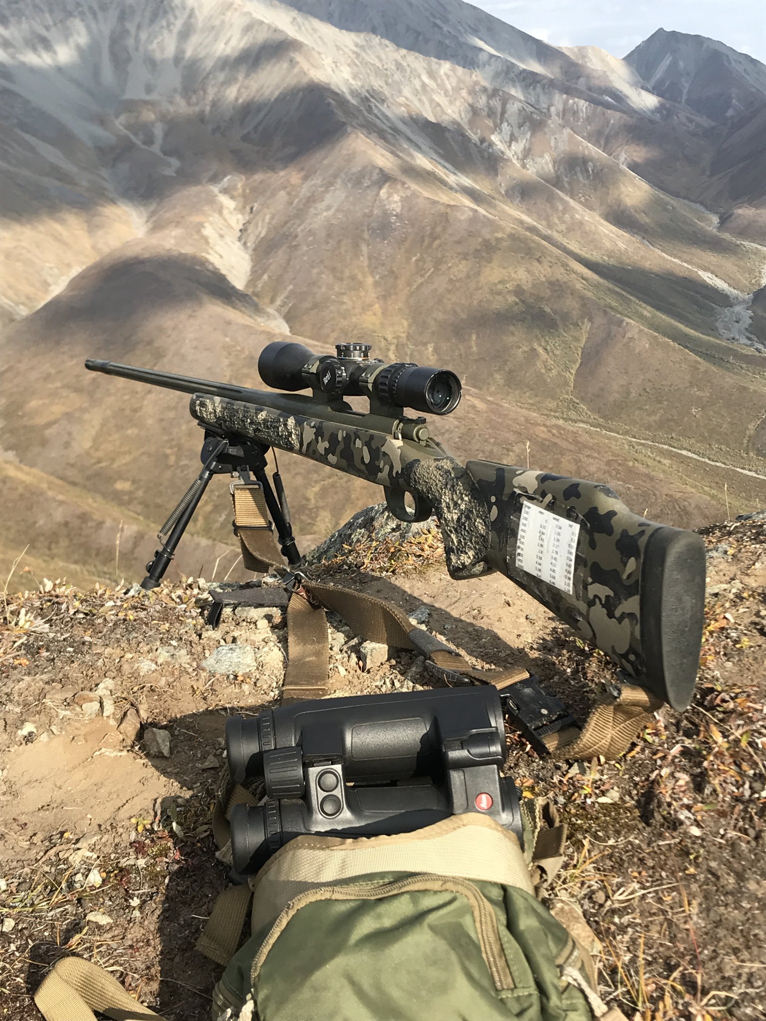

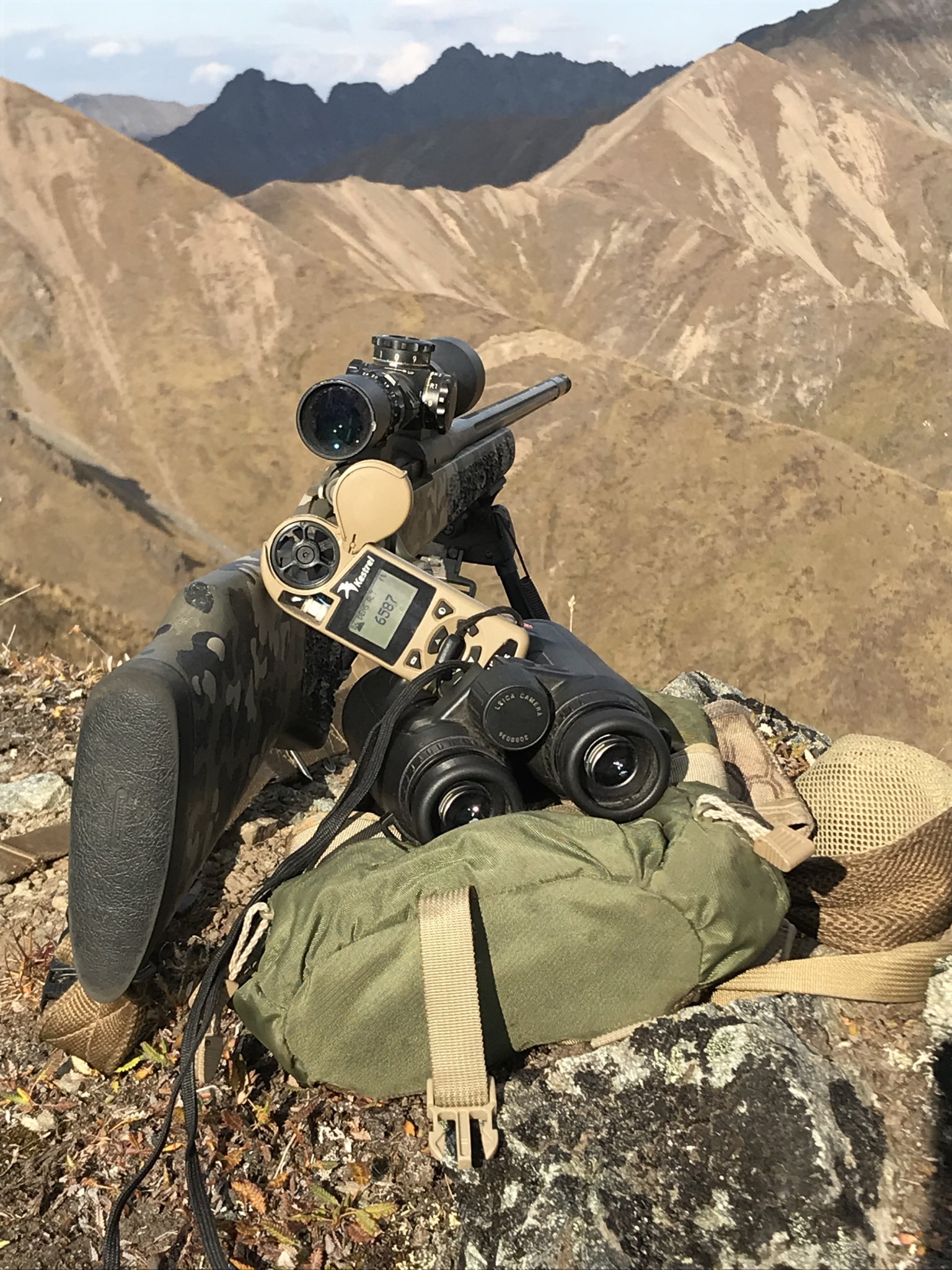

Mine are of the hunting lineage I have takes 4 moose with the SAUM and 2 with the 338. Numerous caribou some bears....

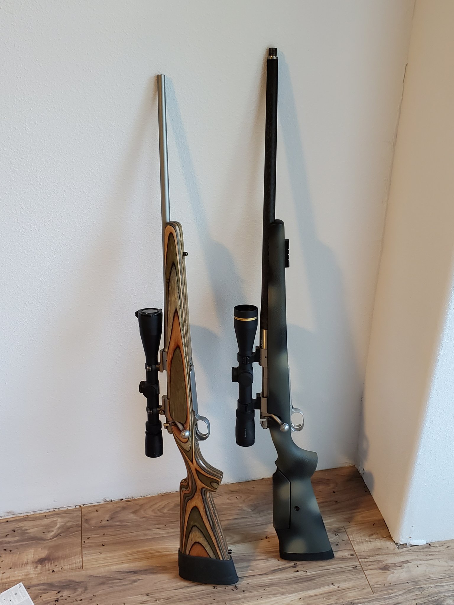

I have 3 modern Win 70s, all built and assembled in SC. Two are EWs: one in .30-06 Sprg and one in 7mm RM and one is a Super Grade in 7x57 aka .275 Rigby (I have a bunch of .275 Rigby Hornady brass). They are smooth, well-machined, and surprisingly accurate (<0.75 MOA). I will be investigating building a precision rifle with the 7mm RM when I shoot out the barrel. I have been very pleased with the B&C Al bedding block stock. I have Zeiss 3.5-10x40 scopes on the Extreme Weathers with Rapid Z800 reticles and a Leupy 3-9x40 duplex on the 7x57. I view them as exceptional rifles that are better made than pre-'64 rifles and have taken some game with the EWs...they don't warp, rust, malfunction, or, (and I give 20% credit to the operator) miss.
YMMV but I hope not...I've been delighted with mine.
