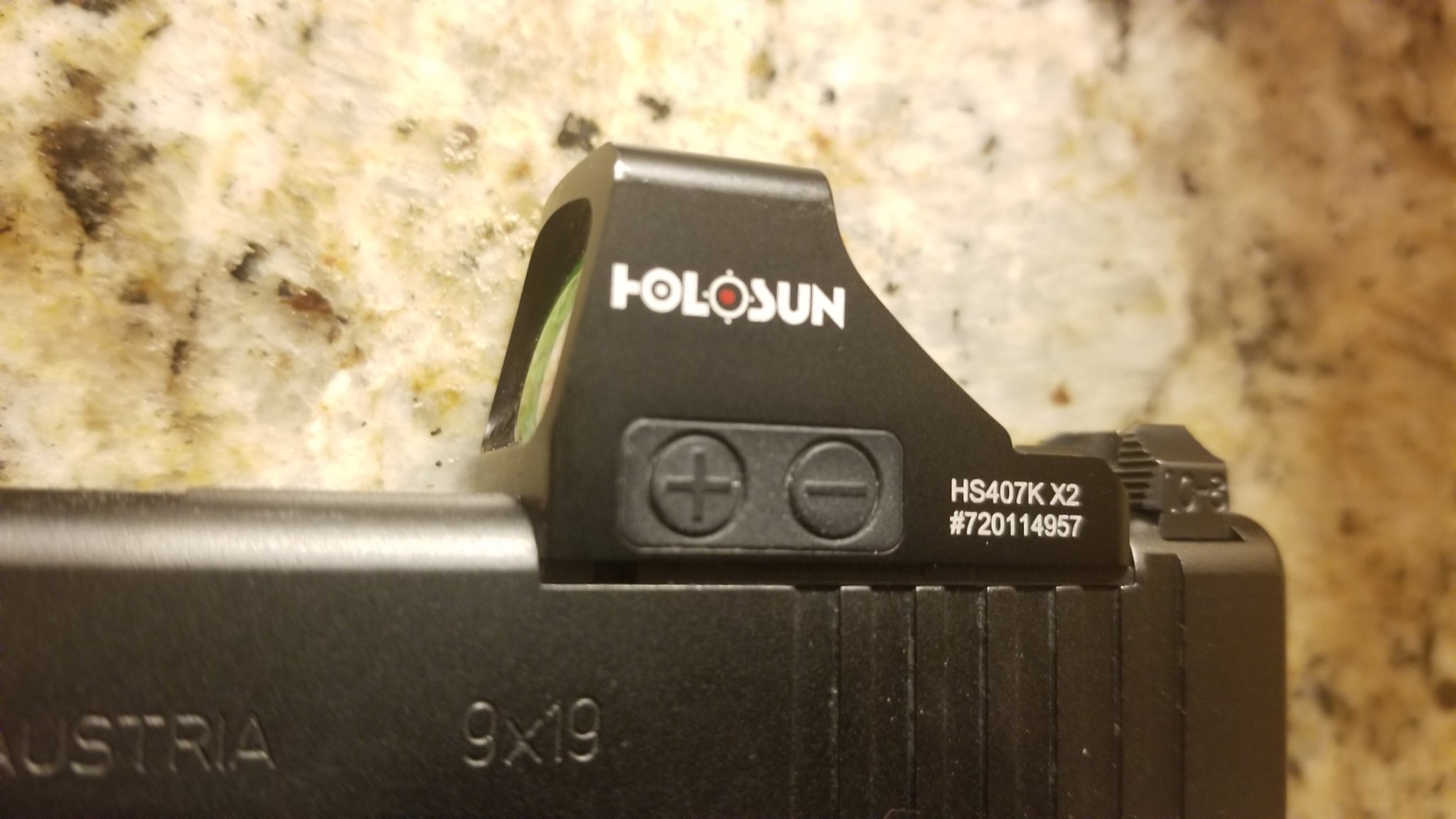

I haven't been able to find much info on this. I am wondering if anyone if has removed the rear lugs and shortened the front on their rmsc cut pistol.
I could use a plate but this video makes it look like the way to go.https://youtu.be/sCgDURCP2qk
When I dry fit the optic it feels like it slides all over. Just curious if that goes away when everything has been milled? According to that video it does, but I am just looking for some feedback if anyone has done this

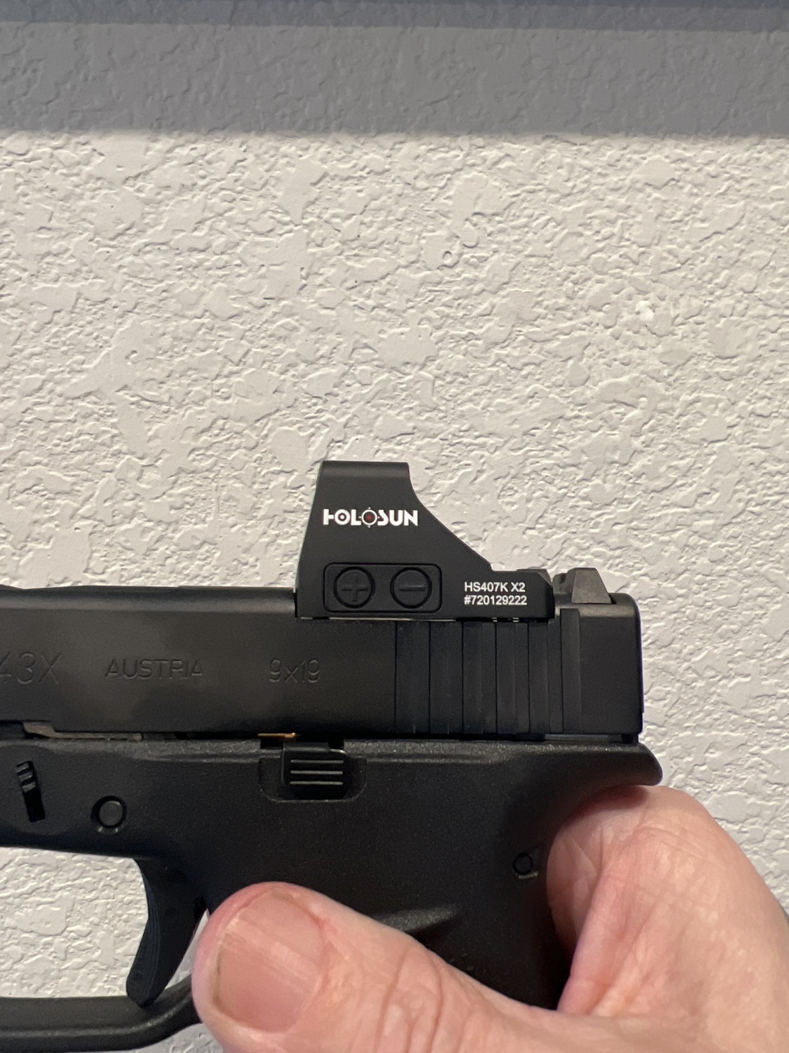

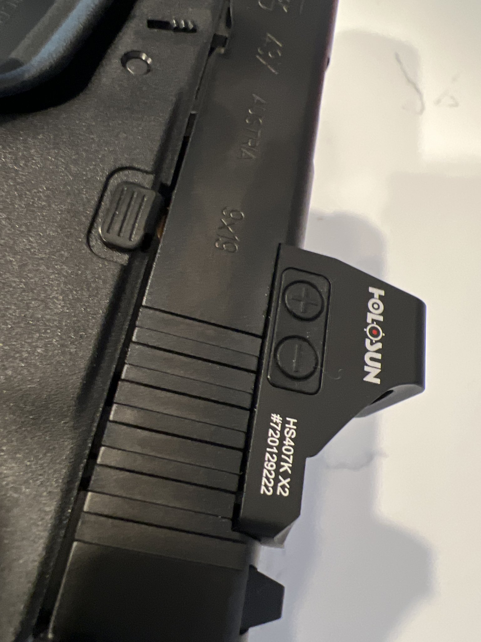

Not sure I get what you are doing, I have a 43X with Holsun it dropped right in
When I put a 507k on my 43x mos I used a smaller flat file and completely filed down the rear lugs flat to the slide and then just filed down the front far enough until the optic sat flush. I took my time and held the slide in a vice so everything was tight. I checked the front lug fit by putting a very small dab of grease on the lug recesses of the optic and checking interference when placing it on the slide. Kinda the same concept of plasti gage.
Back end of your optic is sticking up because there's no countersink for the rear locating studs in the Holosun.
The forward studs are also slightly taller than the countersink in the optic, so you end up sitting proud in front either way, without modification.

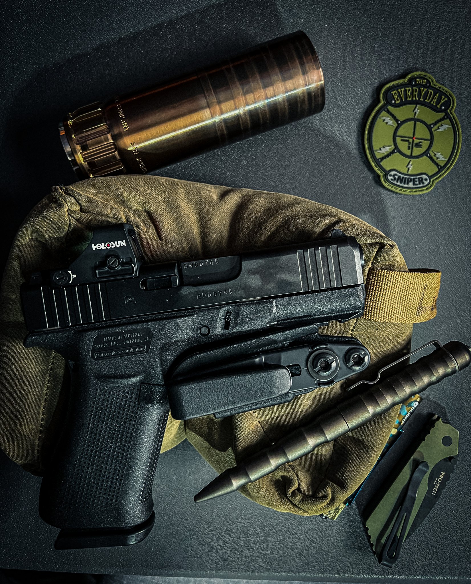

if it bothers you massively, sell the 407 and put the funds towards an SCS. Probably a better option than filing away material...
no plates, direct fit, co witness with stock sights if that's something you want...
