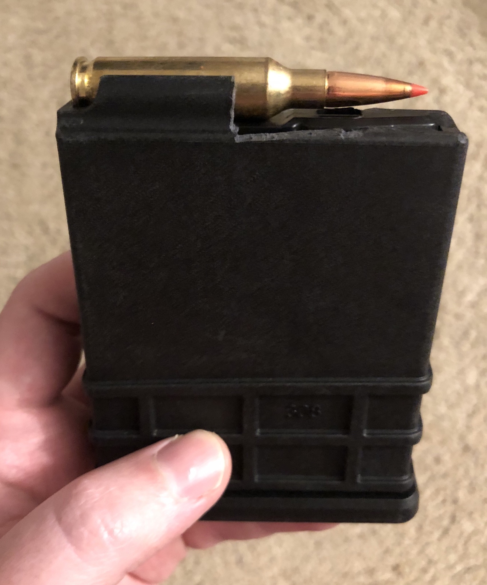

I did end up literally hacksawing one of my poly mags, image below.
  • It’s a bit harder to load; I tend to get the case head stuck on the (no longer smoothly tapered from the front) mag lips.
  • It is *much* easier to run the bolt, to the extent that I now notice the hang from the unmodified poly mags when the cartridge is at its maximum angle during feeding.
  • The controlled part of CRF seems slightly better in general, but doesn’t immediately engage on the final round.
  • I did a couple 3ft drop tests (aka bench) onto every face of the magazine and it didn’t lose any cartridges.
I’ll probably grab a bunch of metal mags soon enough; the better feeding feel alone is worth trimming the lips a bit, and though I’ve tested it I’d prefer the slightly more preload-adjustable metal lips for cartridge retention.
