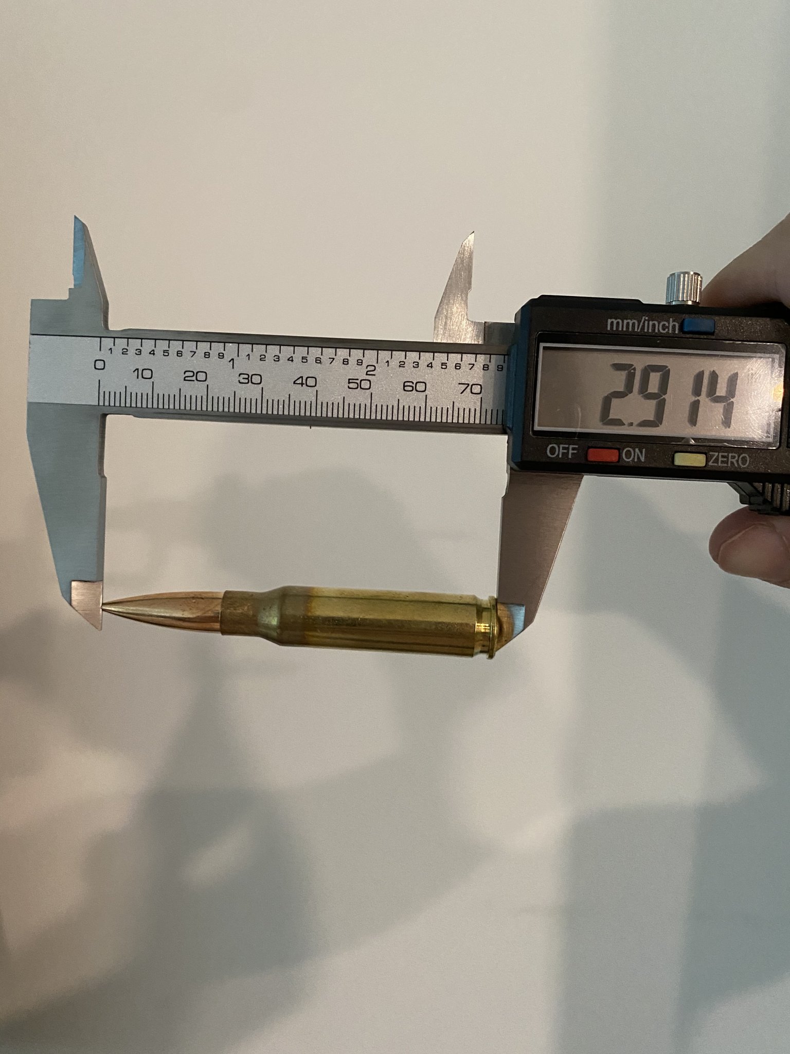

I’ve got to field a question to reloaders with a better depth of experience than mine
I ordered some .308 sight unseen (ammo game is cut throat, especially when you live in Oahu) and the vendor failed to mention the rounds are over SAAMI specified COAL (see attached image). They’re for a small frame AR10, so that’s a problem.
Calipers are telling me they’re 2.91 inches and I need to get them down to ~2.87 to fit in an SR-25 mag. Should I just toss them in the press and seat them a little deeper? Shaking the round produces a readily audible pepperbox sound so it seems like there’s room in the case - very scientific I know.
If the consensus is no, I guess I’ll just be doing surgery on all of them, NBD, but I’m low key stressing as these are potentially my elk hunting rounds and associated lead up practice rounds for all of 2021.
The only tricky part is getting consistent results from the same bump. It depends on the consistency of the ammo; neck tension, friction between bullet and neck, and seating depth,. The smaller the bump the more those other factors come into play. Not sure how important this is to you. For an AR this wouldn’t worry me even a little bit.
Reactions: camocorvette
What is this factory ammo?
To be cautious:
Single load and fire one for function. If it's close to the lands you may have pressure signs anyway.
Bump a couple back .02 then in .01 increments til you get where you want checking along the way.
Curious which "Factory" ammo this is. What is your bullet weight, make, etc?
I’d second some of the advice you’re seeing: if you can single-feed and get functional fires, bump the bullet deeper by 0.010” and try again. Keep going, watching closely for pressure signs. If you get to your goal without issues, great! If not, sorry boss. Maybe a mag that allows longer COAL in that case?
Identify the components. If the powder is known, then a better informed decision can be made. That said, what you got seems like something that might grenade your rifle. If I got fucked like that I would take it all apart and do over.
Have you made contact with the vendor and asked why they are selling 308 ammo that isn't to SAAMI specs?
SAAMI specs are voluntary, not mandatory.
2.91 will fit and work perfectly in Palma-chambered single-shot bolt action 308s. A potential elk-hunting round is probably going to have a heavier bullet that will function in an internal-magazine bolt action. Factory 700s generally have long throats, so a long-seated bullet will just be kissing the lands for best precision.
Back in the day match shooters would take M118LR and seat the bullet deeper to break the sealant bond between the bullet and neck. It was believed to give more consistent velocity. They would also make "mexican match" in 30-06 and 762 - pull the Ball bullet and stuff a Match King back in the case.
That said, you could count on what components went into those rounds and knew the deeper seating was not an issue pressure-wise.
I'd pull the bullet on one, see what you are dealing with as far as case fill/compressed load or not, and based on favorable results from that, go ahead and seat them a bit deeper.
I have shot more than a few Mexican Match rounds during my lifetime.

To be cautious:

It’s Winchester loaded with 155.5gr Bergers. It is 100% factory ammo purchased directly from Midway USA. I thought it looked a little out of spec / long when it arrived (visiting family in mainland because midway doesn’t ship to Oahu).

First off, do you actually have a problem to fix? Will the rounds chamber and extract? Yes; no first problem to fix.
No? shorten .002-.003 at a time and repeat test #1. When (if) it will chamber and extract, shake it to see if the powder is still relatively loose inside the case. No; go no further.
Get your courage on and fire one. If no mishap; examine the fired case for overpressure signs.
There could be some peril associated within this step, some sandbags over the action and a string for the trigger may be advisable, if you're that concerned. You can easily choose not to do this, so I will not assume any responsibility for mishaps.
This fired case inspection is a really important step, so get second opinion(s) from (an) experienced reloader(s). If they agree it's OK, shorten your rounds to that length (no other), and fire them.

Berger manual states 2.810 for COAL for 155.5gr.
The only Win powder they list is W748 with a MAX load of 45.8gr.
I really dont think seating them to mag length will case you an issue in regards to pressure. But in an abundance of caution I would seat them incrementally as I said above.

If they won't take them back, exchange, or ship to Hawaii I'd just seat them to magazine-length and shoot them.

I have Knights Armament mags and they will not accept 2.875” rounds, 2.850” yes but not much longer.

Seat them back to 2.810 - 2.830 and you've basically got 7.62 Ball with a good target bullet. Should work right through your Craddock and can.

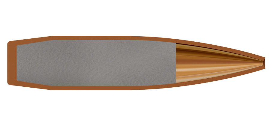

The Scenar is a tiny bit longer than a 175 MatchKing, about the same as a 165 Ballistic Tip. The front quarter is airspace under the ogive. If it holds together it should be a pretty wicked 800-yard (maybe better) load.

On longerangehunting.com a couple of guys are pushing the Lapua 155 Scenar to 3285 fps out of 300 Winchester Short Mags.
Seems consensus is the Scenar is a thicker jacket than the Berger hunting bullet.
