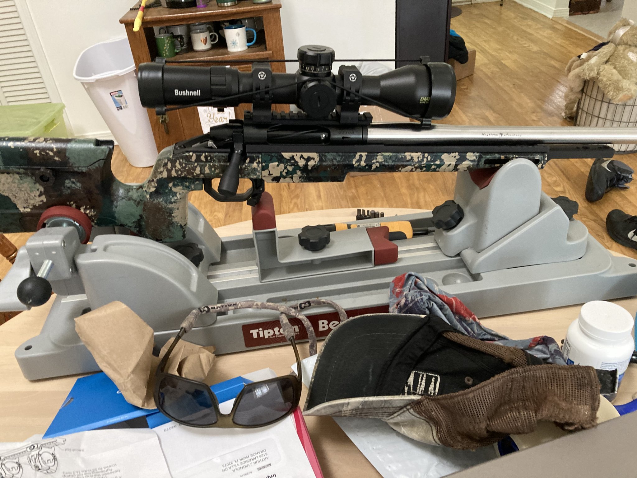

    I’m biased. I have an Origin in a Bravo and love it. I just about sold it here to get an AI, but i love the feel of it. Enough so, getting a second barrel/bolt head for it is in the cards. It was my budget build that got a little out of hand, but couldn’t be happier. I’ve had a TL3 before, but the Origin does everything it can do.
    Maybe grab an Origin BA from KeyStone, drop it into your chassis of choice with trigger, and get shooting? That’s the advice I was given by some of the gentlemen here.
