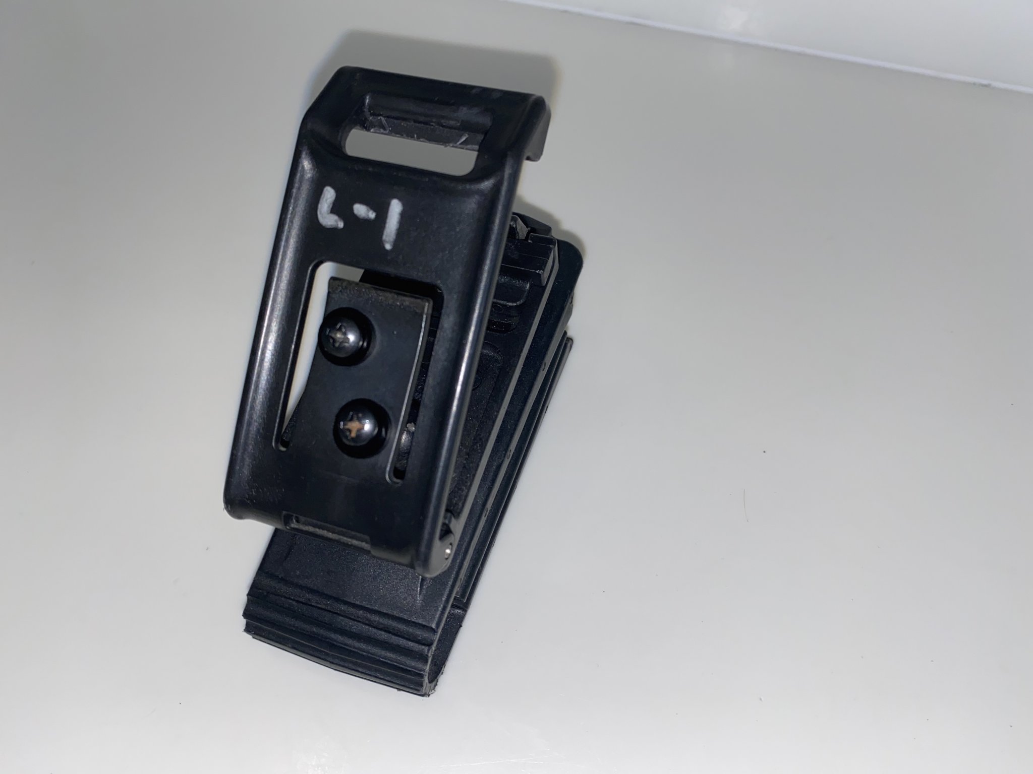

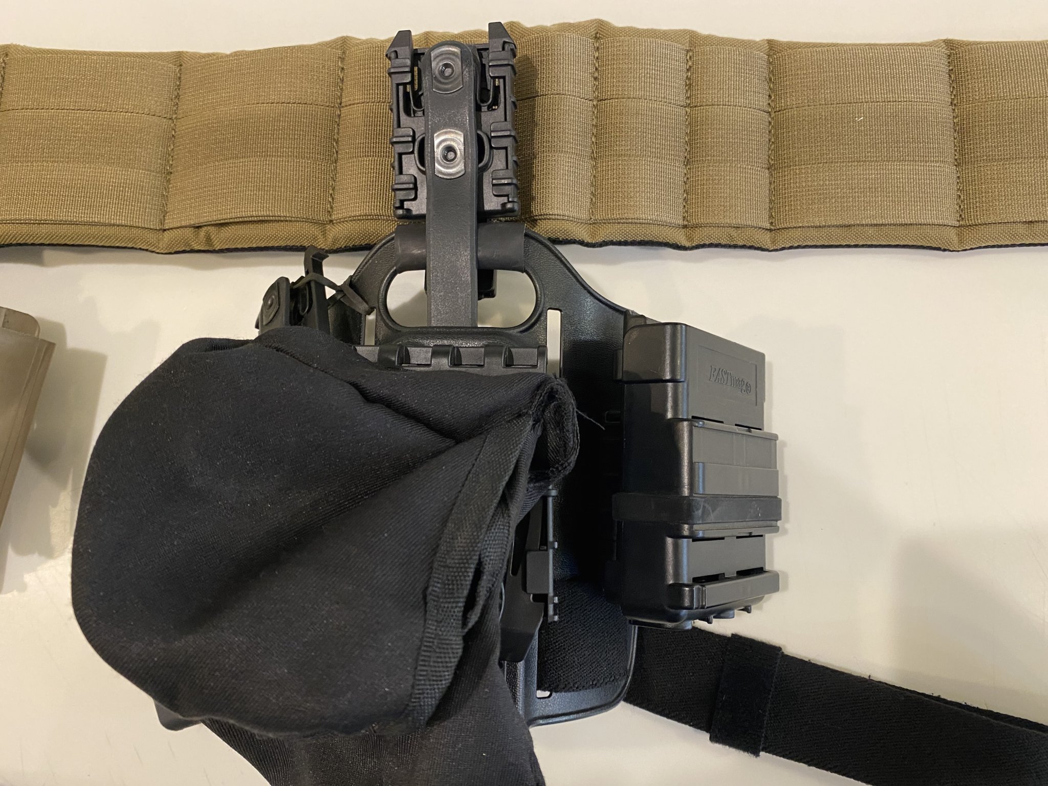

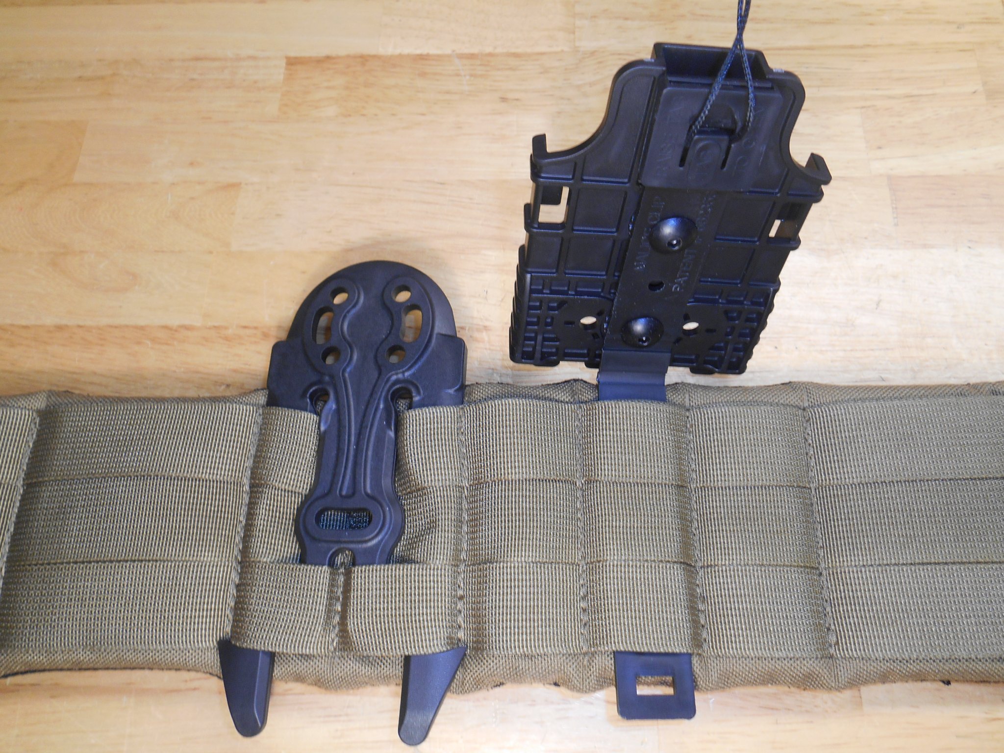

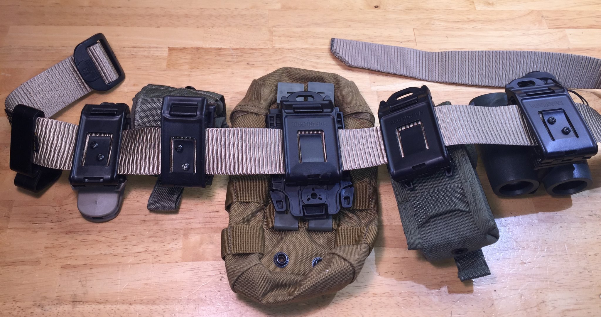

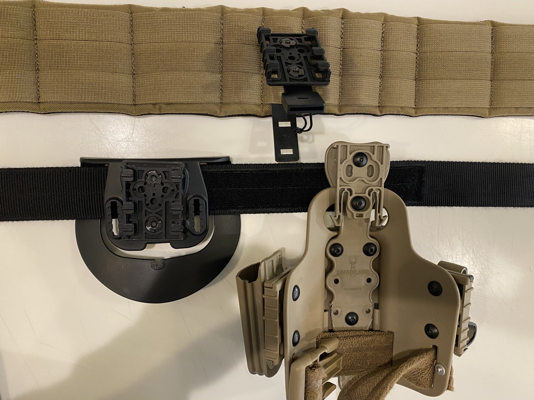

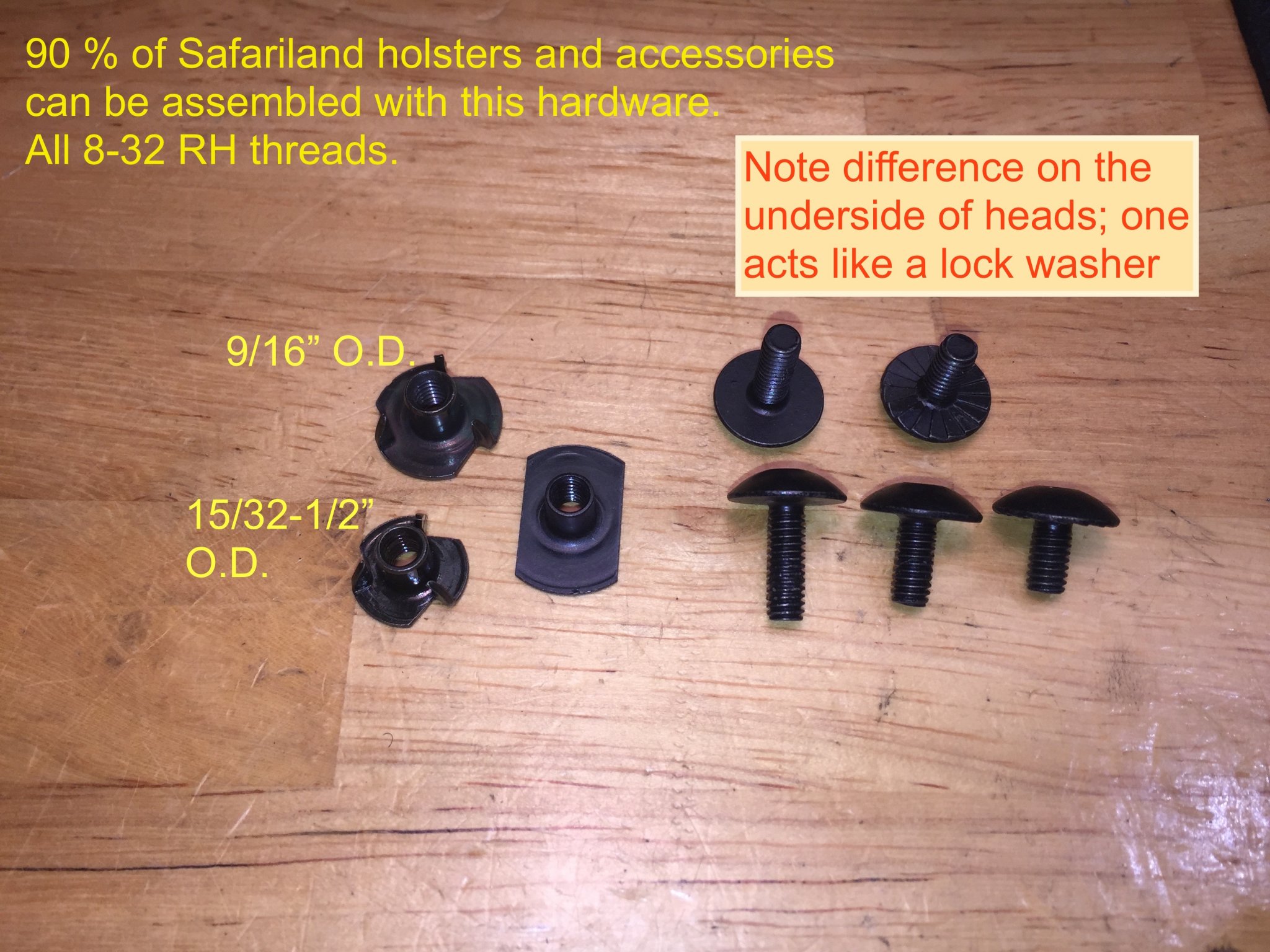

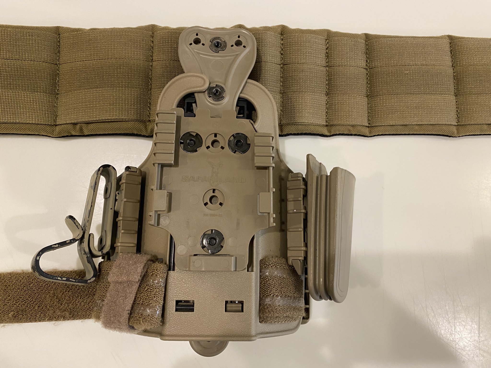

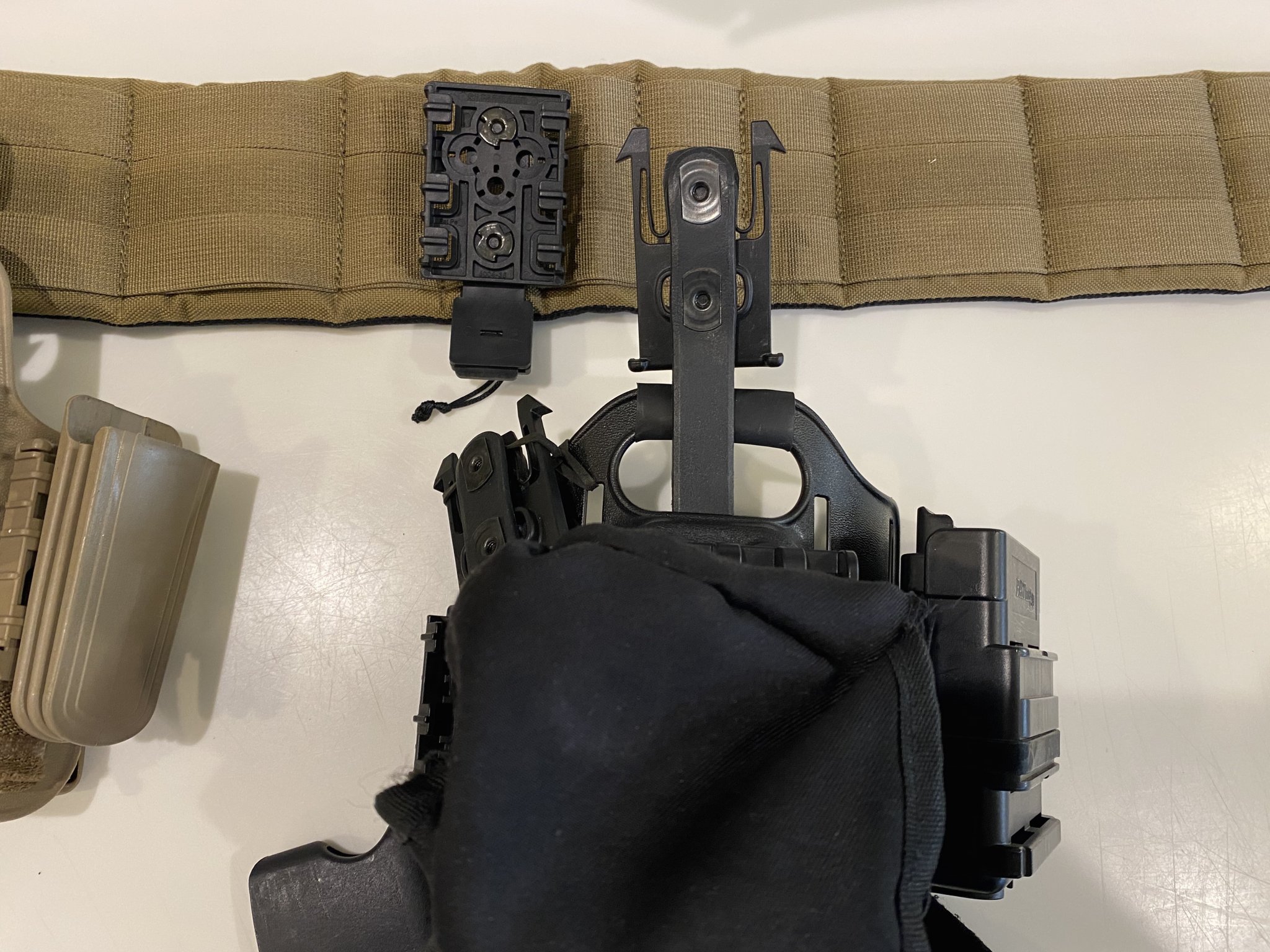

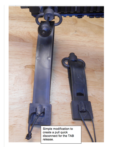

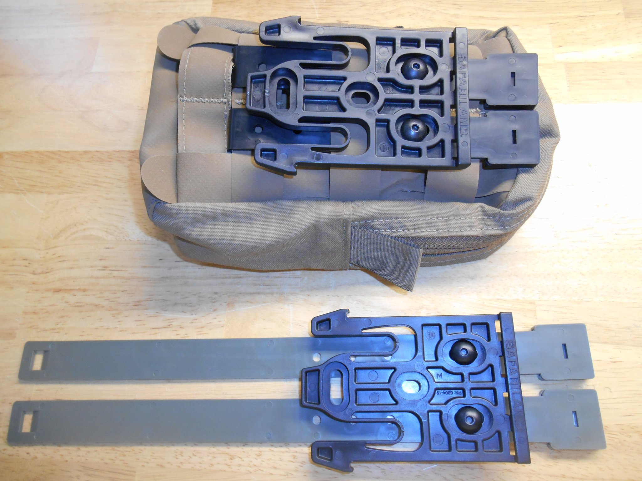

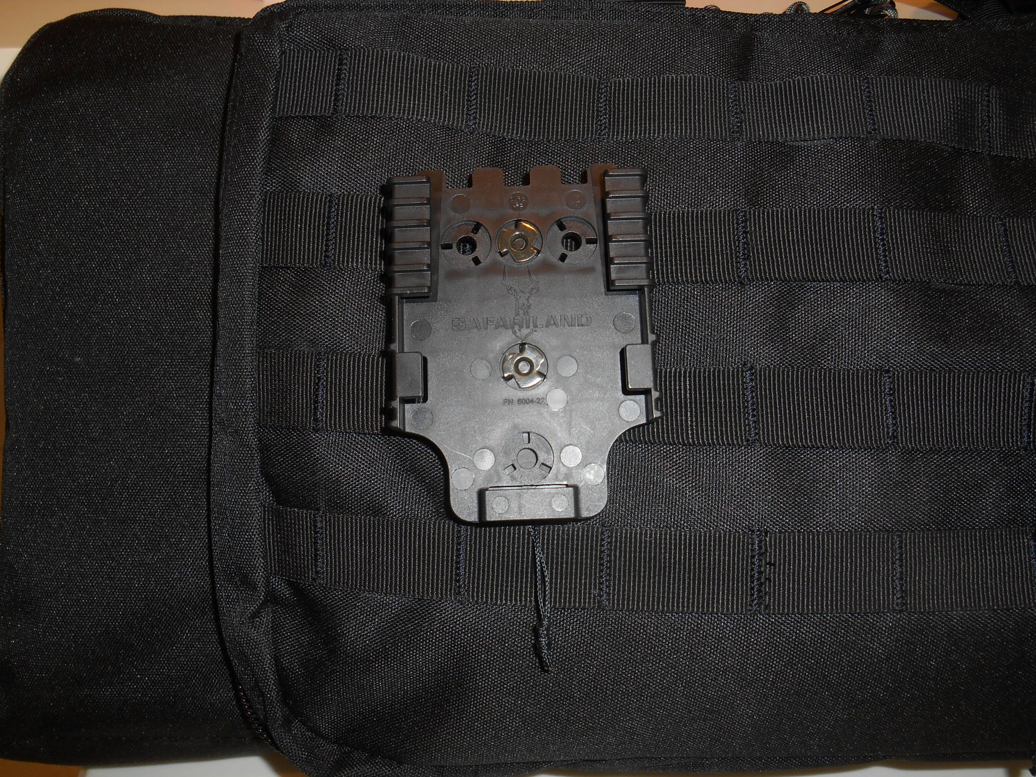

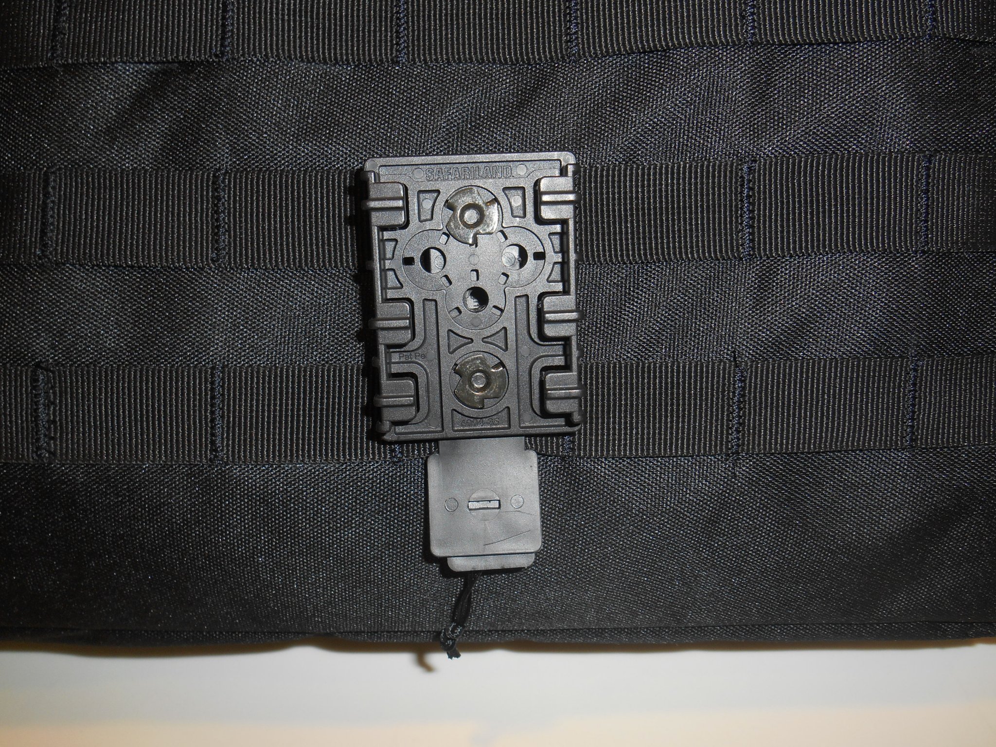

I have used these Malice Clips for lots of connections with MOLLE since the holes in the Clips match the hole pattern in most of the Safariland fittings. The clips come in 2-3 different lengths and I modified all mine with a small braided fishing line to make them Quick Disconnect kit, because otherwise the malice clips lock up solid and you need a fine screwdriver or knife tip to root around and release them....the QD adaptation is key. For your application I would suggest a one of the longer Malice clips, one end mounted to drop leg rig, the other end loops thru your belt then back to the rig to snap together.

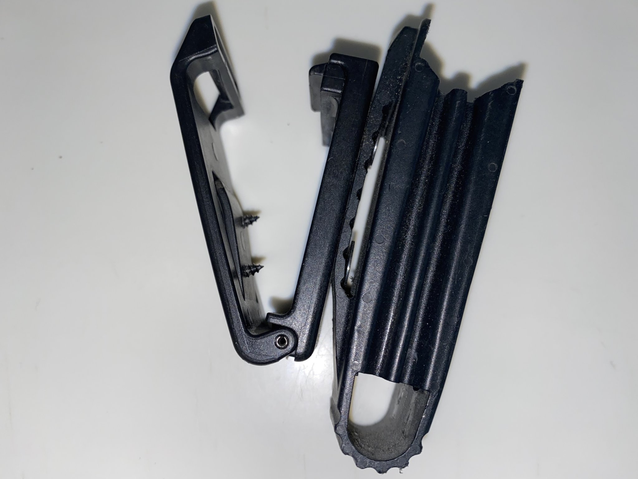

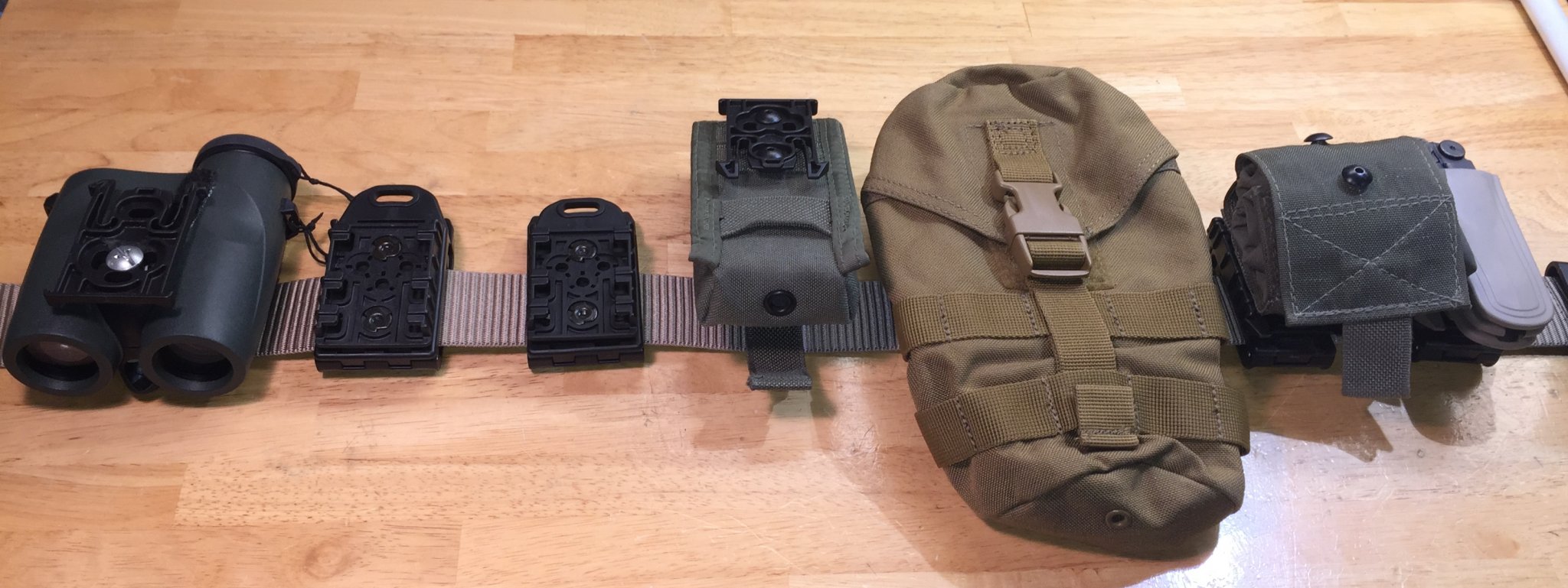

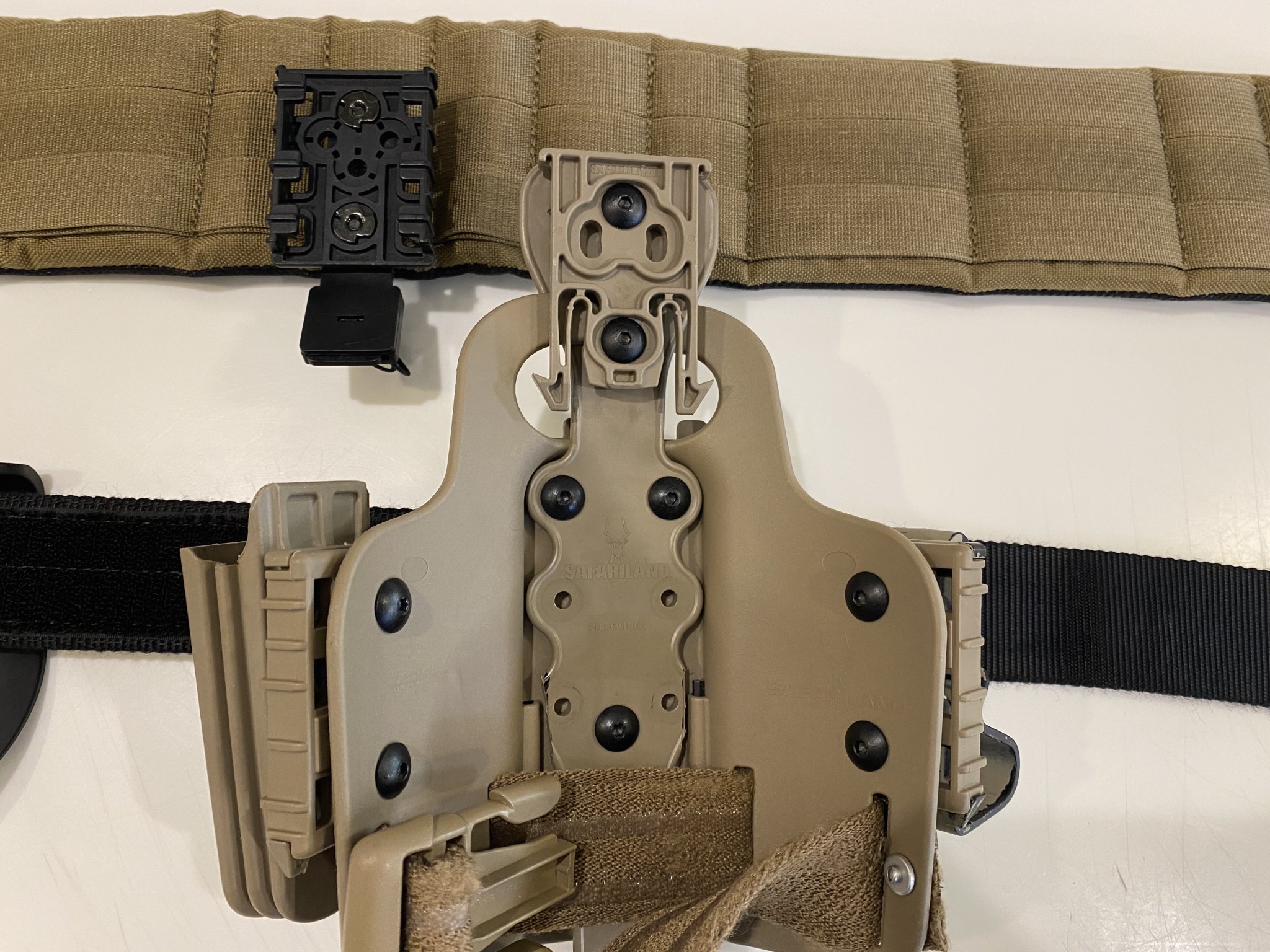

For your Molle belt a simple Safariland ELS / Malice clip setup will allow for QD of the drop leg rig from the Molle platform. A couple of different arrangements I use, although I have gotten away from Molle gear as I find it is to restrictive / cumbersome for quickly re-arranging kit on belts. I prefer having the male ELS clip oriented upward for insertion into the fixed female ELS component as it is easier to squeeze the male end and release it. On non-Molle training belts I use ELS clip on mounts modified with two screw tips exposed on the belt side to provide solid positioning lock up of kit on the belt .
