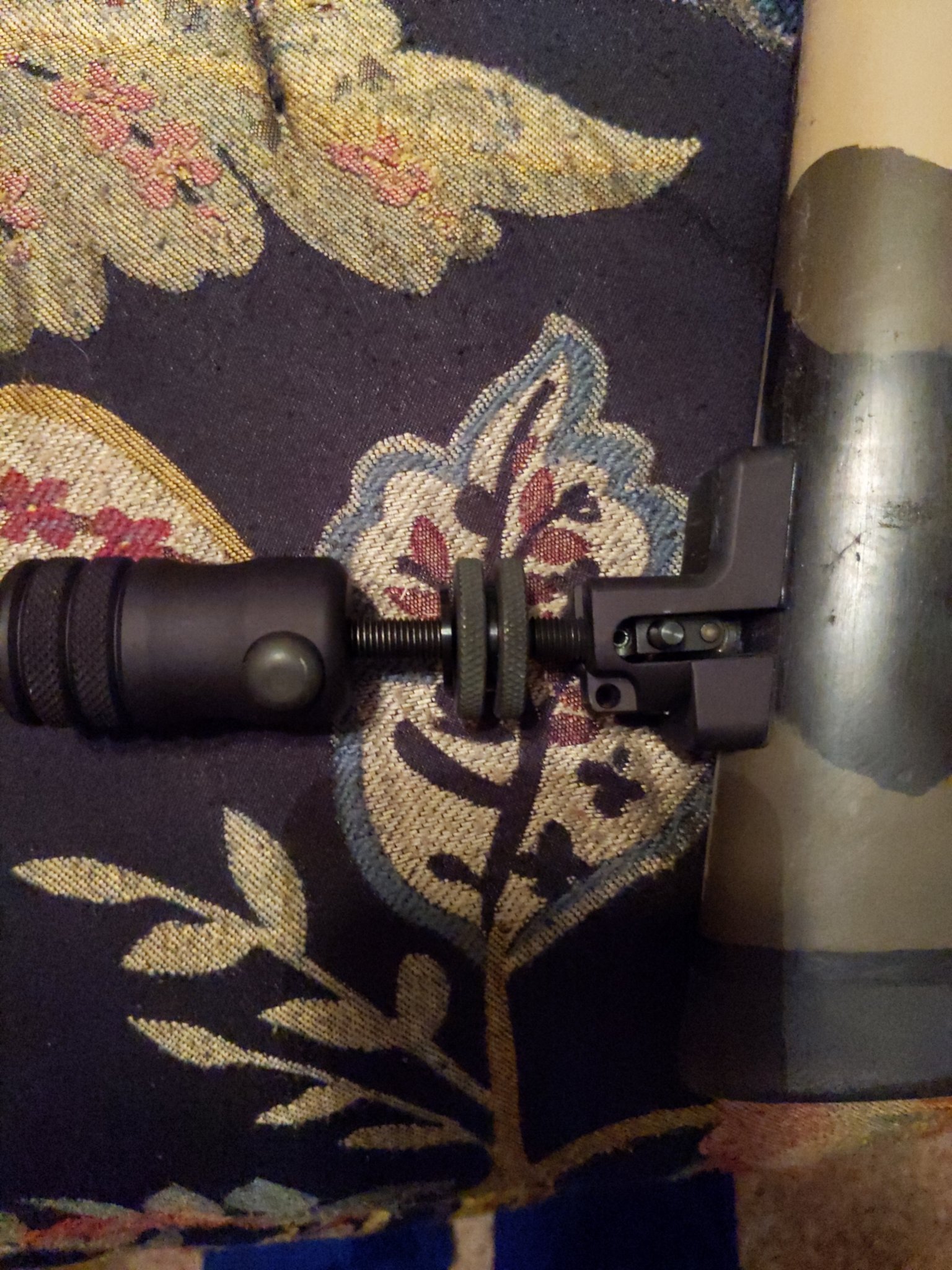

I probably use my accushot monopod mostly in the folded position. I have a Million A3 and the folded monopod gives it a hook like an A5. I shoot mostly with it up and use a rear bag. Kthomas is right. Monopods work best for long periods of observation.
They are slow to deploy. Have to unscrew. Fold down screw to tighten. The new accushots have a bottom to extend the monopod but you still have to unscrew the tightening to get it to fold down
Sorry the previous post should read.
You have to unscrew. The new Accushots have a button to extend but you still have to unscrew the tightening ring to fold down. My money was better spent on an Armageddon gear game changer.
