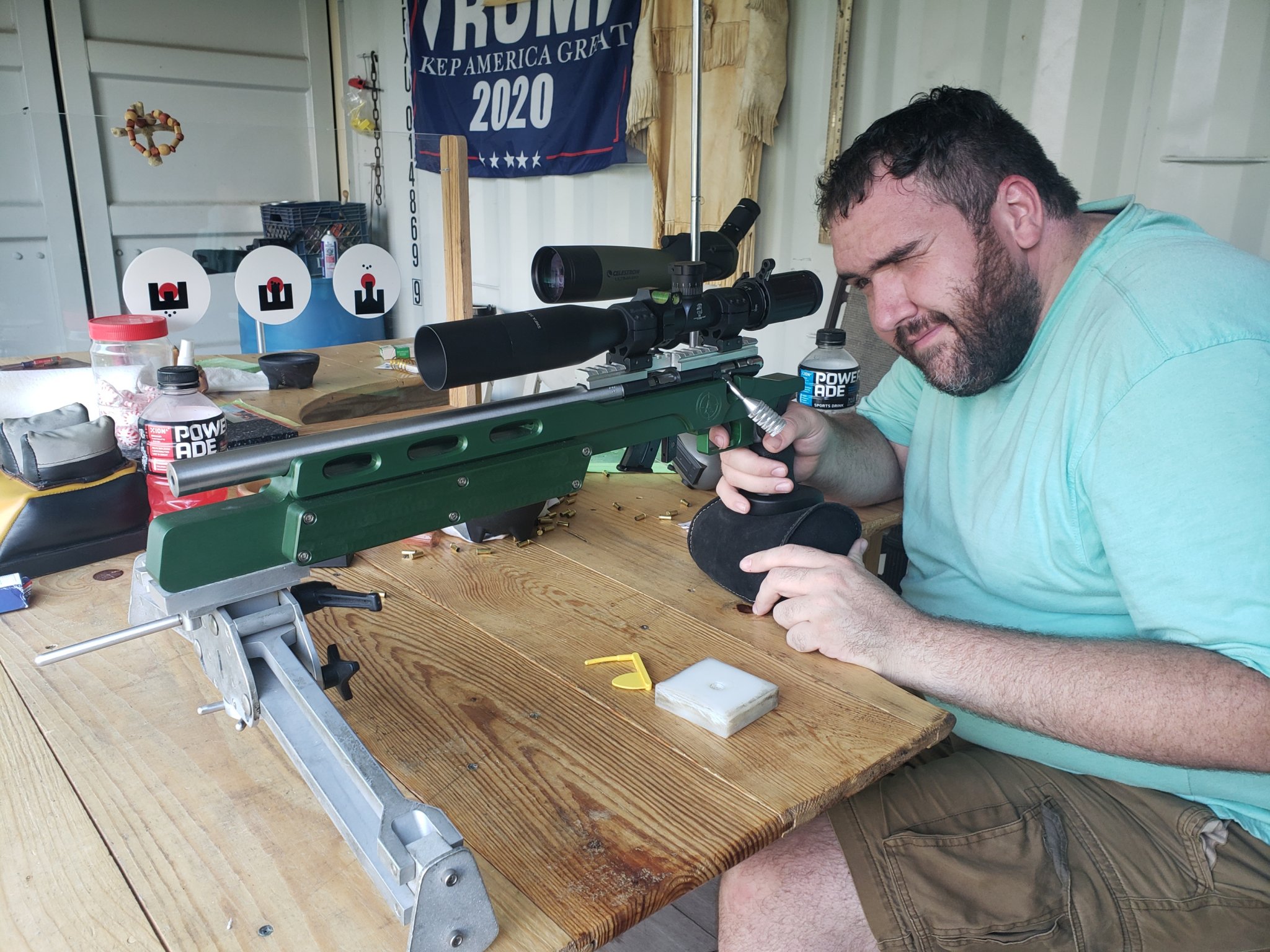

Only rimfire shooter here I've seen post one up, but is in a chassis with NV bridge:
