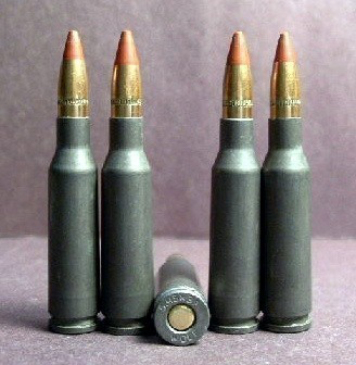

Check out this idiot on GB selling M856 tracer bullets wedged in a 5.45x39 case. I pointed this out to the seller and he continues to offer them. Why are people so damn dumb?

I know of a guy that makes those and swages the bullets first.

As does that guy...he only makes his living pretty much running his reloading company.

For everyone talking about this is dangerous in regards to the OP information really needs to CEASE shooting ALL jacketed projectiles immediately since they are ALL manufactured via the same swagging methods used by the business in the OP link.
Just because something is "new" to you or it is something that you might not understand fully...does not make it dangerous. Only dangerous to you.

Obviously this item would not be for sale if it's not commonly used. Not knowing should probably lead to questions about it's use.
So here's mine.
Looking at how far out of the case the crimp cannelur is. How much is in the case and is that case that full of powder?
