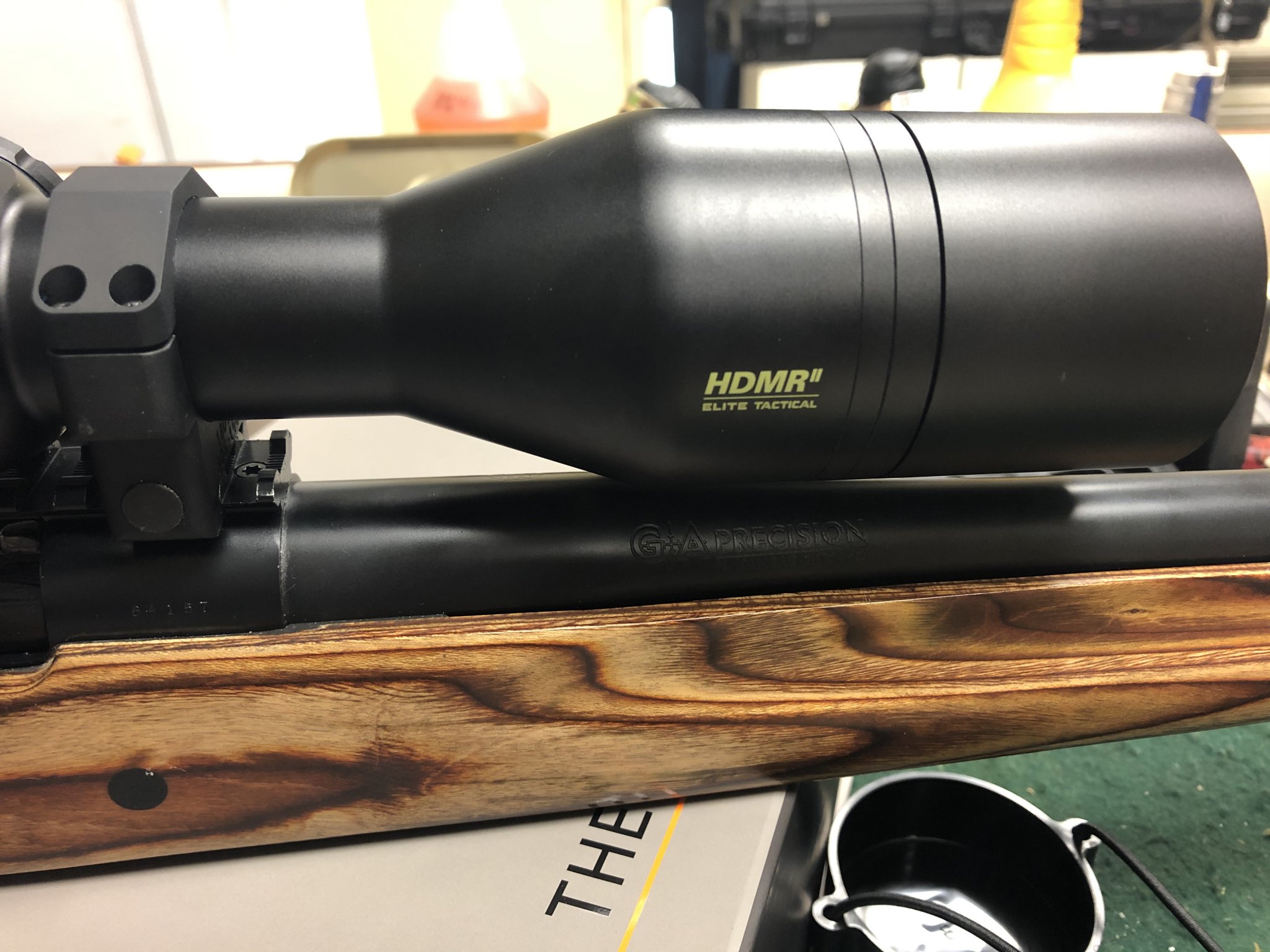

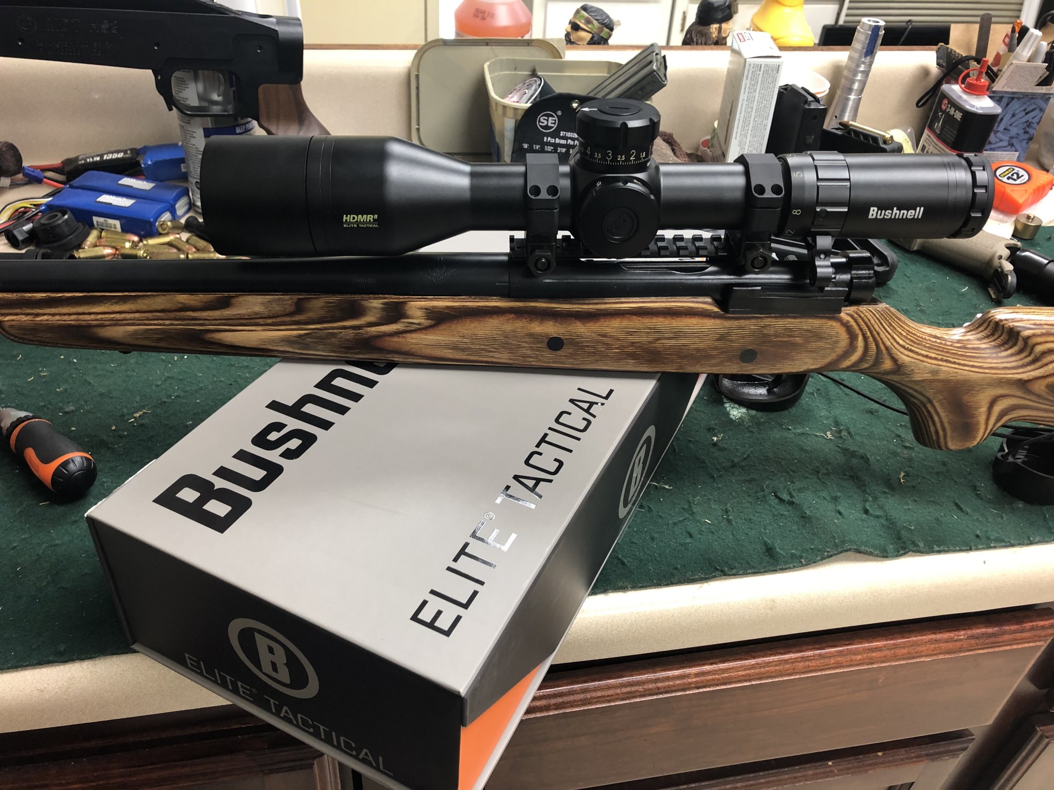

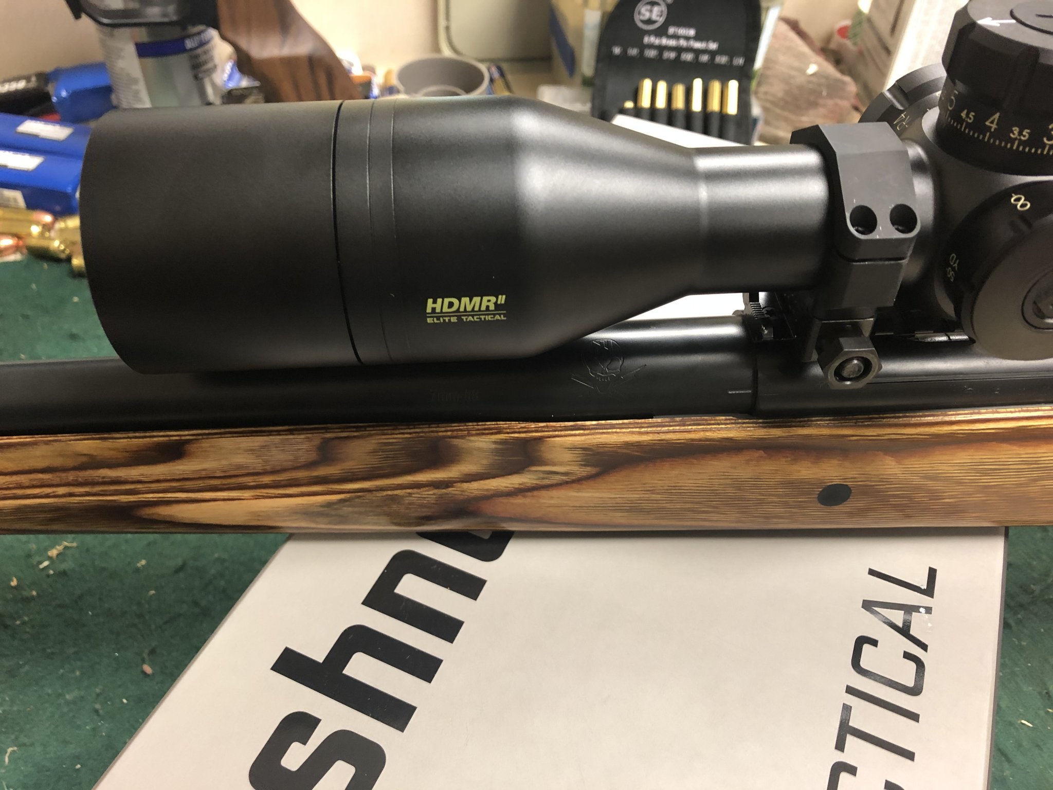

Got an old Jap Arisaka 7.7 that has been converted to 7mm08 and is pretty slick. 20 inch barrel iirc. Timney trigger, boyds laminate stock, vortex viper pst in some badger rings. Nice blued finish
Reactions: Mauser34

How do you like the Boyd’s stock?
Boyds stock is pretty nice. Choice was extremely limited due to being an Arisaka action. I have shot it a few times and it seems comfortable enough. I definitely haven’t given it the time it deserves though. Scope has been changed to a gen 2 viper pst since these photos
