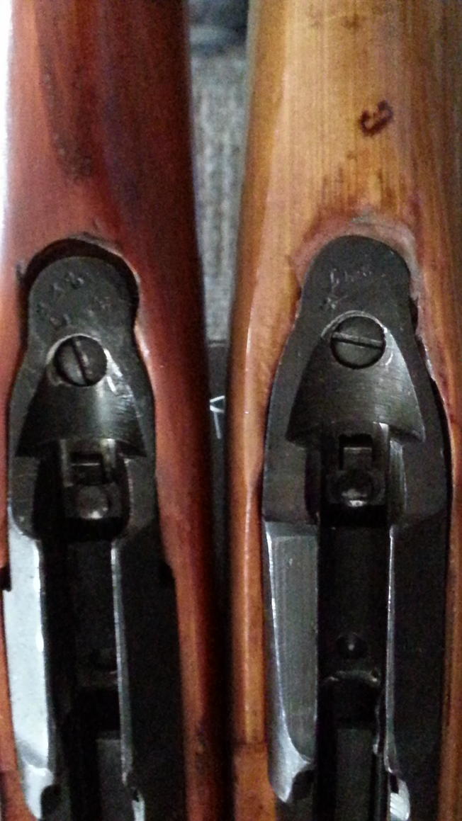

Anyone that advertises MN stocks as "drop-in fit" are lying, or their stocks are as loose as a two dollar ho. I make/sell stocks for the Mosin-Nagant- they must be left proud, particularly in the tang area.
This picture speaks for itself...
