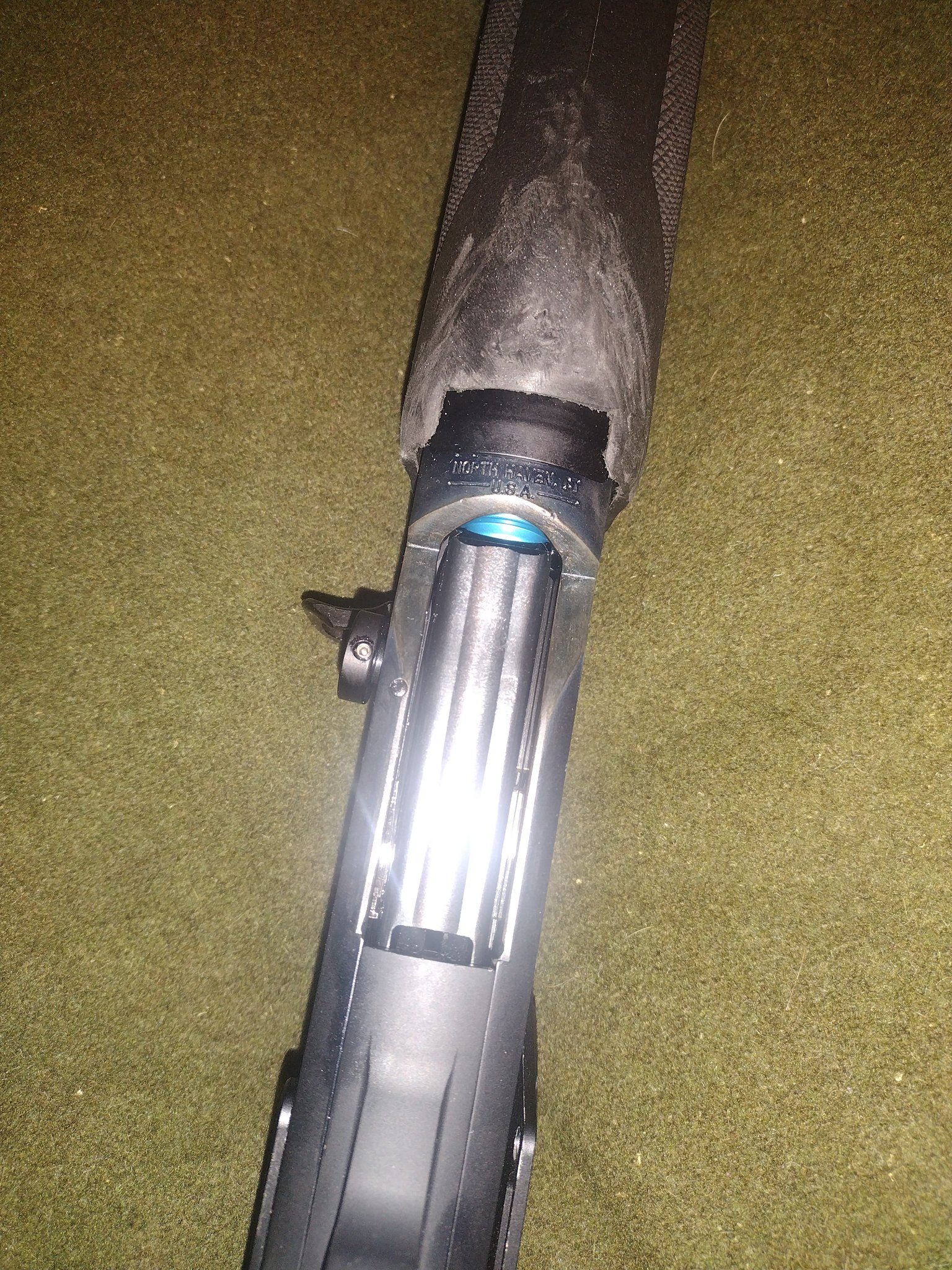

On the early 930s they were known to have a rough backside to the shell stop. Check the back of the shells for scratching. If your seeing any then polish the backside of the shell stop till nice and smooth. This can cause your issue as well, ask me how I know.

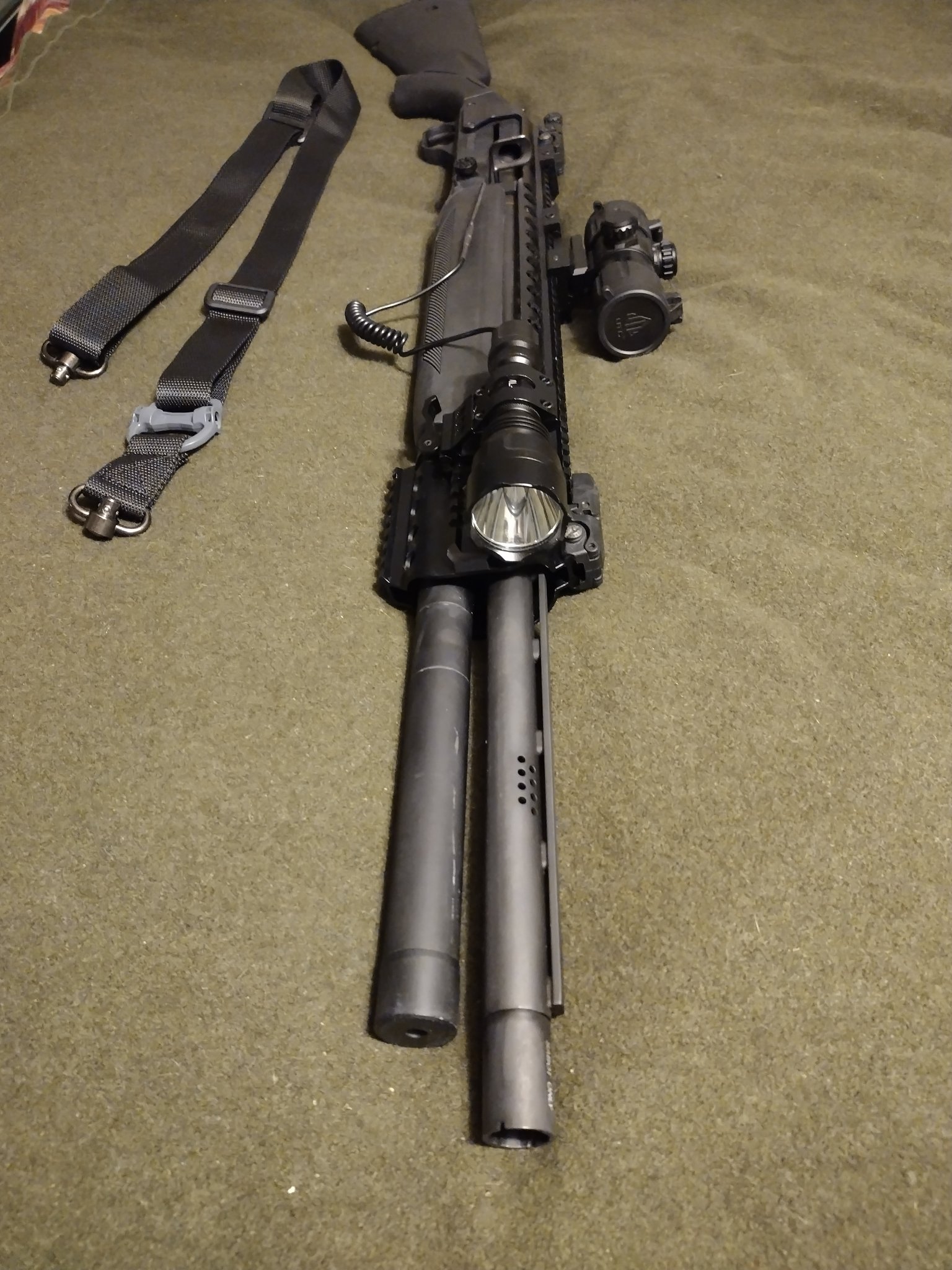

I've got mine out now, opening up the loading port, I plan on polishing it before it goes back in. I just got it a few weeks ago with 2 barrels and I've picked up 2 more 24" ported barrels, accu-choke & fully rifled. As well as +2 & +4 mag extensions. Any of y'all stretch your loading ports? I think I'm off to a good start, waiting on a lifter to test fit before deciding if I need more. Sorry to hijack, seemed like a good place to jump in...

My Miculek lifter came yesterday! I'll get it all cleaned out good, and polish the shell stop this evening for a test fit of everything!
I like it a lot! I think I'm even satisfied with the Birchwood Casey's aluminum black.
