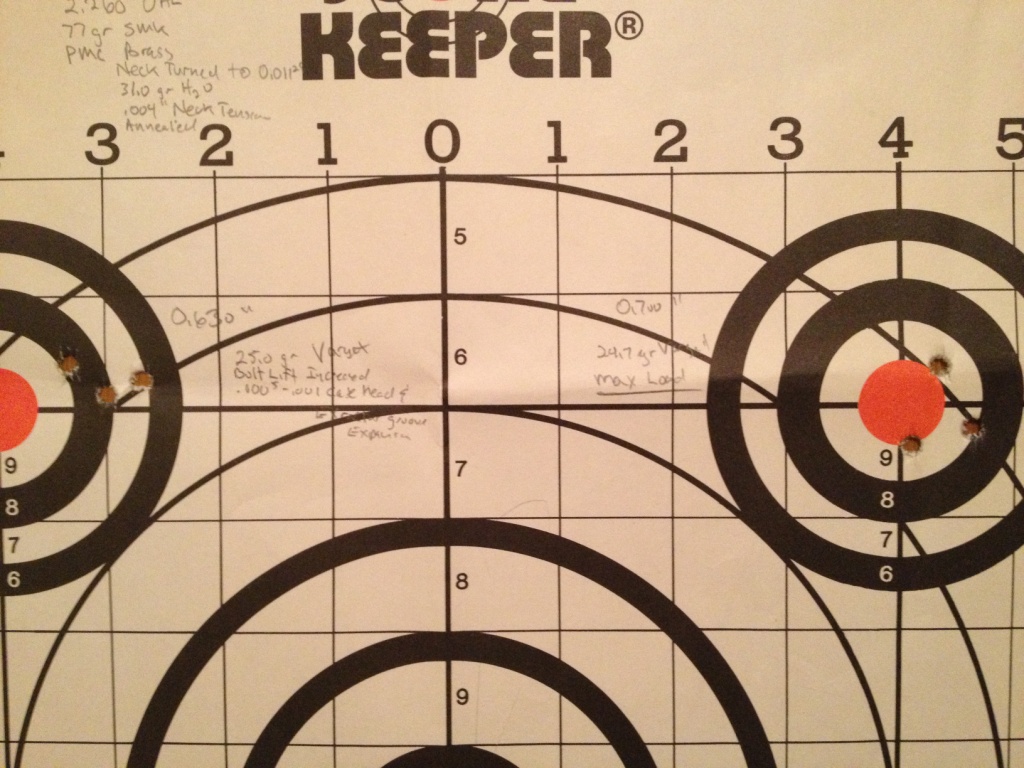

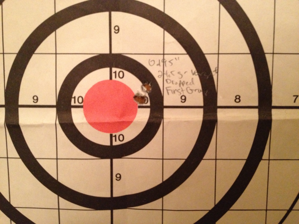

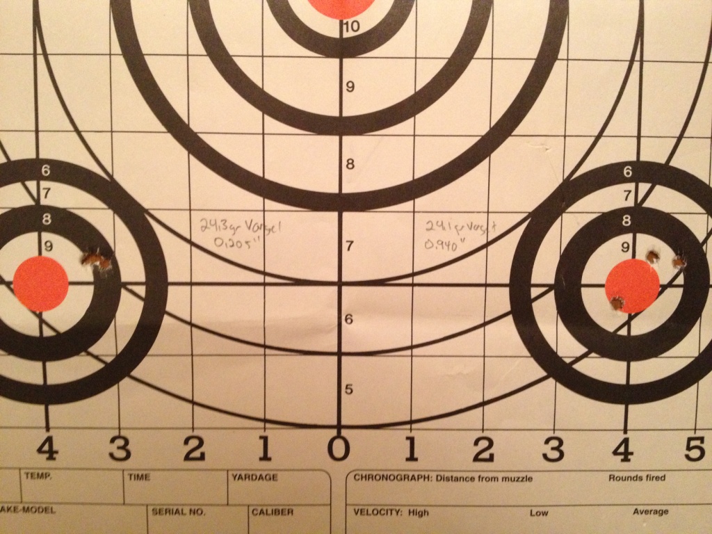

The laminated stock is pillar bedded and the plastic block that contains the magazine release components doubles as a bedding block with a couple rails down the side. It's a pretty clever system. I glass bedded the recoil lug and added an aluminum bushing to the plastic trigger guard so the action screws could be torqued. The 1:9 twist stabilizes just about anything that fits in an AR magazine. I'm running the 77 smk. The throat depth would make a Remington proud, it's 2.400" to the lands with that smk.
This is the 100 yard load workup. The barrel on mine takes a lot of cleaning and has a window of about 25 shots for groups like this.
