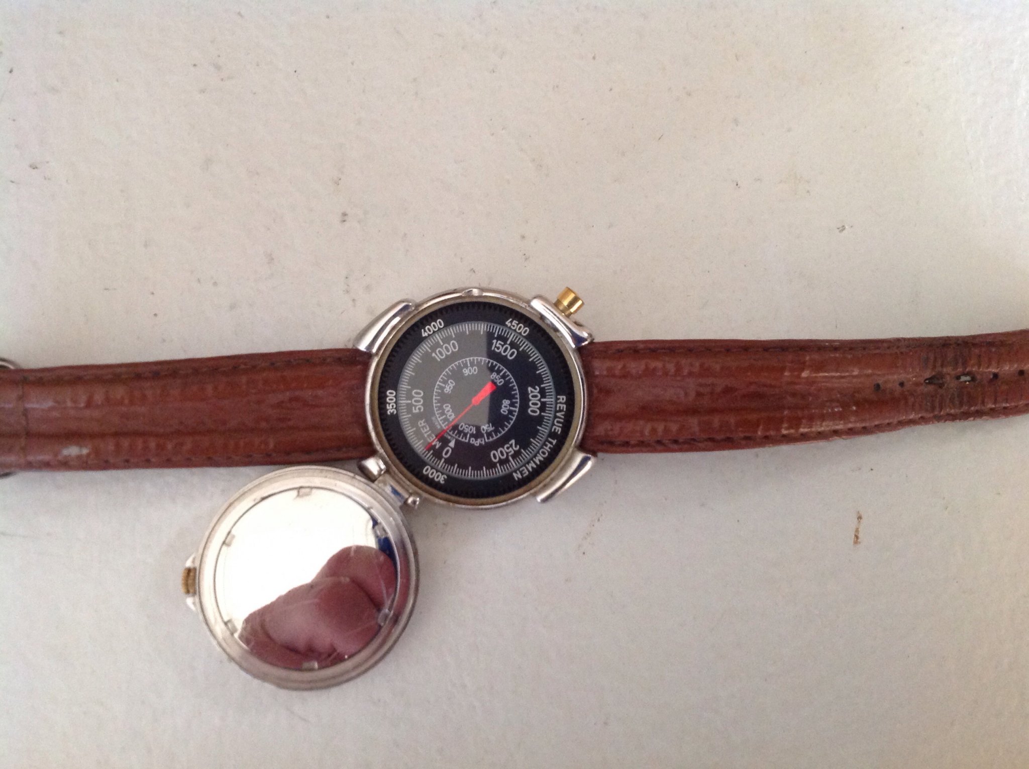

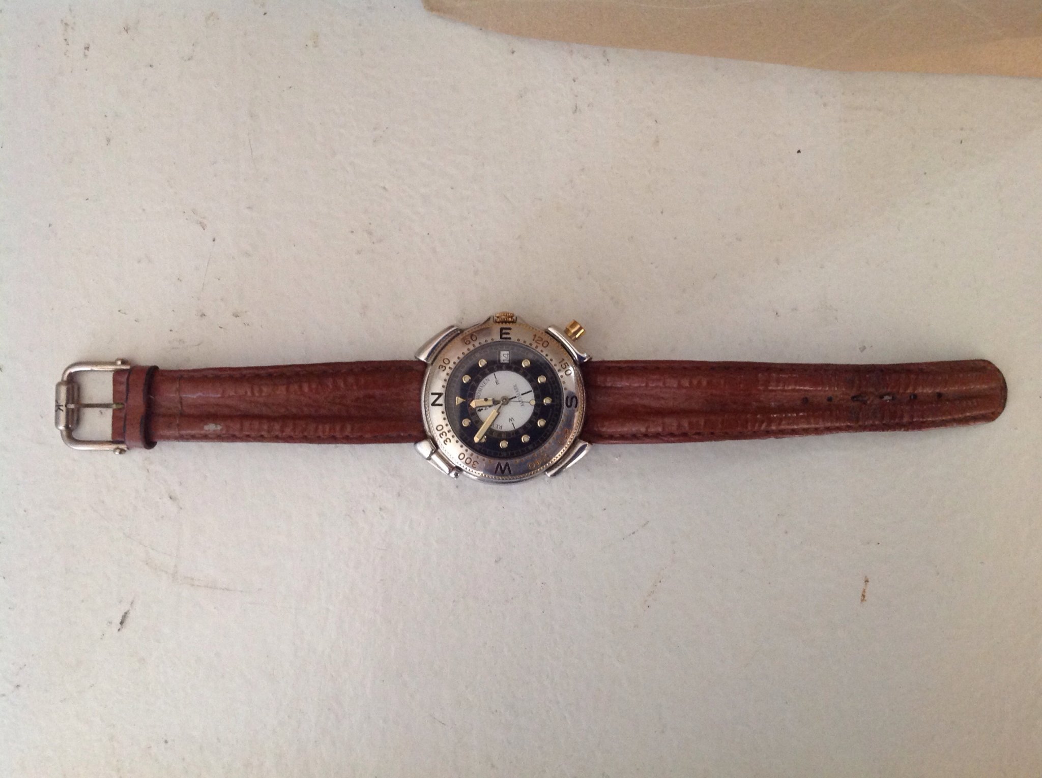

    R.ee9c3bcd31e5ac79b517dcc0fb8f7e21
    And one of these
    R.86fa8212f318d069d3ecd9cbb35ee72c
    So you can listen to the AWOS freq from airports near you for the QNH
    What you are asking is basically not possible. High and low pressure systems and even big changes in temperature (the heat low, for example) will cause your altimeter to be ”off” without a way to constantly reset it to a known altitude.…either by being at a known location on the map and setting the altitude or by calling the local airport and getting the local altimeter setting (depending on what kind of “setting” capability your equipment has…a kollsman window or the digital equivalent).
    What you have done in the past is about as good as it gets for pressure based altimetry.

    Most accurate....probably not.
    Revue Thommen Altimark from 1988.
    Shitty crystal movement but the altimeter was cool tech for its day.
    I used it with topo maps hiking the Jura where France an de Switzerland put an altitude on everything that is of importance.
