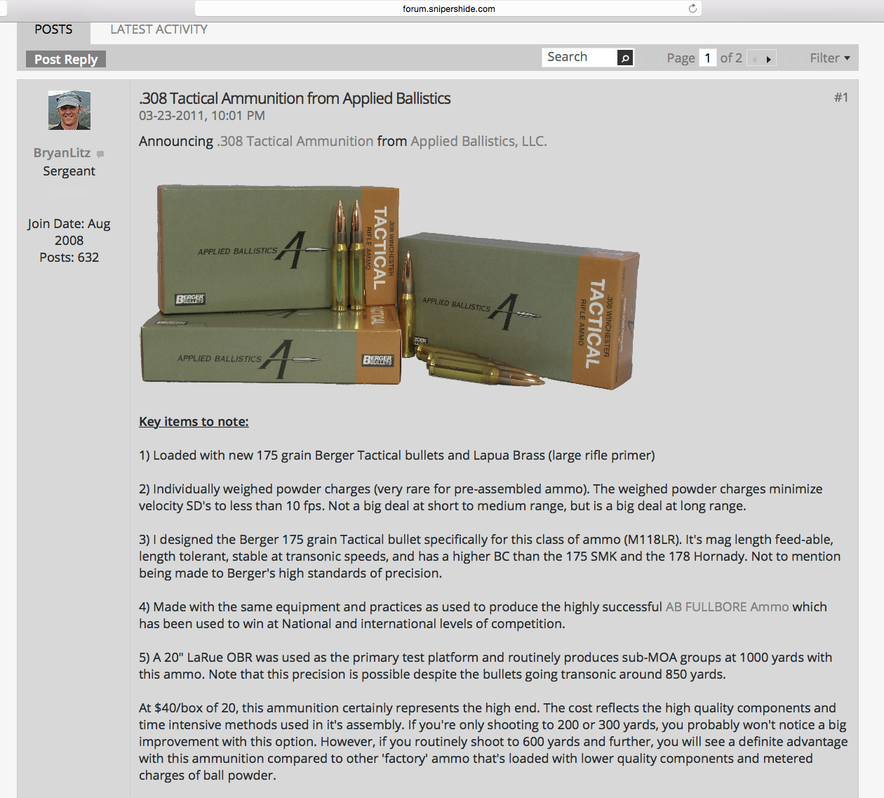

Prime 308 175's worked pretty well for my LMT.
