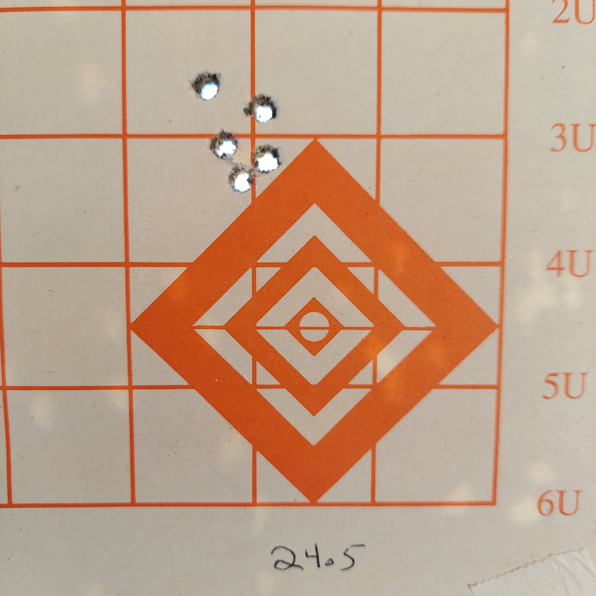

Here are 2 groups I shot with my WOA 18" SPR barrel while doing some load development. I didn't use anything special really. 1x fired PMC brass, Unis primer, 69gr RMR bullets, and 24.5 gr of Varget. Both groups are right at .75" at 100 yards.
