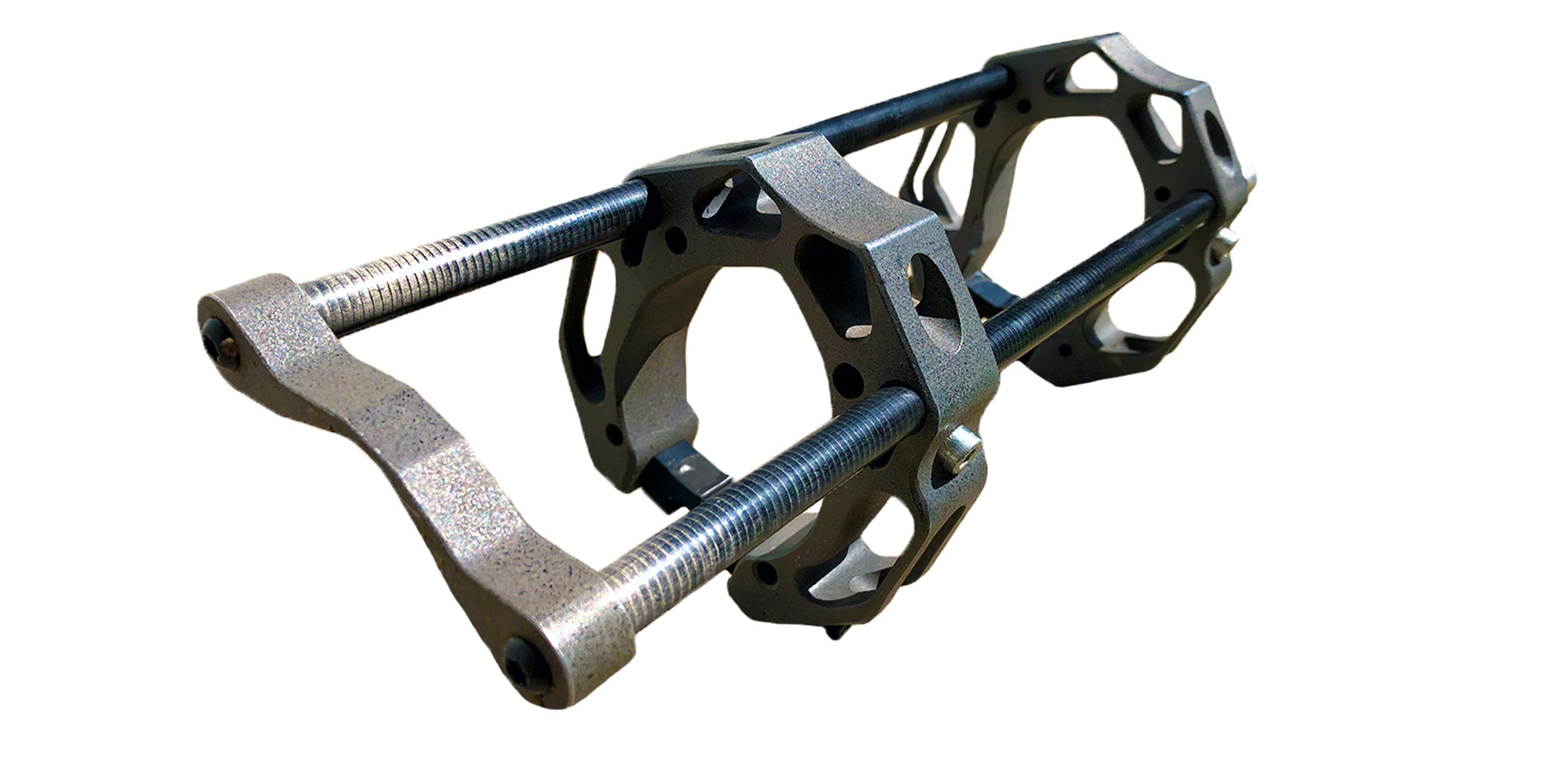

The optics companies I’ve talked with said in order to make a durable variable power scope for use on gas guns, they had to use epoxy to set the lenses and optics modules in-position in the tubes and inner tube, otherwise they come loose under fire and reciprocating mass impacts that shock the scope in both directions. I think Vortex even developed their own CNC machine to do the epoxy application for their lenses and modules to ensure uniform application of the bonding compound, which used to be hand-applied over 10 years ago.
Tom Beckstrand wrote an excellent article on this after visiting as many scope manufacturers as he could and getting access to their engineers to discuss why they did things the way they did. He covered fast vs slow scopes, SFP and FFP internals, different company engineering philosophies, optical element materials, grinding, coatings, polishing, lens count, erectors, magnification mechanics, Side Focus vs front focus, diopter adjustment, elevation and windage mechanics, springs, reticles, knobs, etc.
iu
NightForce and Vortex (higher end lines) seemed to address those semi auto durability issues the best at the time, especially if you wanted to run an AR-10 or SCAR.
One of the other shooting communities who saw this problem early-on were the .50 BMG shooters who shot their Barretts a lot. They broke a lot of scopes until they started using NightForce.
I know NF also uses Titanium leaf springs in their erectors that are heat-treated into the bent position, then compressed for a month, then allowed to go back into position. If they don’t return to heat-treated position, they are rejected and don’t go into the scope.
