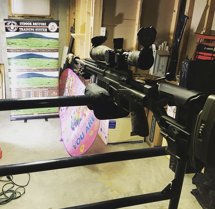

    This was a game changer for me ! Dry fire practice that’s as realistic as it gets
