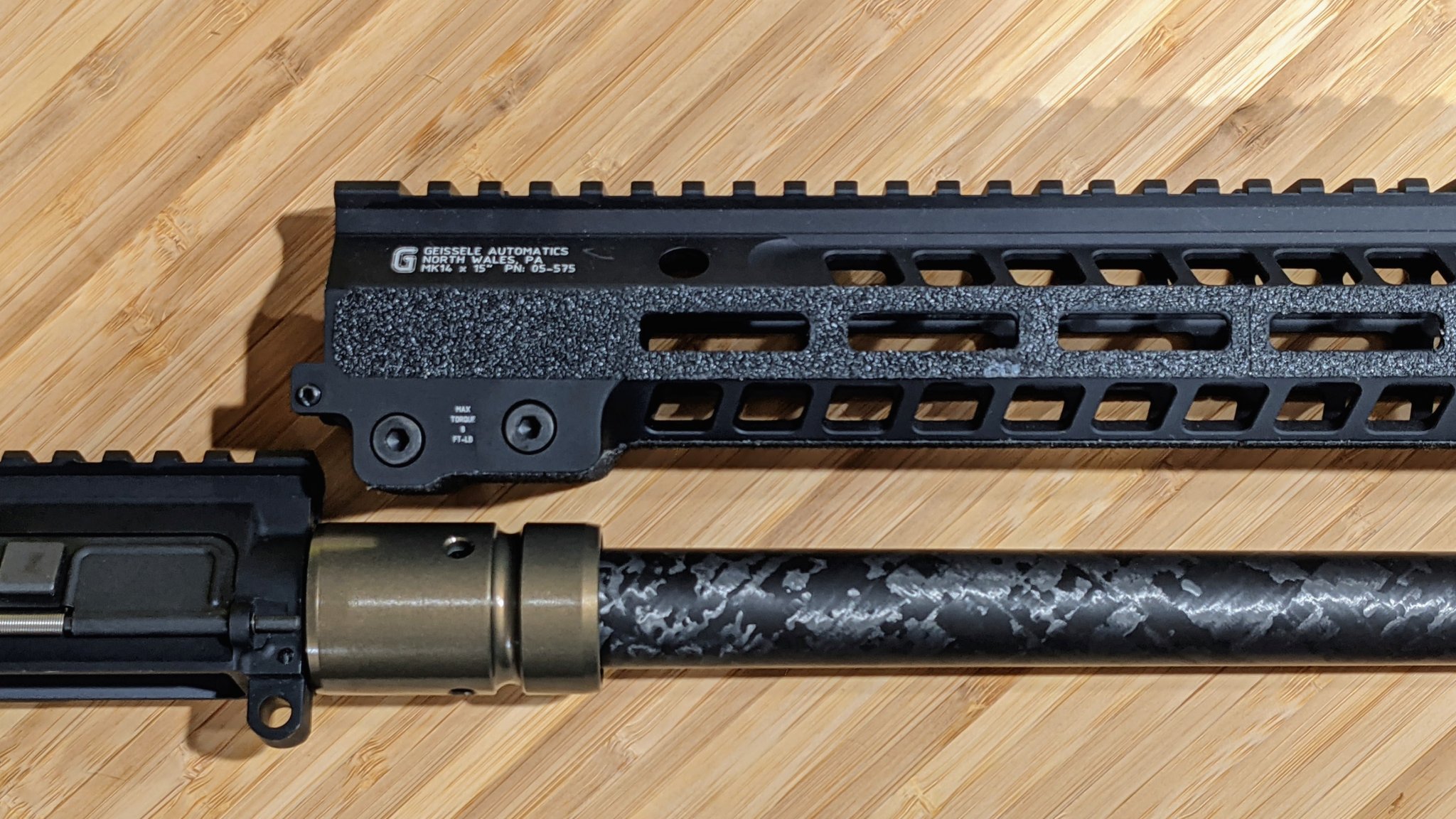

Bumping this thread. for newer info.
Looking for the most rigid handguard for an SPR-ish type build.
Must be M-lok and not a monolithic type.
Not looking for the PRI type handguard either.
I am partial to BCM handguards and have a Giselle Mk16 laying around but looking to see if there is currently anything better.
(Had a few too many whiskies and ordered another barrel)
