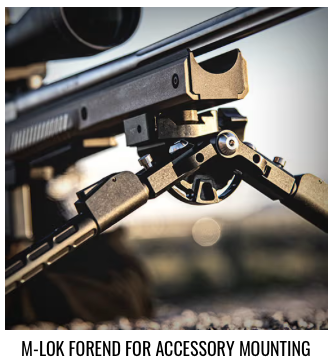

Sorry for the noob q, tried a search.
Just put together a rifle using the MDT Oryx and looking to mount a bipod. There is a hole where it looks like you can install a sling stud, and then a bipod but with the flat forend of the Oryx would a normal bipod mount up flush and right?
Just install the stud and gtg?
Would a different mounting system/bipod be better?
Thanks, Matt.
The MDT Oryx has a M-LOK forend. Just get the correct M-LOK rail, either Picatinny or ARCA...
Reactions: AleksanderSuave
Ditch the sling swivel entirely, its a half-assed mounting method and the least reliable. Sling swivel mounts basically exist because older hunting rifles had no rails, and newer cheaper hunting stocks are commonly hollow, so adding (and bedding) a rail isn't a great solution either.
Grab a picatinny or arca rail section with mlok mounts, and use it to mount whatever bipod you want after.
Reactions: MDT_Josh
