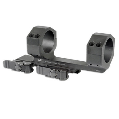

I have a Midwest Industries QD mount. It holds zero fairly well and it doesn't have the vertical split rings like Larue and ADM. They are around $180 or so. Also have a Geissele and a Badger on 2 other rifles but they do have the nuts sticking out.
