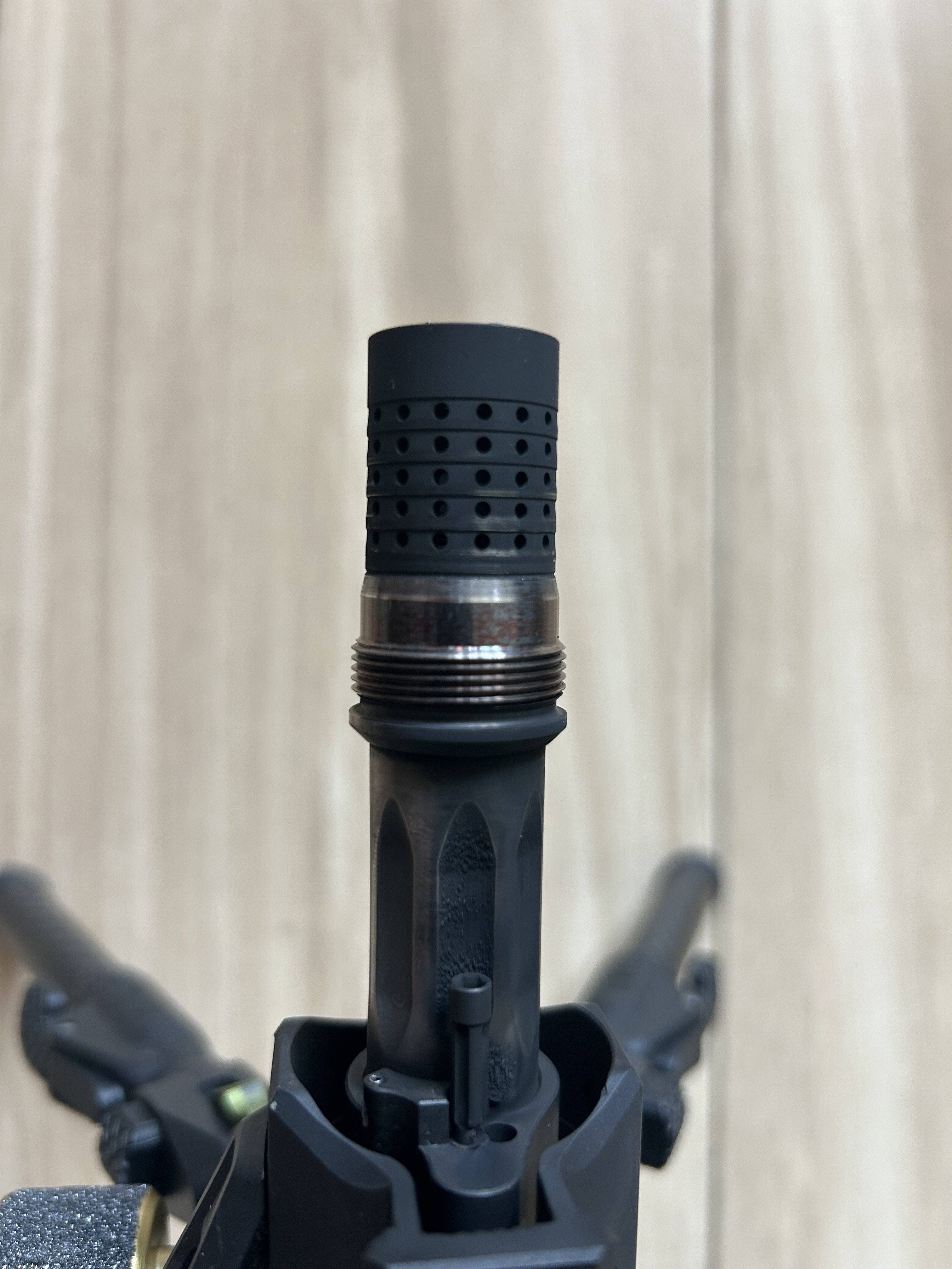

    I went with Rearden (plan B) mounts, after using the YHM phantom mounts for a bit.
    If you get a phantom adapter and mount that interface well, it’s a great system, but it’s luck of the draw whether or not the mount and adapter snug up perfectly, or between teeth. YHM says that a small amount of rattle (off by 1/2 tooth) doesn’t affect anything, but it does affect my confidence in the system. If I had stopped at 1 can and 1 rifle, the phantom system would have been great, as the first pair interfaced perfectly. After that however, it was always a game of musical chairs to get an adapter to work well with the mount on whatever rifle I was taking out.
    The Plan B system is super simple, and the taper in front of the threads keeps them from carbon locking. You can, I have heard, shoot enough to build up enough carbon in front of the taper to lock up the interface, but I haven’t experienced that, yet.
    The brake below is a Q Cherry Bomb (plan B system) and you can clearly see how well the taper seals off the threads from the carbon…

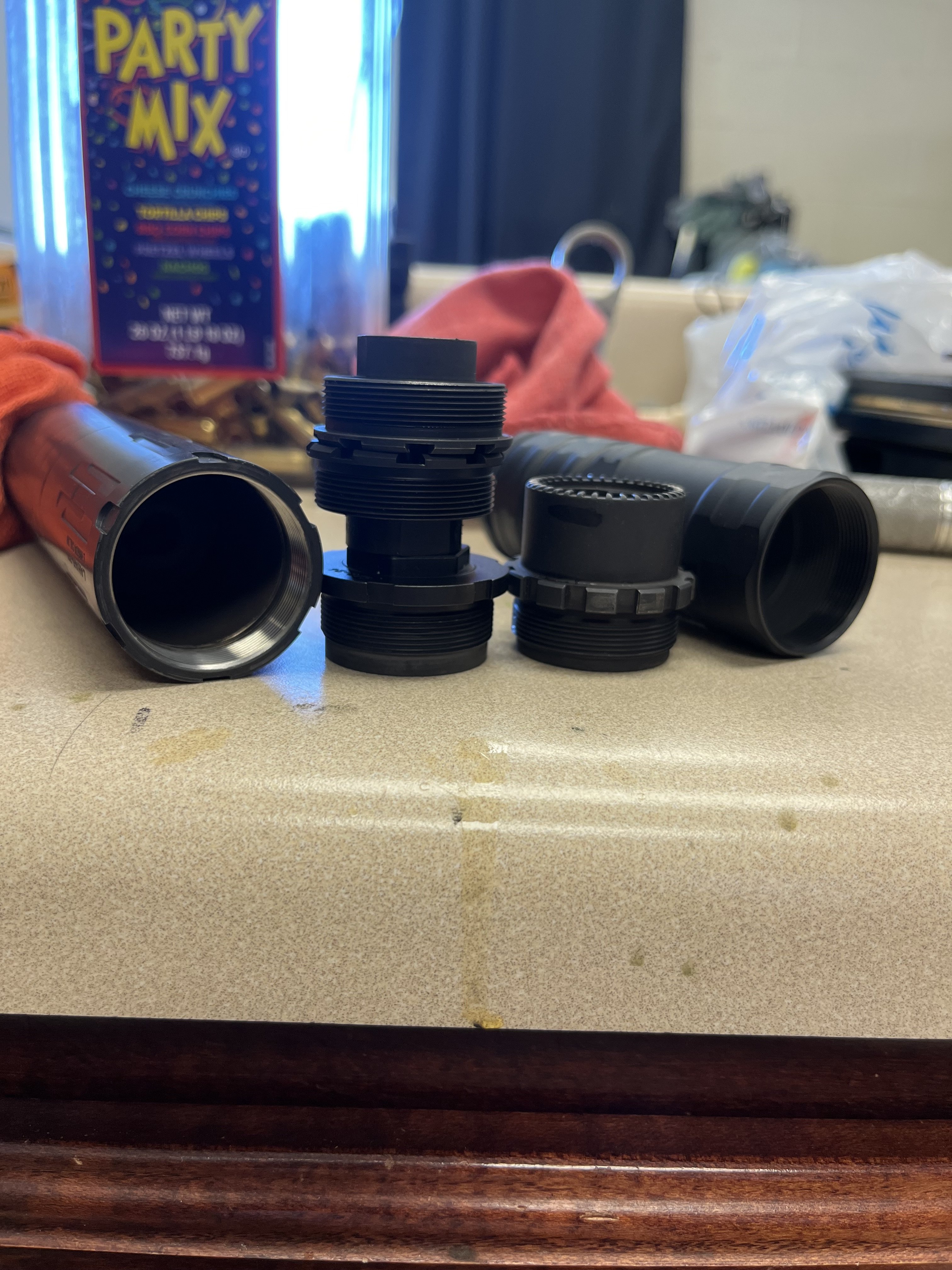

    I have both direct thread and hub-mount.
    My direct threaded suppressors are:
    1) Q Porq Chop for my 8.6 Blackout SBR.
    2) Rugged Obsidian 9 for my 9mm M17
    My hub-mount suppressor is:
    Otter Creek Labs - Hydrogen L 7.62 for my 300 Blackout SBR
    If I had my druthers, I don't really know if I could pick direct thread or hub mount for all my suppressors. I believe that each rifle has its' use-case and that is the primary component of how I chose each suppressor.
    For ease of use, I do like the hub-mount in my Hydrogen L...but install / removal for my direct threads are not really difficult.
    Both of my SBRs are backpack guns (Vertx Gammut backpack), so the suppressors are not attached full-time...but I do ONLY shoot them suppressed, so there is a short timeline to install the suppressor. The hub-mount having the lock-ring is a nice feature to have IMO.
