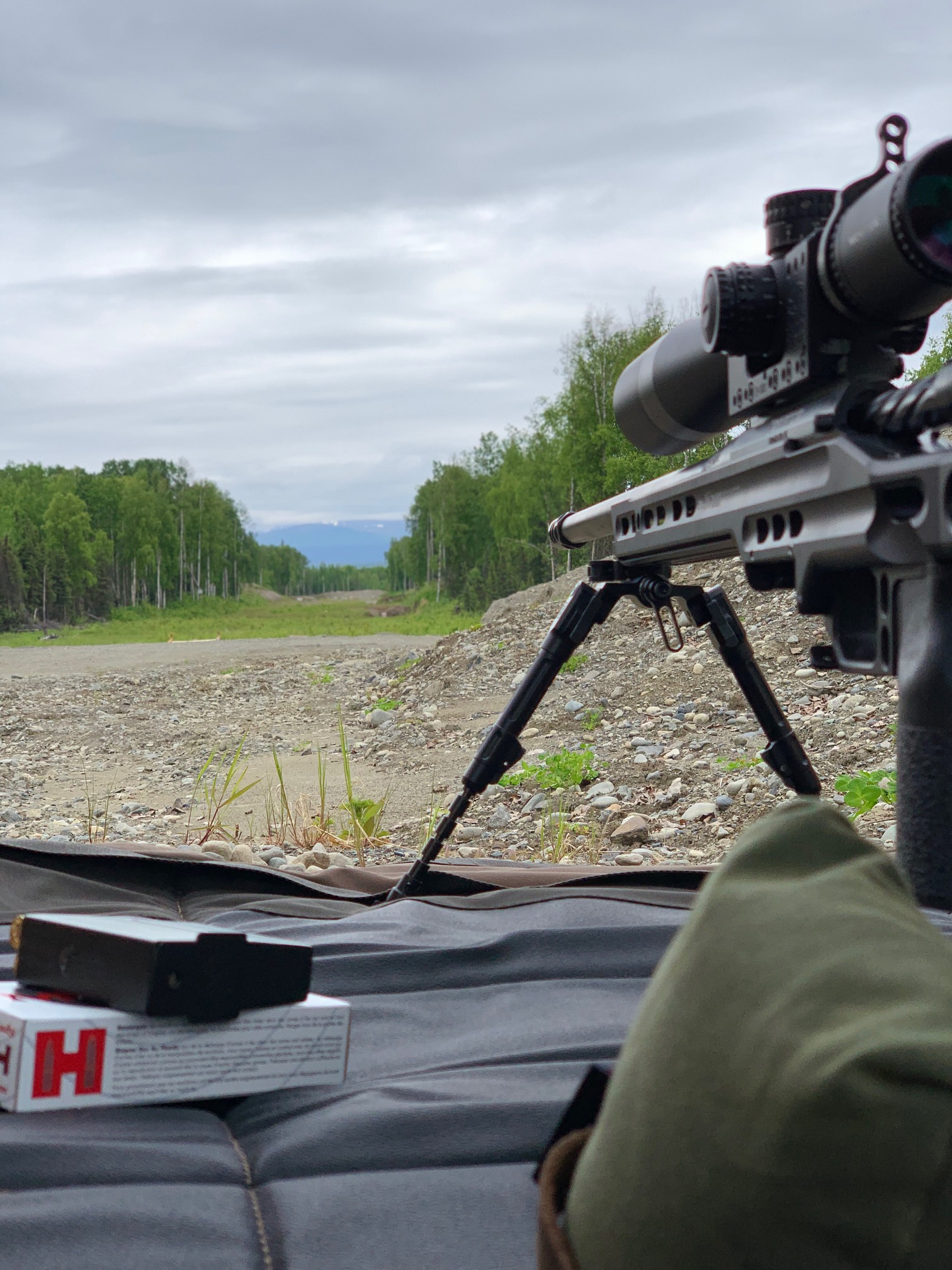

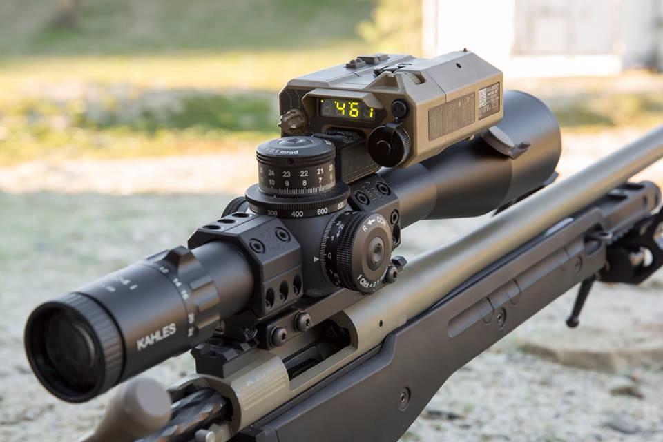

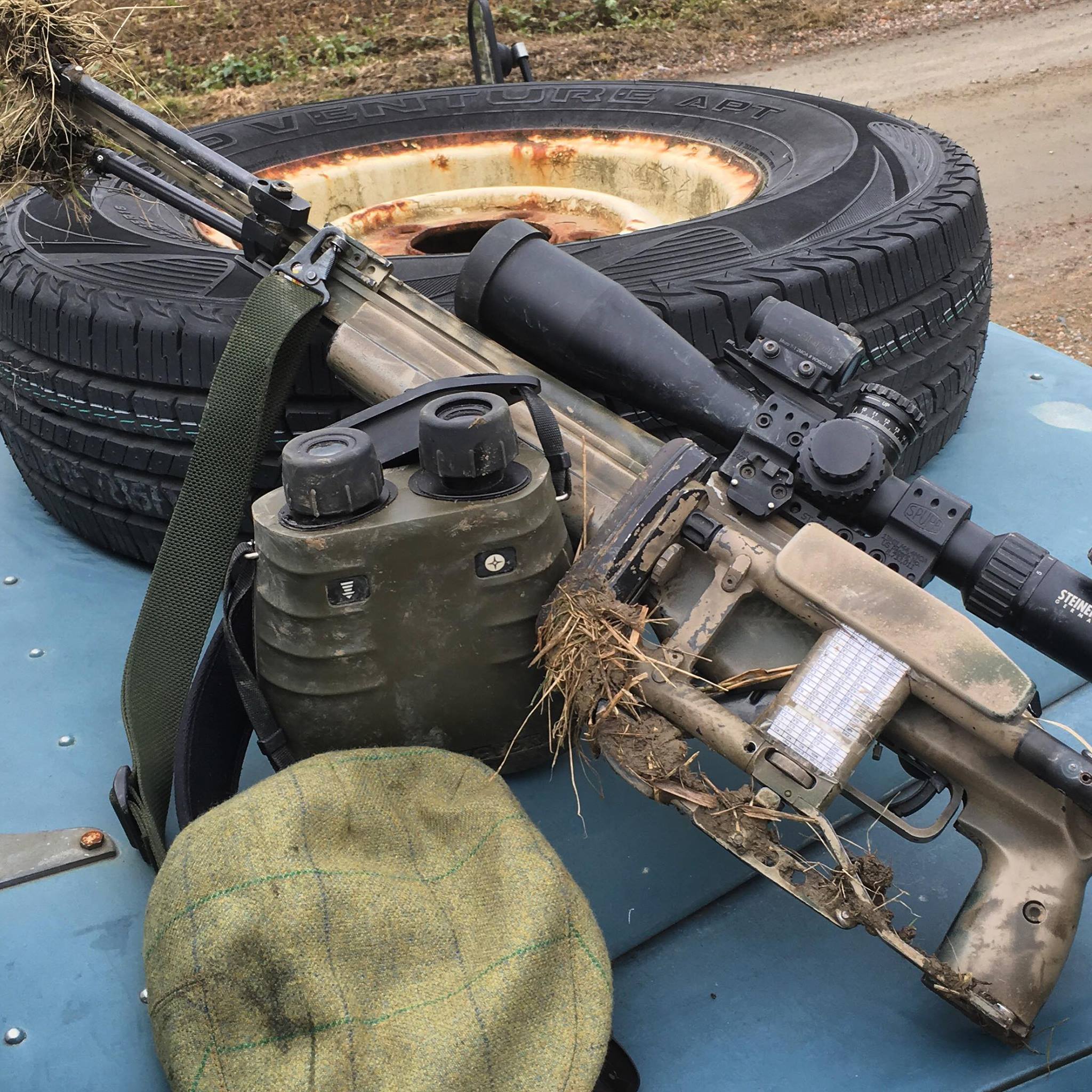

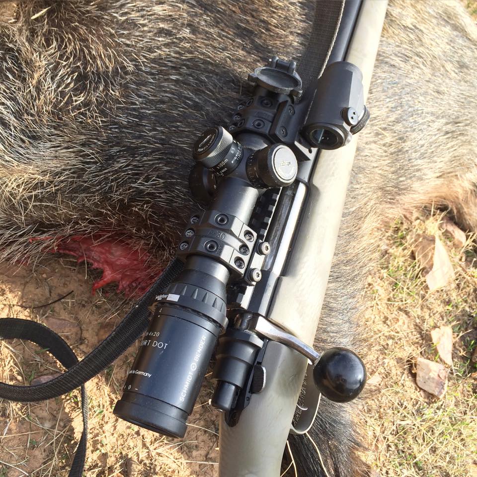

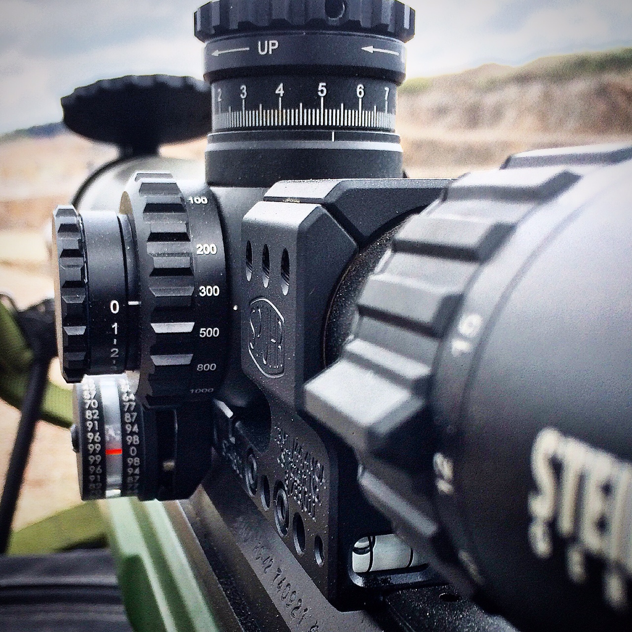

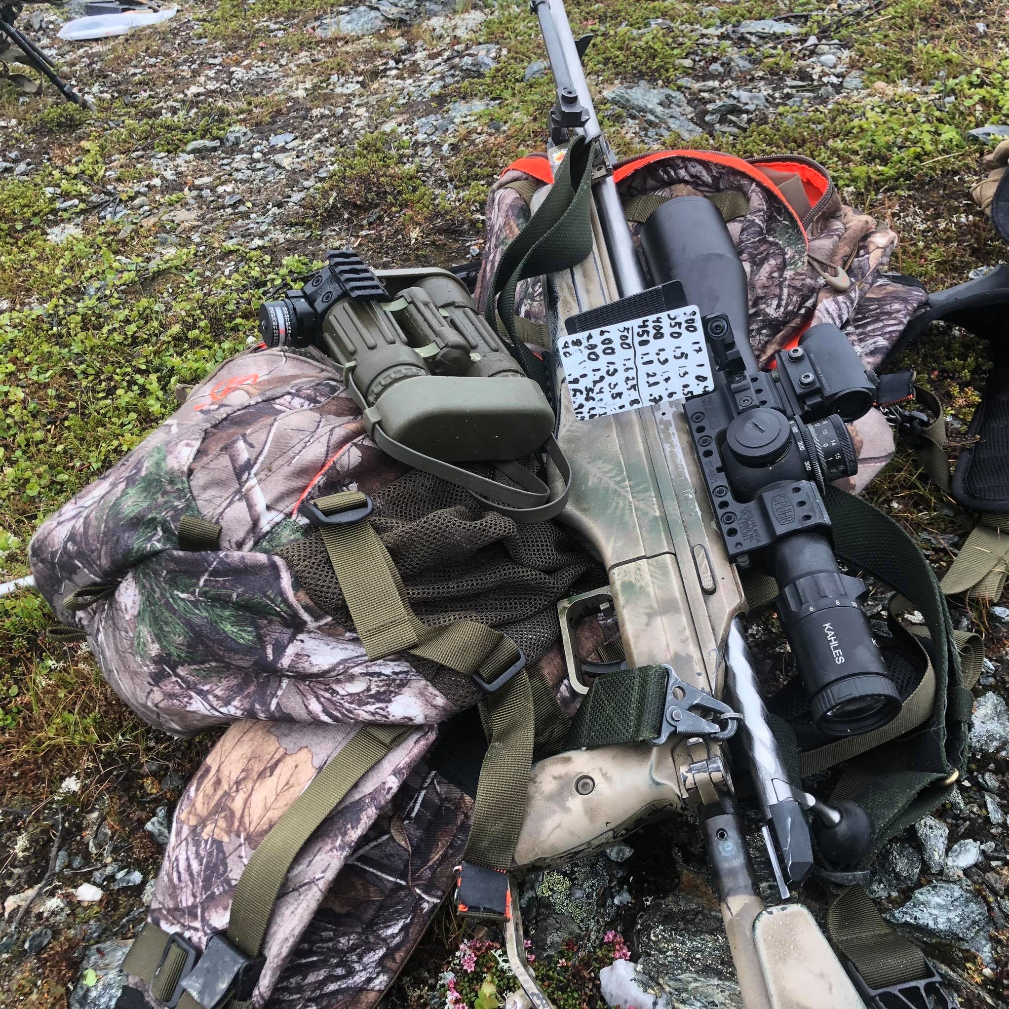

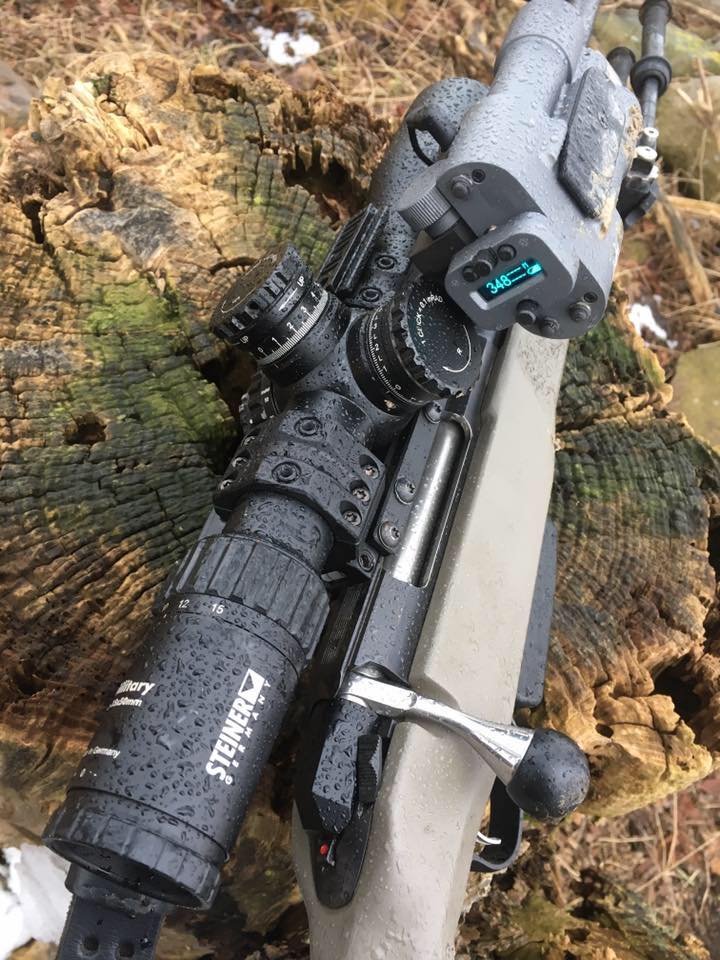

Hi
When it comes to secondary sights on long range guns I see great use of it for other things than close range...
I am using a 12o'clock mounted secondary to faster find the target.
For example on a PRS match there is often targets not visiable for the eye, but there is something close easaly seen like a big rock or a three or something.
So instead of cranking scope down to 4-6X to find the next target I simply raise the eye to the reddot and find the rock or the three there,move eye back to scope and fire.
I am pretty sure we in the future will see way more mounted lasers.
And a laser is best mounted on the scopemount as there is ALWAYS a flex in the forend.
Currently LRFs are expensive, but sooner or later there will likely be more nicely priced lasers.
If there is a need for fast shots at close range I prefer the secondary sight mounted five o'clock instead to keep cheekweld and just rotate gun.
Now that is not really realistic on a heavy long range gun, but if the gun is easy to move this solution works great, and it does not build a high mount.
spuhr ISMS mounts are 95!!! different models in a lot of diffrent heights, tilts and dimensions.
It's over 40 various accesories for secondary sights. lasers, nv, thermal, ACI etc.
When I started to design the spuhr mount about 10 years ago and kindly got a lot of imput from Snipers hide members the intention was to make the most versatile mount with the most future in it.
I would say there is nooone even close.
when it comes to repetability and stability on the gun, the single MOST important part is to have grease or oil on the picatinny rail
With a dry mount on a dry rail there is no mount regardless of manufacturer that is safe from poi shits!

Could you help me understand the thought process of lubricating the contact points of the rail and optic mount?
Reactions: eelman308
Yes!
Of we compare to a screw, 95% of a screws torque is lost in friction, by adding lubricant we change that so we loose about 85% in friction.
same thing happends betwen rings and picatinny, 95% of torque is lost in friction and rings are not properly seated on picatinny.
When scope gets an impact, it Will move.
By adding lubricant betwen rings and picatinny you get those rings correctly seated and they Will not move upon impact.
You can easaly test this yourself!
Check zero on you’r rifle, bitchslap scope and check zero again.....
