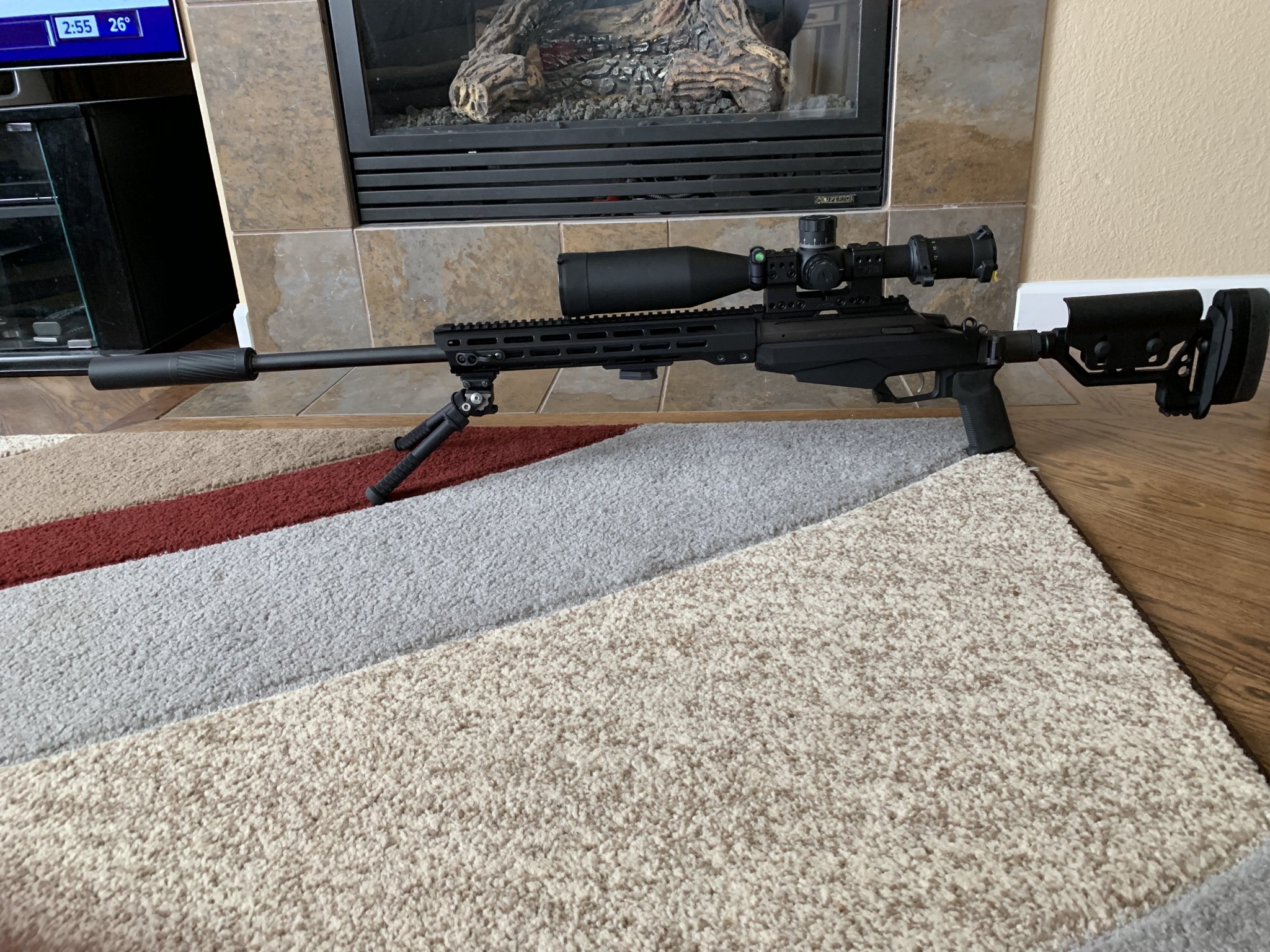

I run an ARC M10-QDL Mount w/20MOA on my Tac A1 with an Athlon Ares ETR. 1.57” height.
Does this allow you to reach out for mile shots? I read on some other threads that 20 MOA will reach to 1,000 yards and not much farther. Most of my shooting will be 1,000 yards and less but I want to hit that mile mark as well.

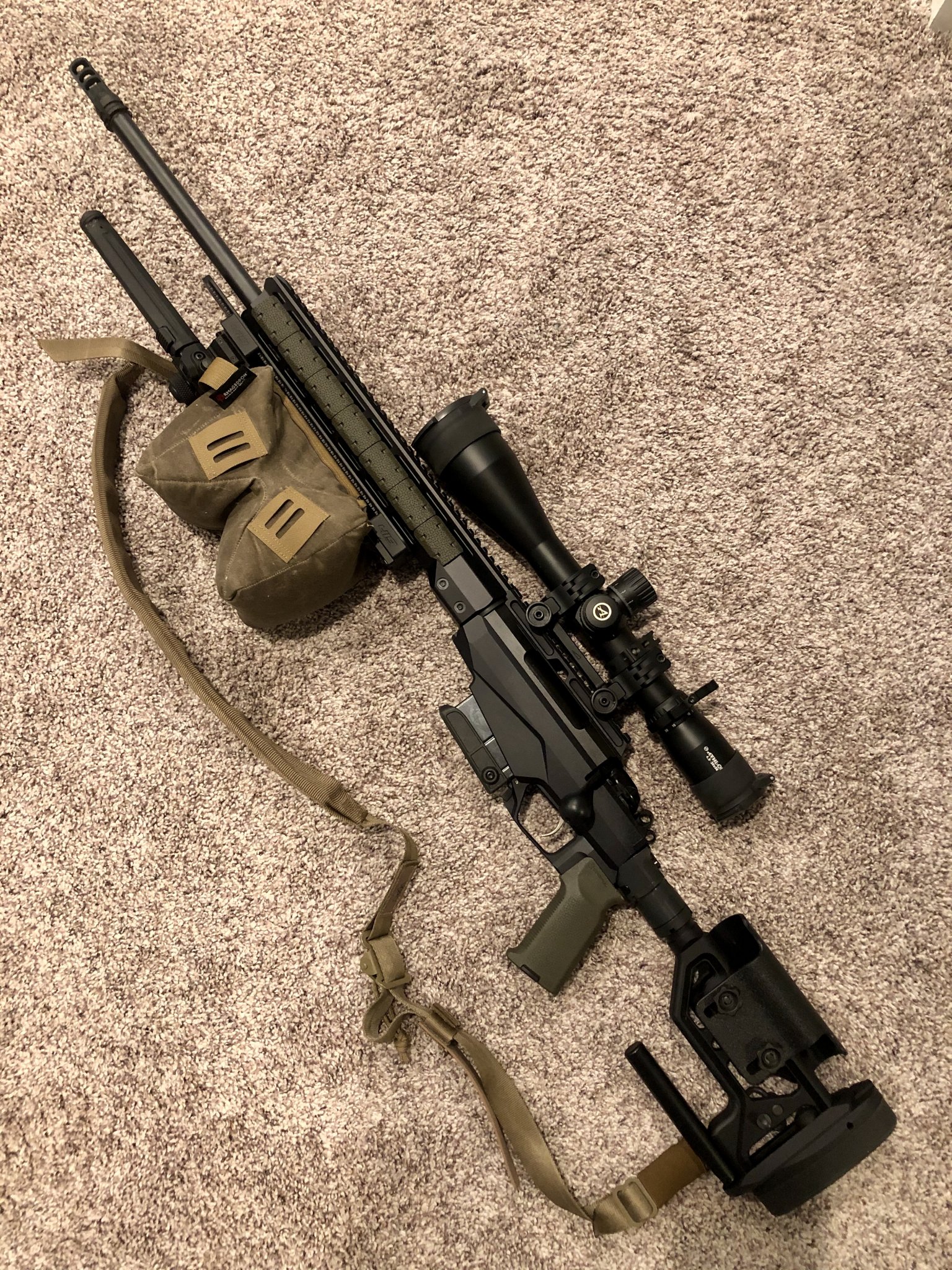

Spuhr 4601.
Thank you for the picture. Super helpful. Is there a specific reason these are so expensive compared to others? I wasn't able to tell if this had a bubble as well.

I have the exact same setup but with ARC 30MOA Mount on my TAC A1 and Razor Gen 2.
It would be my recommendation. Made in America and a better ring design IMO. Also $100 cheaper.
Did you go with the 30 MOA so that you could reach out to shoot farther? From my research it seems like that is the reason to go with a higher MOA but I am not sure. If so, any trouble hitting distances between 100-1,000 yards?
Correct. The razor has more than enough elevation with a 30moa mount that it will not be too far from the optical center. 30MOA is about 9 mils.
If you are never shooting over 1K, you don't even need a canted base with the razor and 6.5cm. Its less than 10 mils to 1k and you have 14+ of usable mils if you end up with a zero in the middle of the turret. You then have the reticle for an additional 10 mils of hold.
You can also zero at a further distance such as 2 or 300 yards to gain some more elevation.
30 MOA will let you take the 6.5CM out past a mile in the right conditions, with the right load, but its anemic at that distance. I would rather have the capability to do it than one day want to do it and be unable too. Even if you are just lobbing mortars at that point. It also give you some more breathing room if your zero is not in the middle of the turrets.

This is 1.57” with a 34mm tube/56mm objective.
First, love the setup. Second, that looks SOOO close. I read on another thread that the gap with a cover at that height was something like 6 playing cards. Any issues with it being that close? I don't see a higher height option other than 1.57.
Another noob question, can the bipod simply be attached to our barrels? From the looks of it it seems like we need another attachment just to mount a bipod.
Thanks 👍🏼.
It is close, but I’ve never had any issues, flip cap never touches anything.
As for the bipod - I would not mount to barrel, you’re putting stress/pressure on the barrel, won’t help for accuracy. Either a pic rail mount, MLOK mount, Harris stud style mount, or Arca rail mount (all on the chassis/handguard) are the way to go.

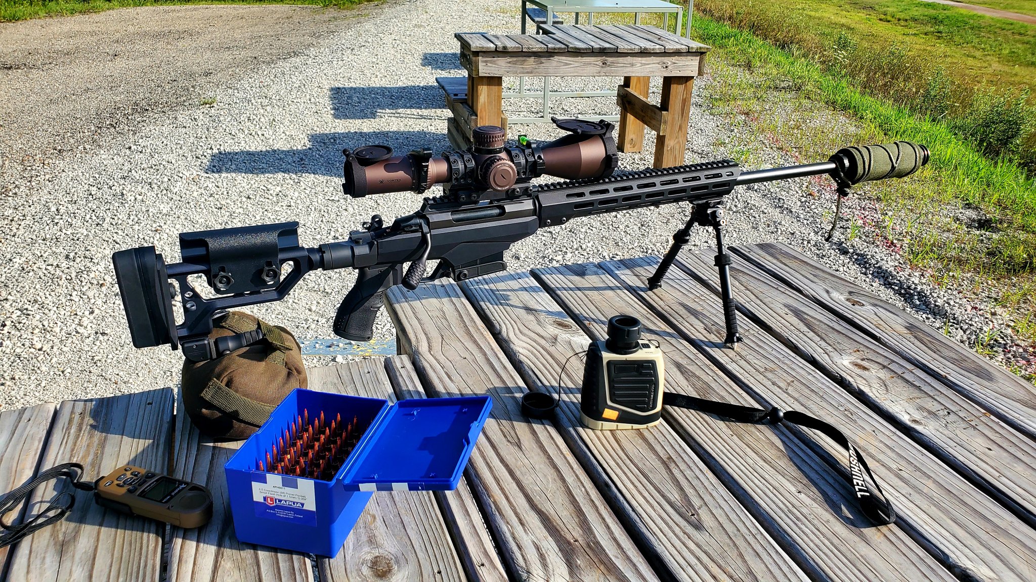

I’ve never had the opportunity to shoot beyond 1,000 yards so I don’t know for sure. I can get to 1,000 with ~10 mils elevation dialed in, and I know there’s more to give - but I’d probably run out on the way to a mile and have to do a holdover I’d guess.
Also, do you have any issues reaching out to a mile with this setup?
There is a bubble level. I don't think I could dial to 1 mile. It would require four+ revolutions on the turret (44.5 mils). I have shot out to 1400 yards ( 1 mile = 1760) just dialing though (27.4 mils). Which is almost three revolutions of the turret.
