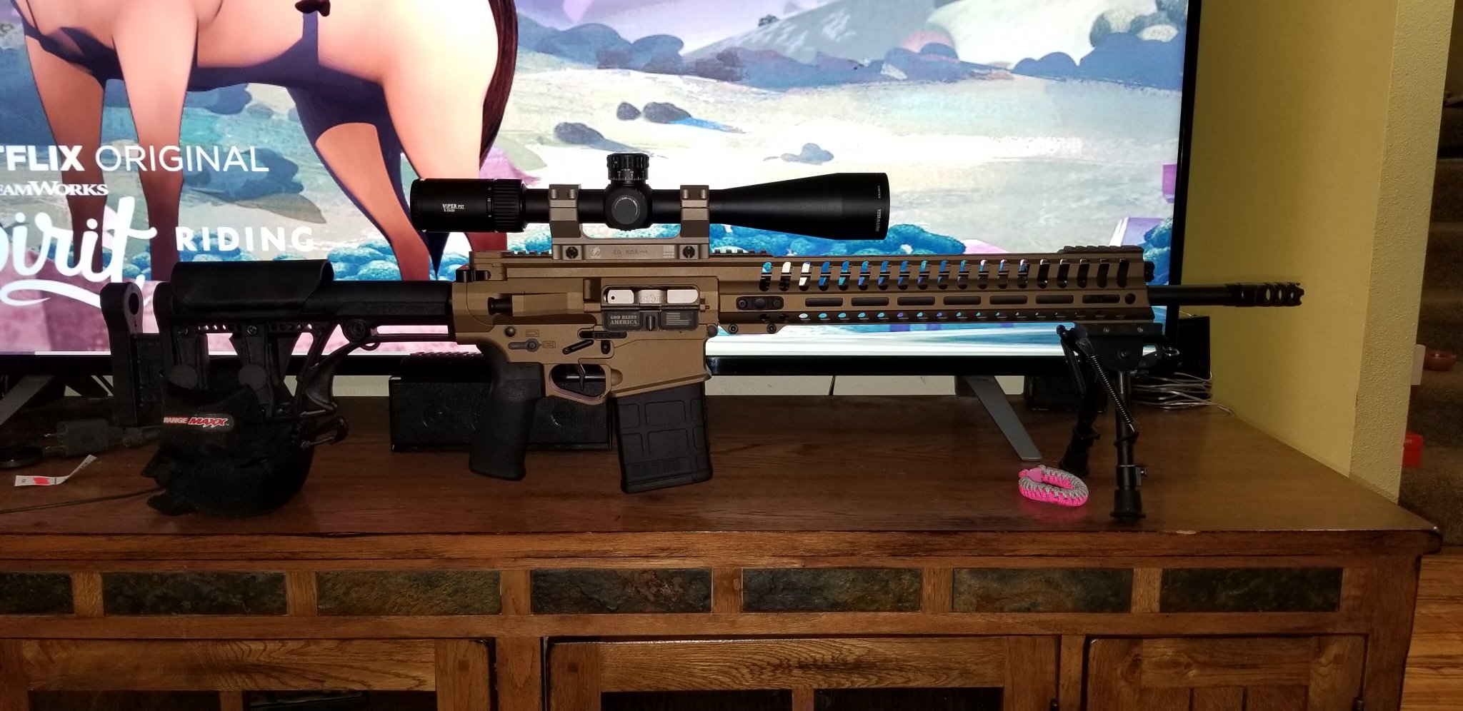

I have a Gen II PST mounted on my AR10 with a 20moa ADM Recon mount.....my stock has an adjustable cheek piece so I can get proper cheek weld, but otherwise I might feel that my scope height is a tad too high...haven't measured precisely, but its around 3in with a tape measure.....am I too high?

If the rifle fits you, you aren't too high.
