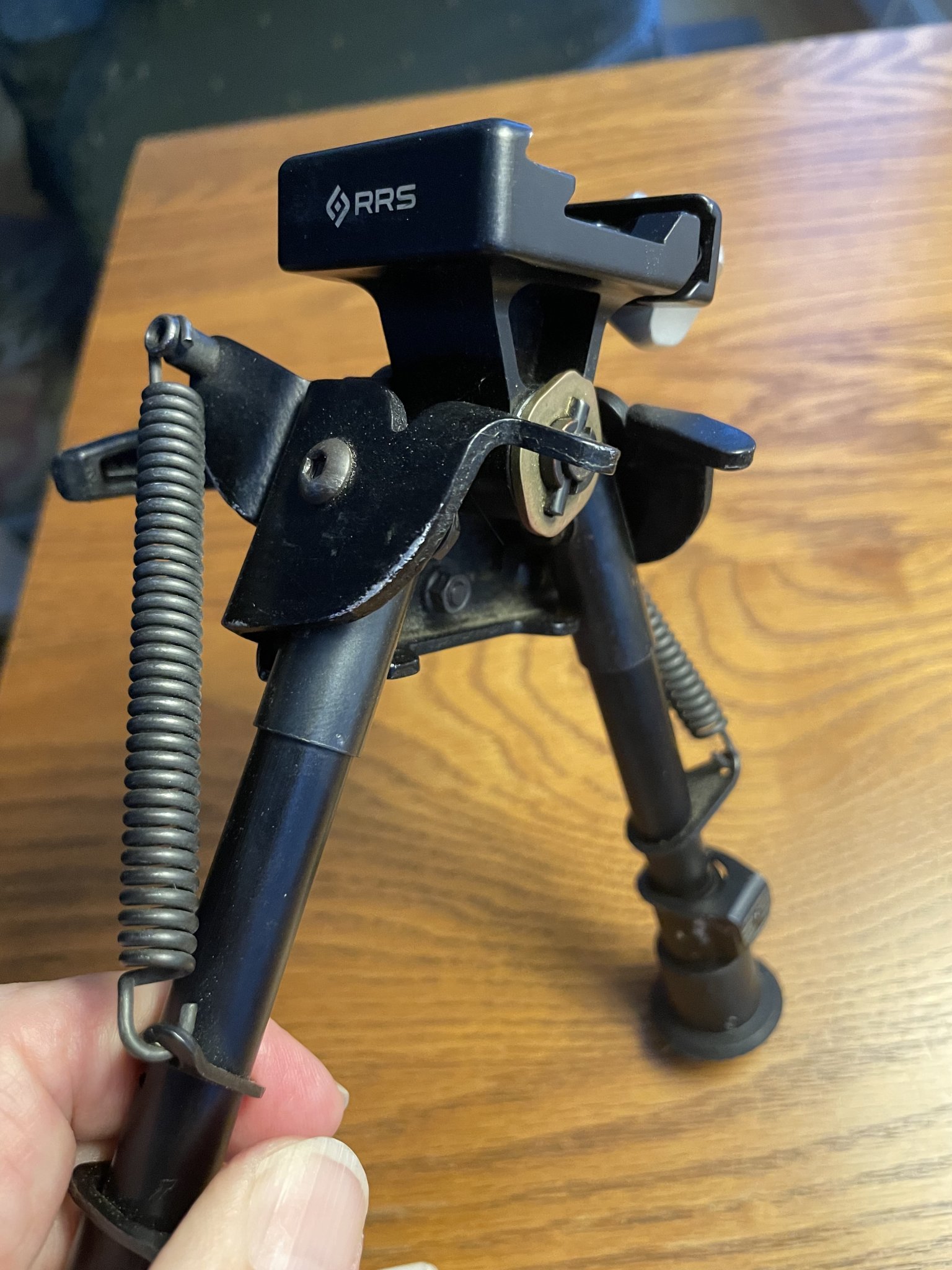

If you want to stay with a Harris bipod, your best (by far) solution is to purchase an ARCA adapter - and the top of that heap (if not the only thing on the heap) is the RRS set.
RRS used to sell a one-piece Harris adapter (photo), but now you have to buy two separate pieces (link above) - which are expensive. LONG TERM, if you do much shooting at all, buy a better bipod with an ARCA clamp.
The standard sling-stud Harris mount is just too weak for "serious" work... I've assisted many new shooters whose Harris bipods were literally flopping around hanging from the stud; they had no idea that such "play" made correct support of the rifle impossible.
Where does it have "play"
Additionally - I should have mentioned this earlier - the knurled tensioning knob (on Harris units that have cant) pretty much needs to be twisted with pliers to really adjust. That needs to be replaced with a KMW Pod-Loc, available through many vendors.
A Harris can be a perfectly adequate bipod for many applications with the aforementioned upgrades, especially for simply shooting from a bench. OP, just keep in mind that many people here are competing in matches where 20+ pound rifles get whanged down hard on different props; the majority are spending $300-400 on bipods and some spend over double that.
