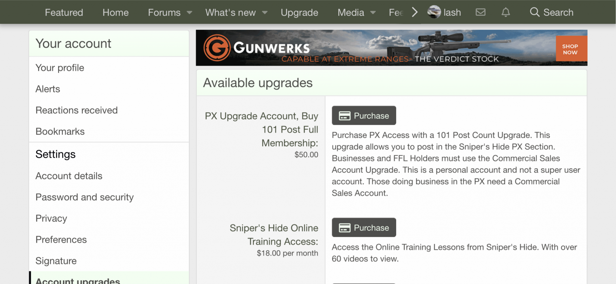

Here on Sniper’s Hide:
Up top on your menu choices, choose “Upgrade”. Then sign up for online training.
