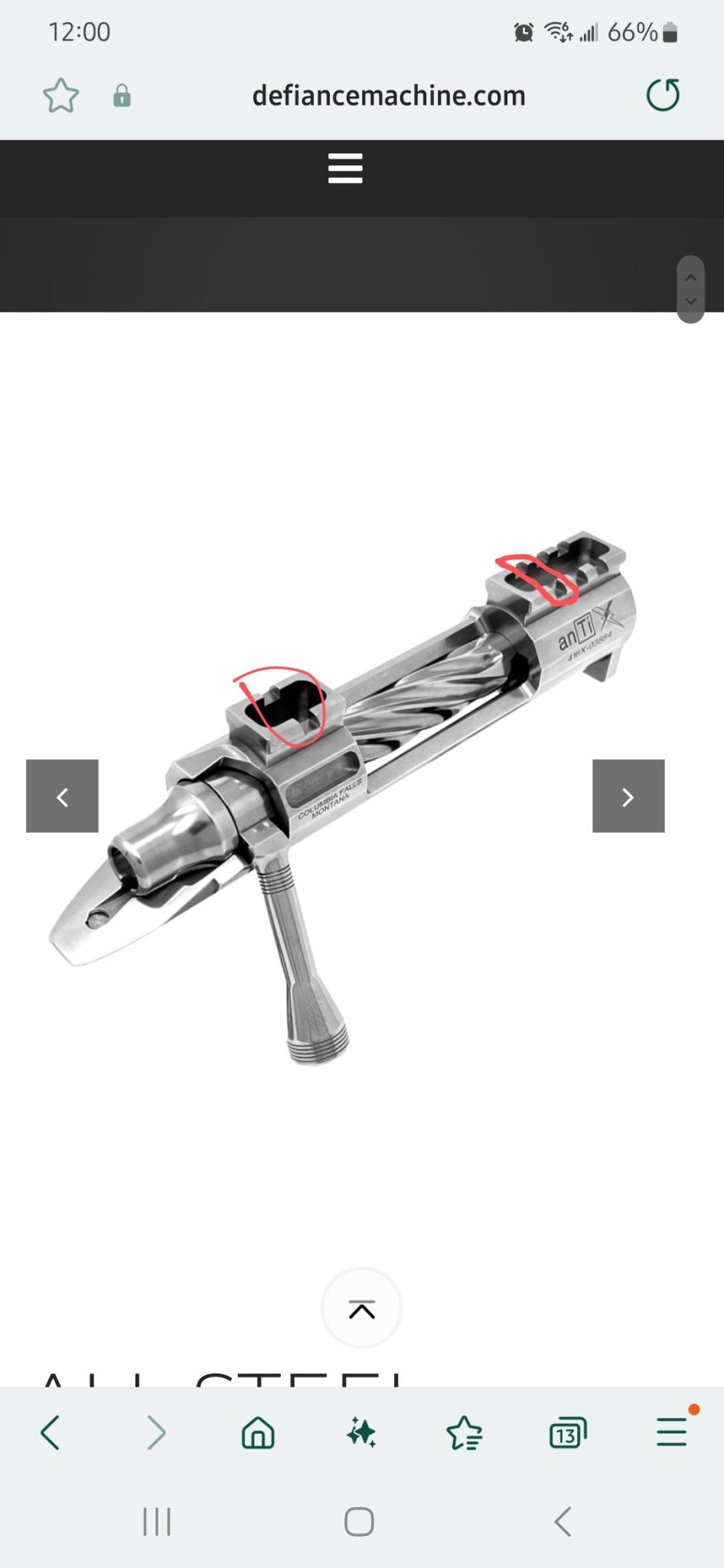

Hi, I want to know what direction you guys push the scope ring when installing at these position I circle. Do I push the front forward and the back backwards?
When you tighten the base of a mount or individual ring push it forward towards the muzzle. The idea being, especially with heavy optics, is the the scope wants to stay in place while the rifle recoils underneath it
Which can cause the ring base to slide forward in the pic rail
I force everything forward under tension with my thumb while torquing. This goes for the bases as well; especially on a base with a recoil lug like a tikka.
All the recoil lugs I have seen on bases require them to be pushed toward the rear of the action to make contact with the lug.
Pushing one forward and one back can lead to another problem someone mentioned. The ring spacing not fitting on another picatinney rail.
I have also never seen a picarinny ring that didn't have play in the slot for the lug. If I did I would suspect one of the two was not cut to the correct size.
