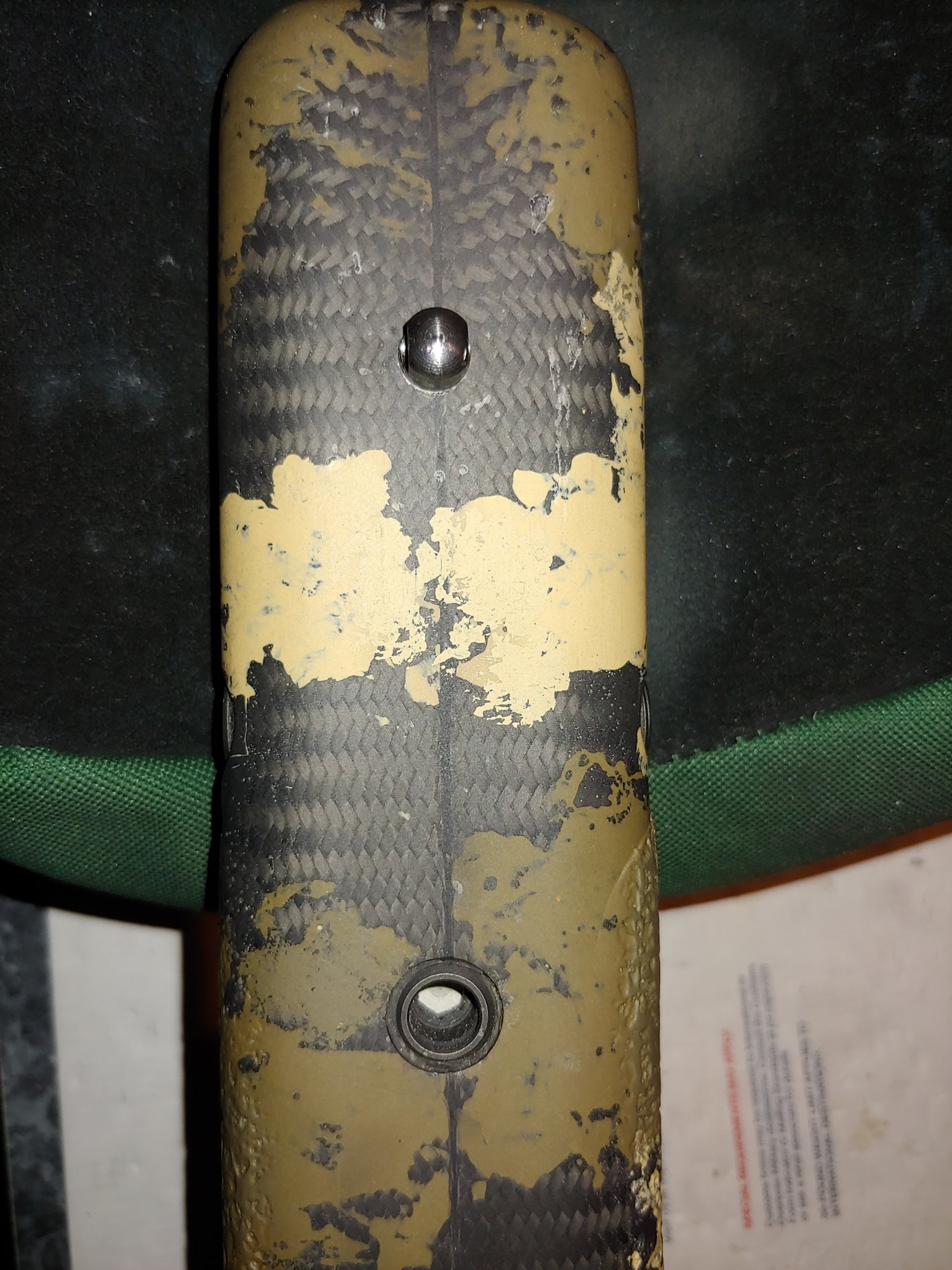

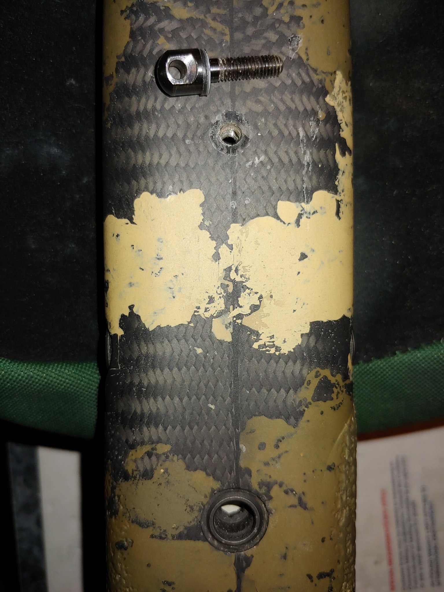

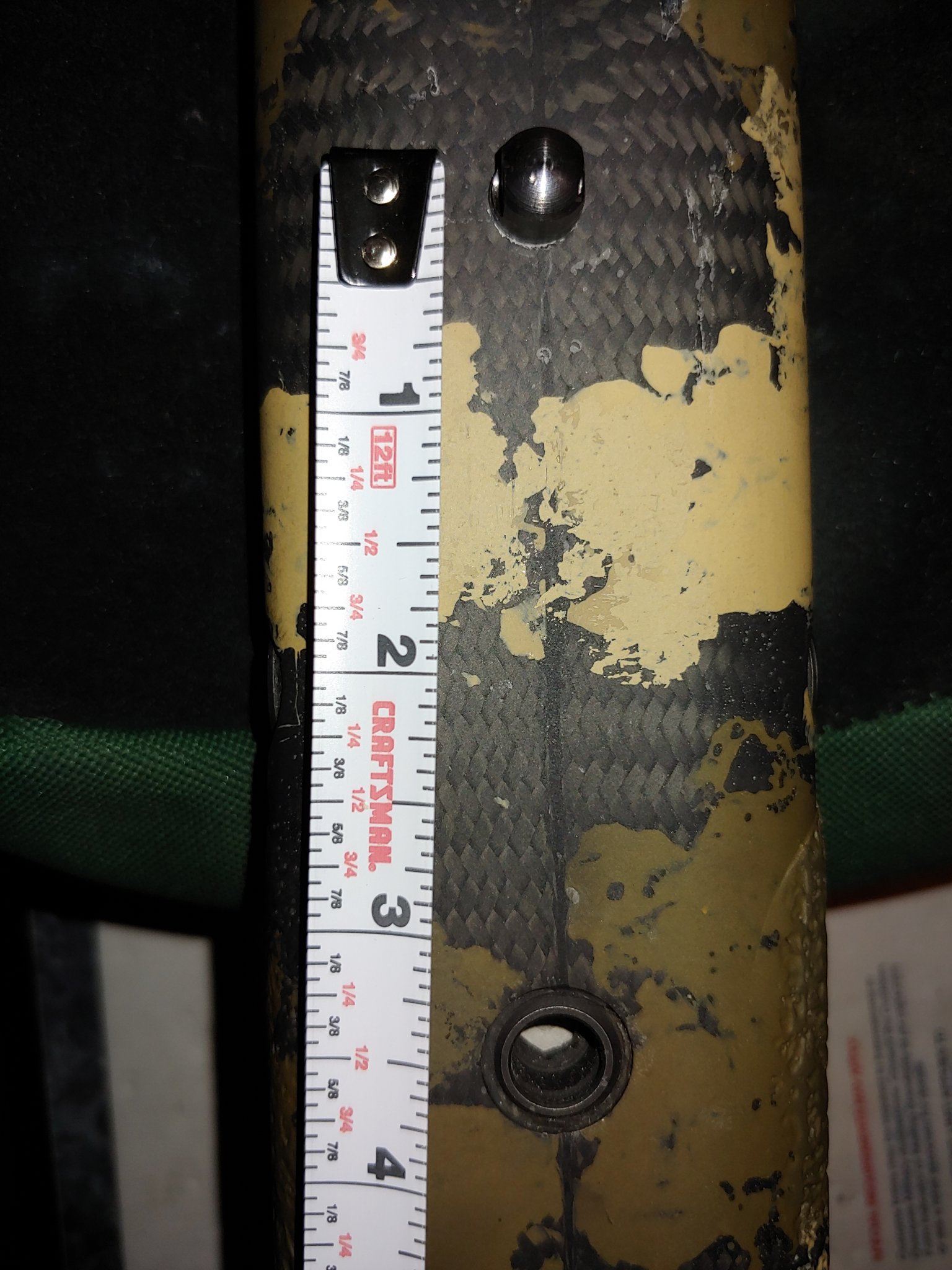

Just picked up a beautiful GAP from a Hide member
It is my first stock style rifle. and was wondering about pic rail mounting options
My first option is a Blackhawk adapter rail. I used one before and the seem to hold decent
Second option is the BT 17 rail-bolt spacing is 2.2-3.5 and the T-Bolt kit
But my stock has a sling swivel and a flush cup a few inches back. Not 2 swivel studs.
I have seen the pic rail bedding vids and I feel pretty comfortable doing it.
But dont think it would be an option here because of the flush cup?
The stock is coming off to swap the trigger anyway, so that it would have been a good time to try the bedding
If there a rail option that can attach to the swivel/flush cup combo and not require drilled/epoxy?

Thats what I planned to do with the B&T rail. But the flush cup is right where I would drill it out and the hole is too large for a 1/4 inch hole already. I guess I can lay the rail over the flush cup and drill a hole and epoxy a t-Nut right next to the flush cup???
What about running a little shorter rail that allows you room for the flush cup? I am pretty sure they offer different length kits.
Most of the short rail sections are for swivel threaded inserts. I guess i can screw one end into the swivel and drill and counterdrill and epoxy a single Tbolt. But then it will be trips to Home Depot looking for proper headed screws. The BT tbolt kit uses button head screws that their rails take. Most of the other rails take beveled head.
That can and might be my only option. I was just hoping there was an easier way. Or i can just do the Blackhawk.
You might need to do both. I am not sure what the thread size is for the bipod stud. It might be the same, but I am not 100% sure. There are several videos on youtube showing how to do it. I did mine on a CZ457 wood stock.
