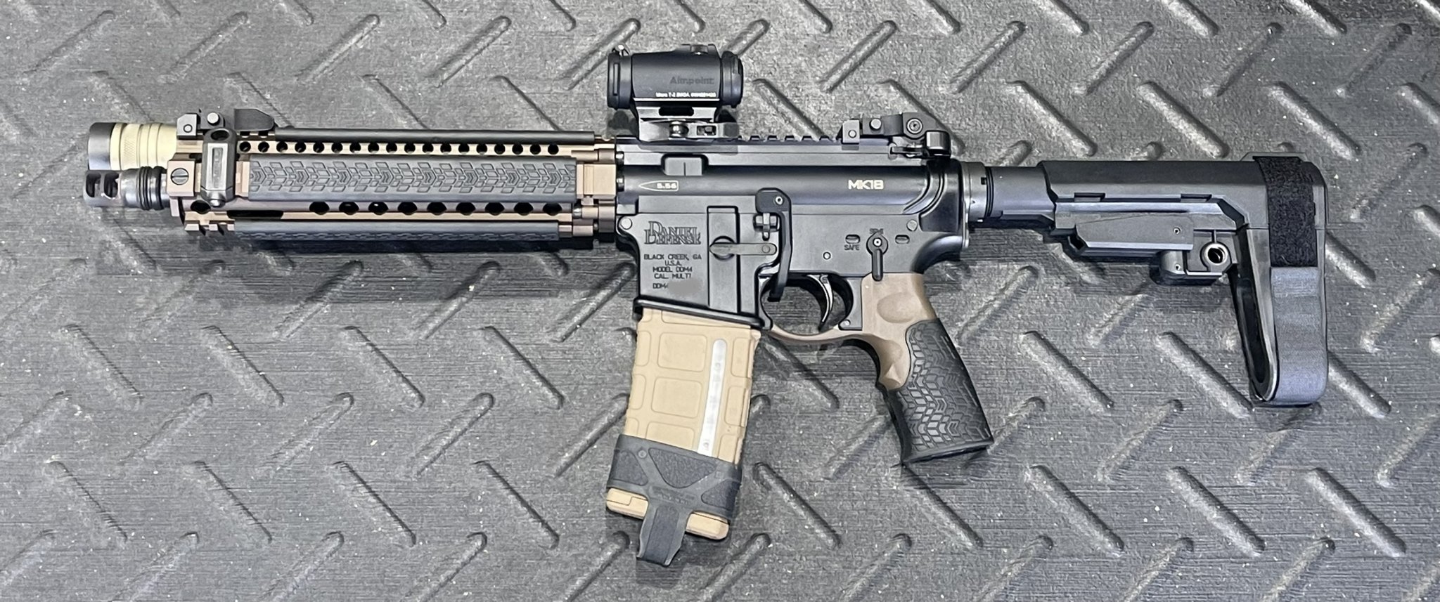

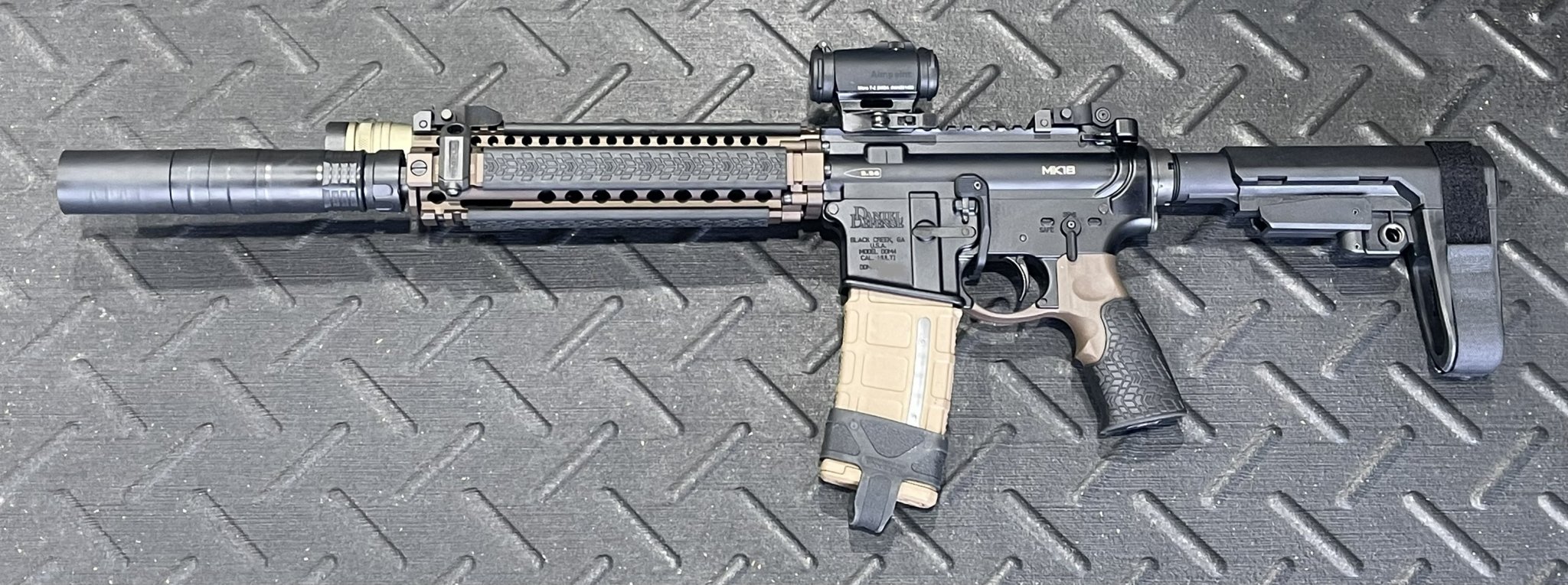

Hi, I'm new here and relatively new to the AR-15 platform. As all of us AR Pistol folks will have to soon be "forced" to get a tax stamp for our pistols (this coming August), I see no reason not to swap out the SBA3 with a proper stock and while I'm at it, get in line to get my tax stamp for a suppressor.
I have the factory-built complete Daniel Defense 10.3" MK18 and I have been eyeing the Surefire SOCOM556-RC2 suppressor to be able to easily mount. My question is, given the current build, what exactly will I need to easily mount this (https://www.surefire.com/products/suppressors-division/suppressors/socom556-rc2-suppressor/) to the pistol?
I am FAR from savvy when it comes to even the most rudimentary gunsmithing (I am slowly learning) so any layman's advice would be much appreciated. And thanks in advance for any and all helpful responses.

Yes, I am leaning towards this and calling it a day https://tombstonetactical.com/product/socom-muzzle-brake-5-56mm-1-2x28-m4#product_detail
What is the benefit of the Surefire muzzle brake vs. the three-prong flash hider? The pew science article compared the warcomp to the 3-prong flash hider and as someone else stated, the 3 prong was significantly better in the testing. So where does the muzzle brake fit in? Thanks
It hasn't been tested but the problem with the warcomp is it doesn't have Labyrinth seals. The muzzle brake does have them and it's probably ok even with ports right next to them but we know for sure the flash hider is gtg.
Having said that flash hiders are often very abusive to blast baffles. The question you need to ask yourself is what is the realistic round count and firing schedule you plan for it. If you plan on shooting it a lot and with aggressive firing schedules it might be a good idea to get the brake.
