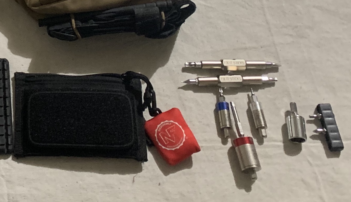

Grab a set of Fix it sticks and a small pouch. Now every mount is a QD Mount ?
Seriously though, their tools are super compact and fairly inexpensive...plus you should have a set for your action and ring caps/tops anyways. Consistency is accuracy and by torquing your stuff to spec each time, you can’t get more consistent than that.
I keep my tools in a small zippered pouch with a small Velcro/magnetic patch on the front, should I have to secure some small screws.
