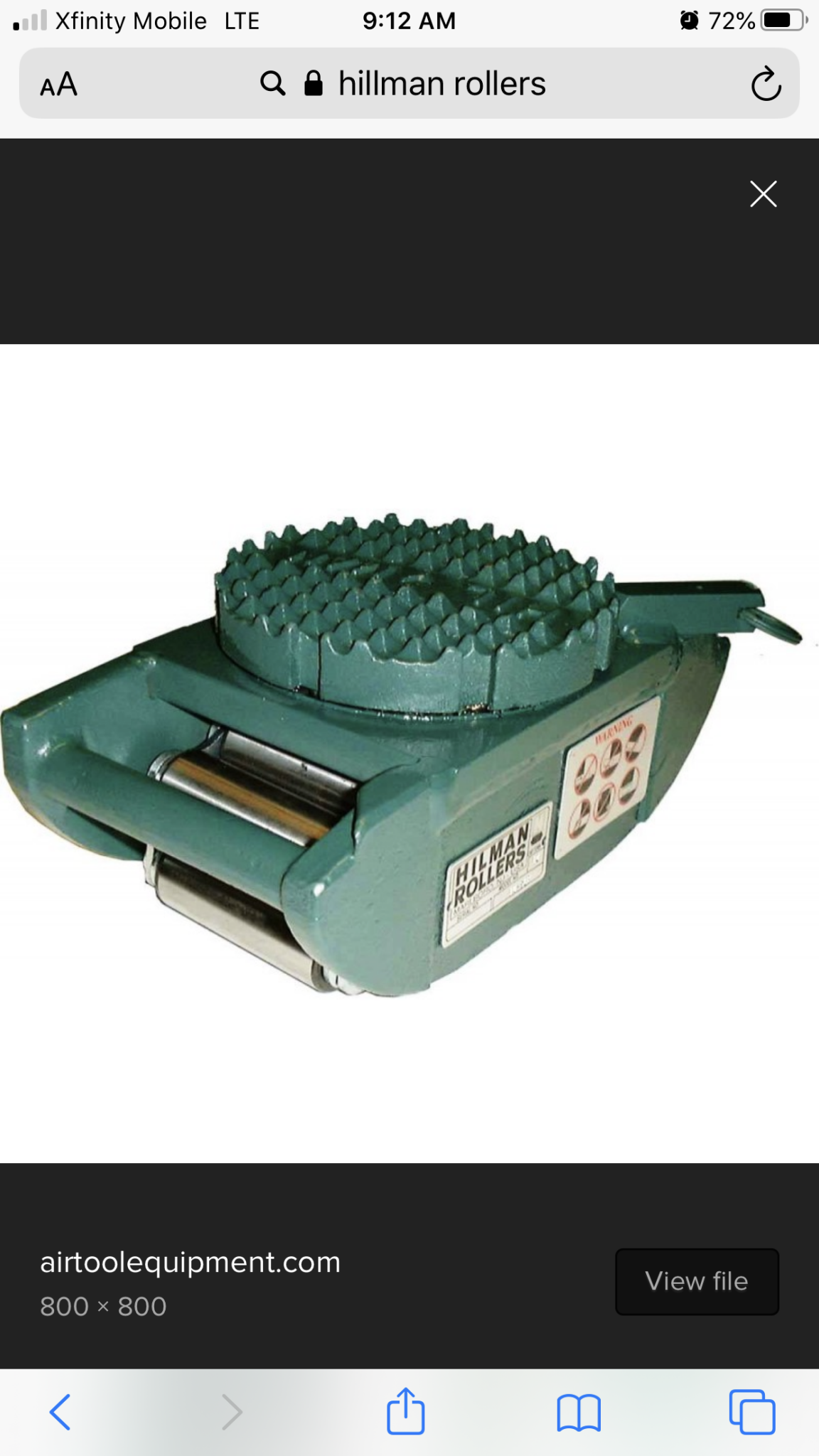

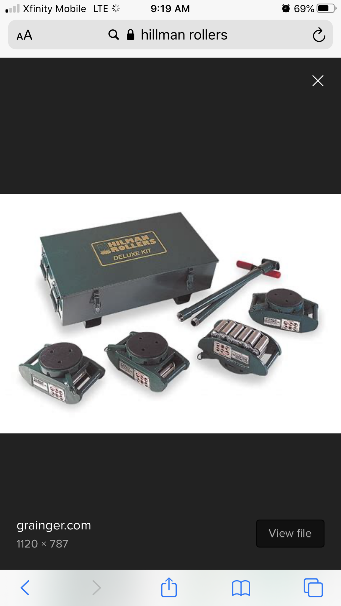

Try a rental place and see if they have some hillman rollers. Depends on the floor though. They look like little tanks should come with a pull handle to pull them along and make turns. Small but heavy duty

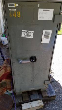

Also found this safe which I may buy too lol

Hillman rollers and toe jacks will be easiest. You will need a pry bar to get it up on the jack still. Cheapest way is using rigid steel or aluminum electrical conduit. It's what we use at work to nove heavy electrical equipment. Has to be rigid conduit though, EMT (electrical metallic tubing) is too thin and will crush. If you take your time, you can use 5 or 6 pieces of conduit, placing them in front and pushing the safe towards them, while placing them on an angle in the direction you want to go. The only problem is that they don't move laterally, so you can get them stuck on walls and do some damage. Thats where the mechanical rollers are king. Gotta pay rental fees, but the ease of movement is worth it sometimes.

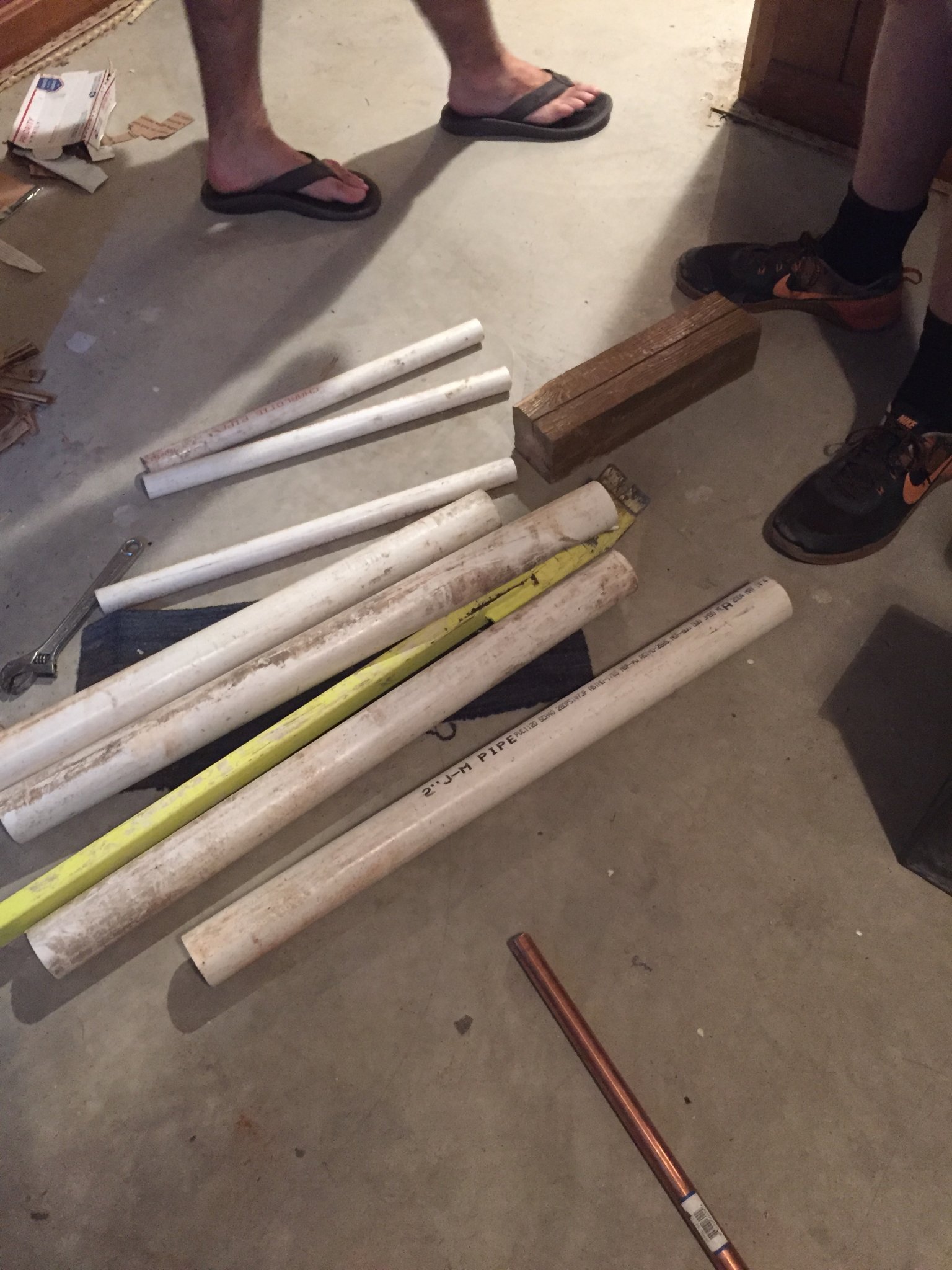

My buddy needs help moving a TL30. Pallet jack won’t make the corner in his house. Will 2 or 4” pvc work? Golf balls? ?
PVC will work fine as rollers. getting it on the PVC will likely be your issue. Swing the door open and use it on one side as weight leverage to get the backside or a corner up. I’ve done this plenty of times.

Wait where are your trying to go with it? Did I miss that? If you are just rolling it across concrete to a different part of the garage then PvC will work fine. Done it. No problem. However, if you are going up an incline, stairs or anything of the sort, then yeah, hire someone!

Yeah just moving it across concrete. Pallet jack won’t make the one turn is why I am using golf balls or pvc.
For a concrete floor, iron pipe of some sort. I used standard 1/2" black pipe when moving my lathe and mill. Watch your toes.
