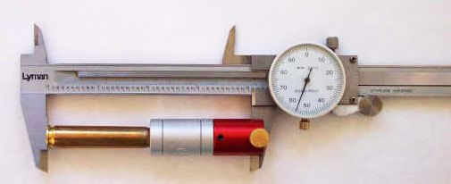

Dies- I wouldnt bother with a neck sizing die, stick with a full length die. It appears you think a full length has to size the brass all the way back to the minimum saami specs. Thats not how most are using them for precison rifle. I measure the case with a hornady headspace comparator and then use the full length die to only size it back .001-.002" in a bolt or .003-.004" in a semi. This method avoids over working your brass like when you size to minimum saami specs and it also avoid your inevitable neck sizing pitfalls of over sized case diameters making chambering impossible.
I was assuming the FL die would be mainly used if I end up with once fired brass. it would more than likely come from AR platform rifles, so using a FL so I could start with everything being equal. In my head it seems like the best consistent brass would be to FL resize the once fired brass (not from my rifle), then shoot it once in my rifle and then prep them all equally with consistent length, neck tension, etc. and bump the shoulder if needed. I know you can adjust the FL dies out a bit to not size as much and just what is needed.
I've got the Hornady bullet comparator, but will pick up the headspace version as well.

In that case I would only size a couple down like you say and fire those to find out how long your chamber is and then only size the rest down as far as required.
I wouldnt size all of them down to minimum specs, that could cause all of your brass to be short lived.
