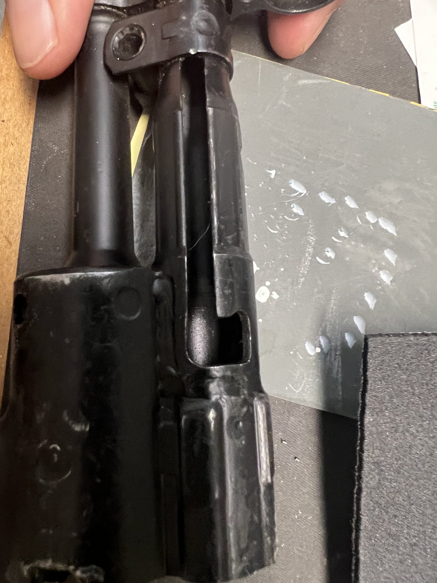

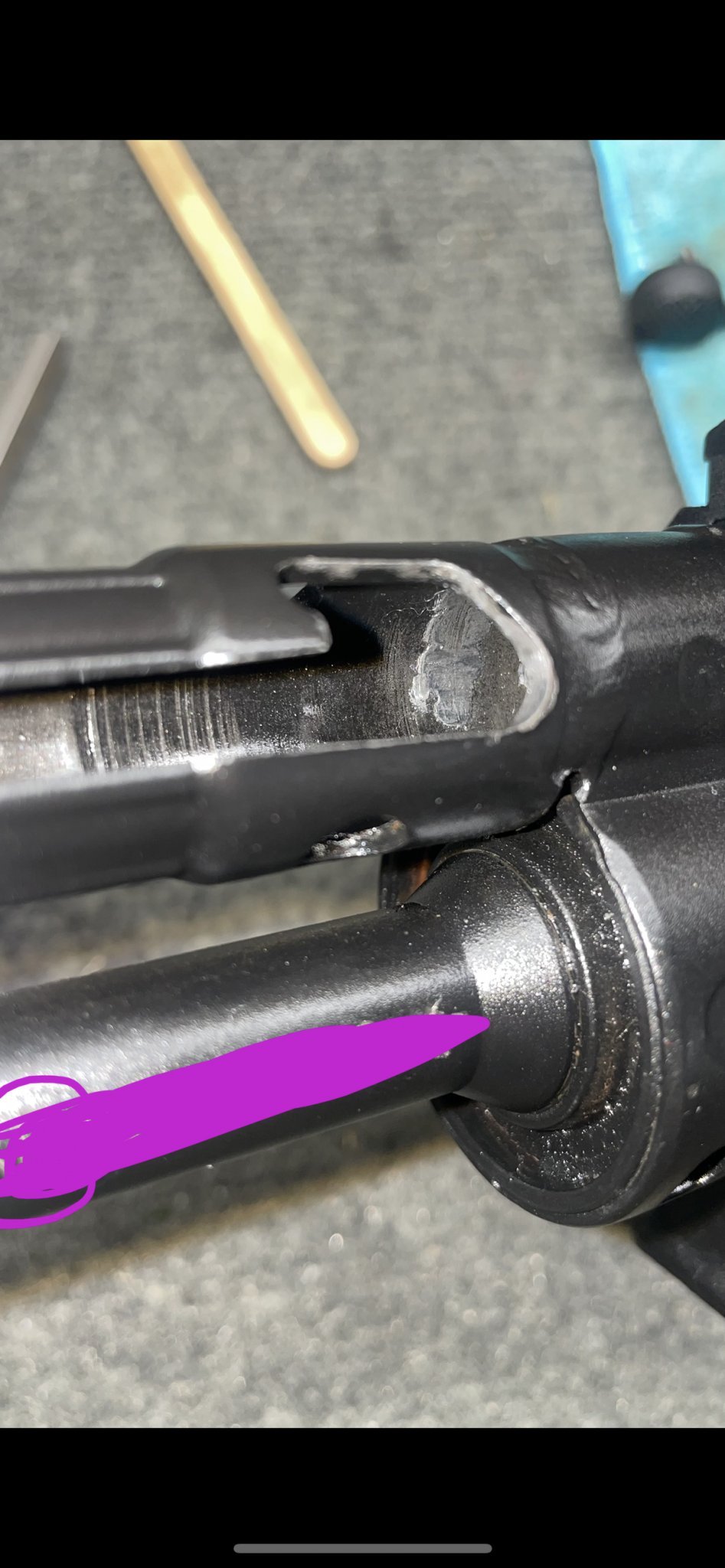

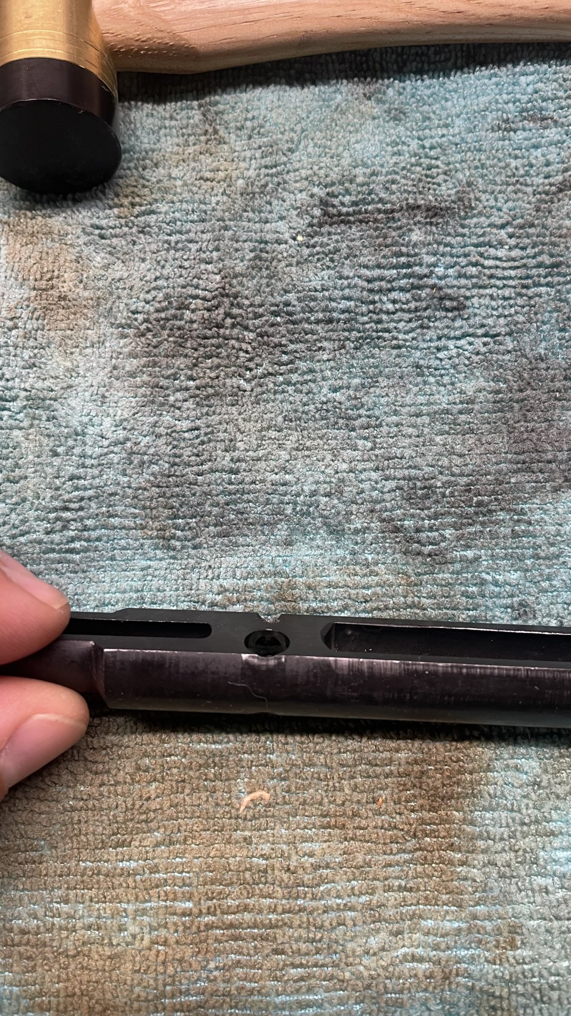

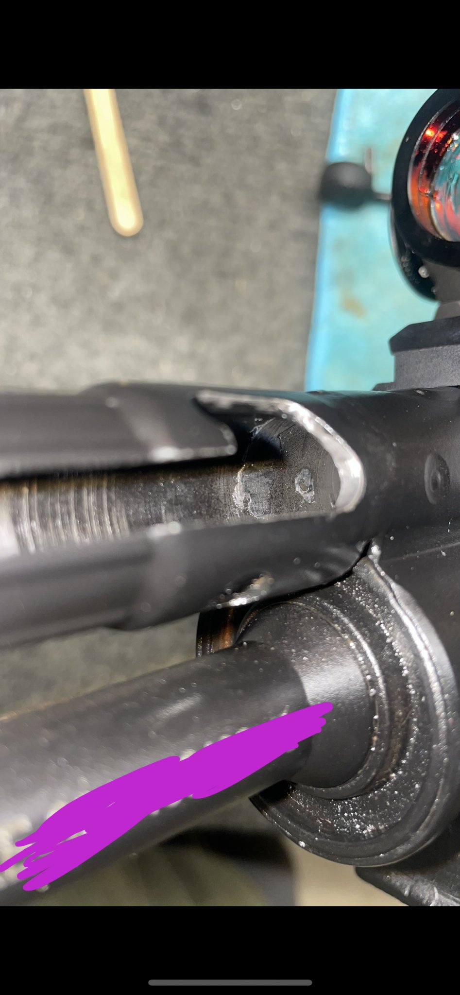

I disassembled it again to inspect if anything was in the raceway of the cocking support and it appears to be clear. In the process I discovered it was extremely difficult to remove the cocking support like it was jammed or something. I had to use a a punch to stick in the slot the that the cocking lever travels into continue pushing the cocking support backwards past whatever was causing it to bind up.

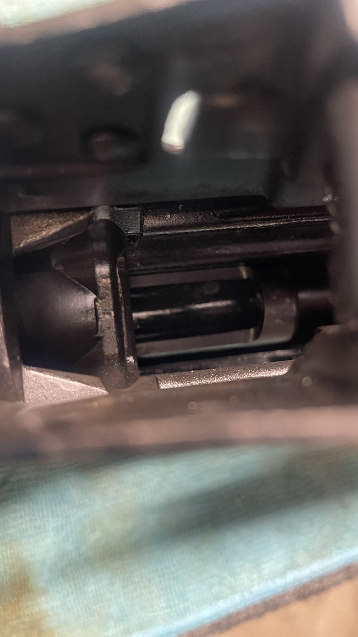

Looking inside of the tube it appears that the welds could be ground down some more. But I’m not sure what amount of visible weld is acceptable since I am new to this platform.
Is it possible for a cocking support to become bent any and cuause it bind inside of the tube at some points?
I have a good video of how it’s binding in some spots during its rotation while trying to cock it. And how it is “free footing” and moves freely.

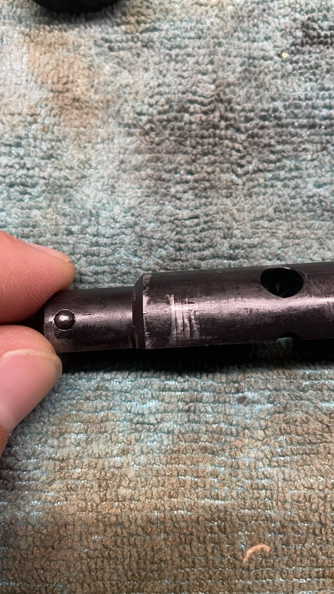

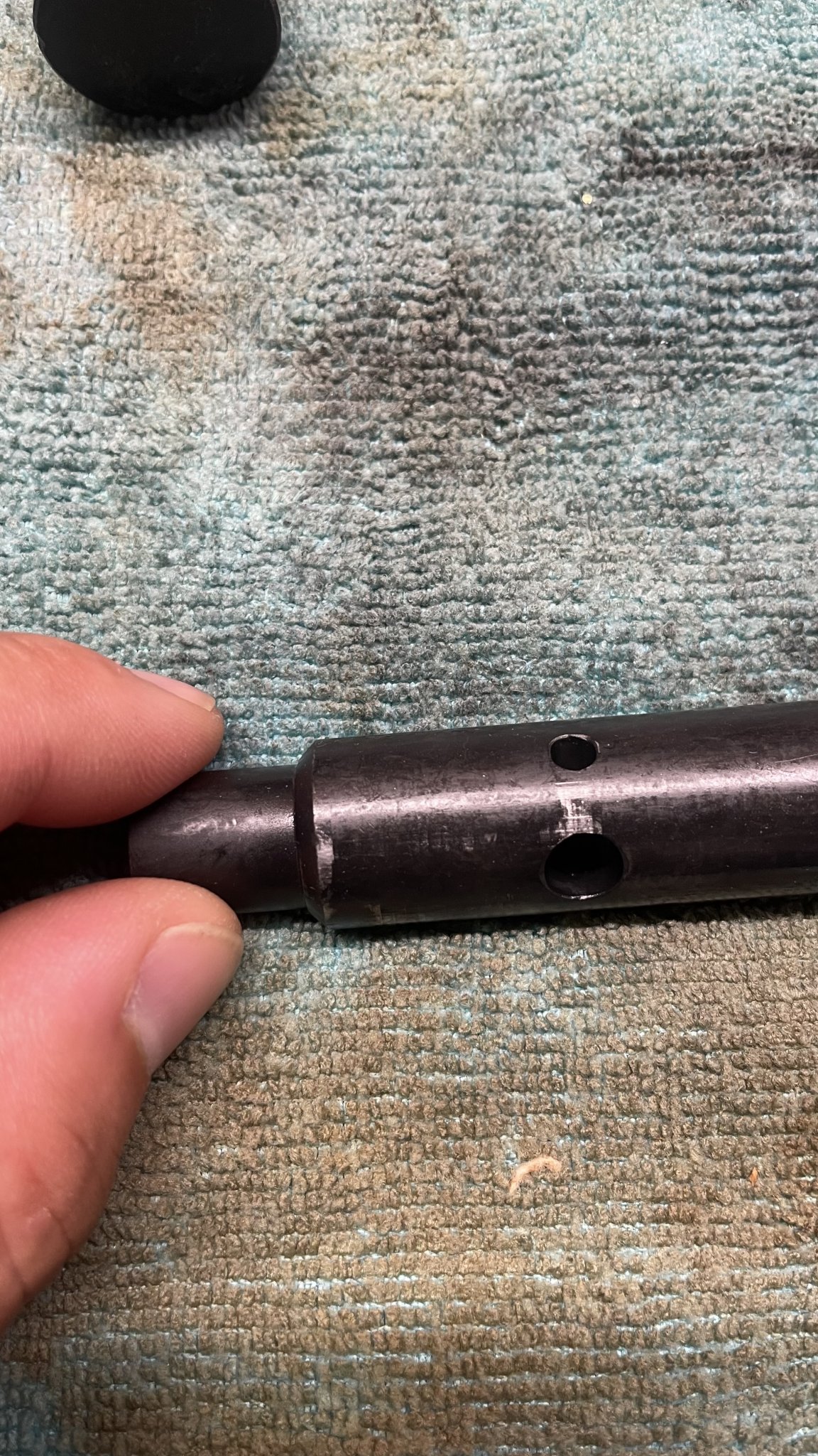

it is quite possible to bend the tube and bind up the system. Maybe in your slap and shoot drills you dinged something. That is what you need to determine. You can use a sharpie or other marker to color the cocking piece. Put it back together and move it a few times, then look it over to see where the sharpie is worn off. Once you know that you can look at the part of the tube that is dragging. It could be a weld or a dent or? Since we can't see or handle it the diagnosis is up to you.
Check the handle itself as well. Make sure it moves freely in the slot. Make sure the spring isn't slipping out of place and catching between the handle and the slot and so on.

Here are some pics for now. I’ll try and get more later when I fart with it some more. I wish there was a way to post a video on here

Remove the cocking tube end cap, check to see if you have a spacer, if so, remove spacer and then check for concentricity and check for binding. If it no longer binds, leave spacer out, it's not required and reinstall cocking tube end cap.
I removed the end cap and did see a spacer. How is this removed?
Tilt muzzle down and give the cocking tube a couple of smacks or jiggle it free. If it doesn't fall out on its own, you'll have to push it out from the other end. Edit - with the cocking tube support removed.
Yeah I quickly figured out it was just sitting there. So I did this. The cocking tube is off centered a bit but it definitely freed it up A LOT. But it is still sticking slightly in one area. Could this just be a break-in issue? It’s definitely way better than it was!!
Yeah it's gonna be a partial break in and partially because the cocking tube is not welded concentrically. It's not an issue if it's slightly crooked and it'll break in eventually.
Edit - the plus side of removing the spacer is free floating the barrel.
Awesome! This helped me out a lot. I put it all back together and it cycles just fine after dry firing. I’m glad it was a simple fix. I was concerned I was going to have to send it off to get worked on

It does look like the welds on the right side are rubbing from your pics. Obviously we can't see the left side but chances are they're dragging too. With the spacer removed the tube can bend back to its resting position and you're likely clearing the welds a bit. If you can get a cartridge roll sander and put an extension on it you can get in there and clean it up a bit. Don't go overboard. All you need is for the cocking handle to be free enough to function. As to whether it will wear in its up to you. Most of us don't run the cocking handle enough to wear parts in but some folks do. If you do a lot of drills you may get it done. You can also oil the crap out of everything. It will help too but with the roller delay guns it gets messy.
