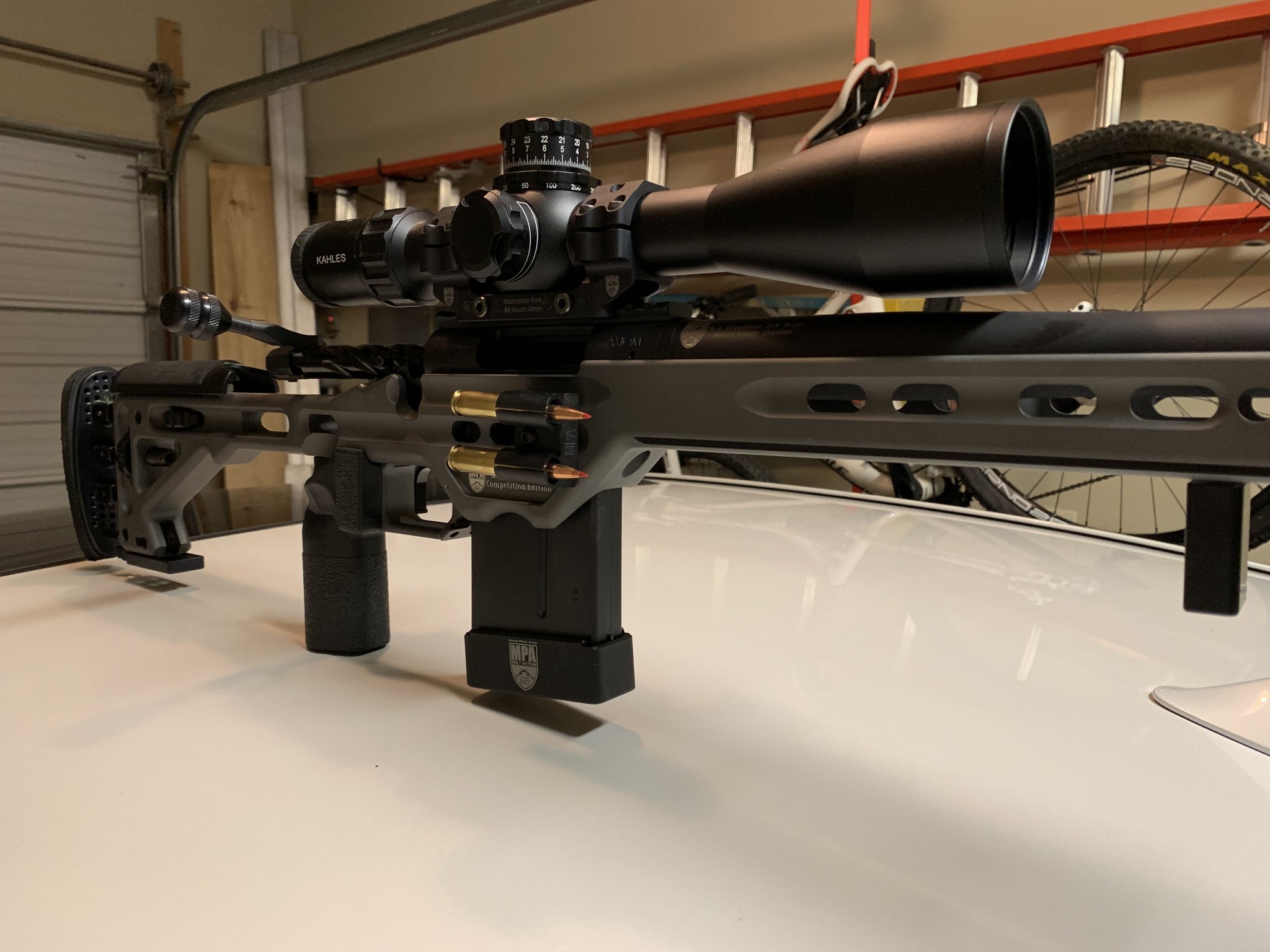

This is how I believe they are supposed to be installed. Works well for me so far.

If it uses the same attachment point as their data card (I think it does), you have to crank down on it pretty hard to spread the metal and squeeze it against the chassis. It took me a couple tries, but solid once I got it.
View attachment 7020182This is how I believe they are supposed to be installed. Works well for me so far.
That's exactly how I have it on my rifle, works perfectly...
OP: it took me a good 10 minutes to figure out how to properly get it installed, just have patience with it and experiment with different "lug depths" and you'll be ok... BTW, make sure you have it angled properly (so that if you look at it from the top, the tip of the rounds is closer to the chassis than the head of the case.
