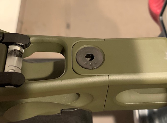

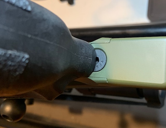

    Even easier than changing your cheek piece height is to remove the butt stock. One screw and it's done. Which is another critical point to make sure is tight before a match. More than once have I had the butt stock loosen up during a match.
    I thought about that, but I looked at the under-side and there's a second screw that is half-covered by the pistol grip. Are there two screws to remove the stock? It sure looks like it, and one of them doesn't appear to come out without removing other stuff. See photos ...
    View attachment 7267410 View attachment 7267411
    I stand corrected. That's what I get for bourbon posting!

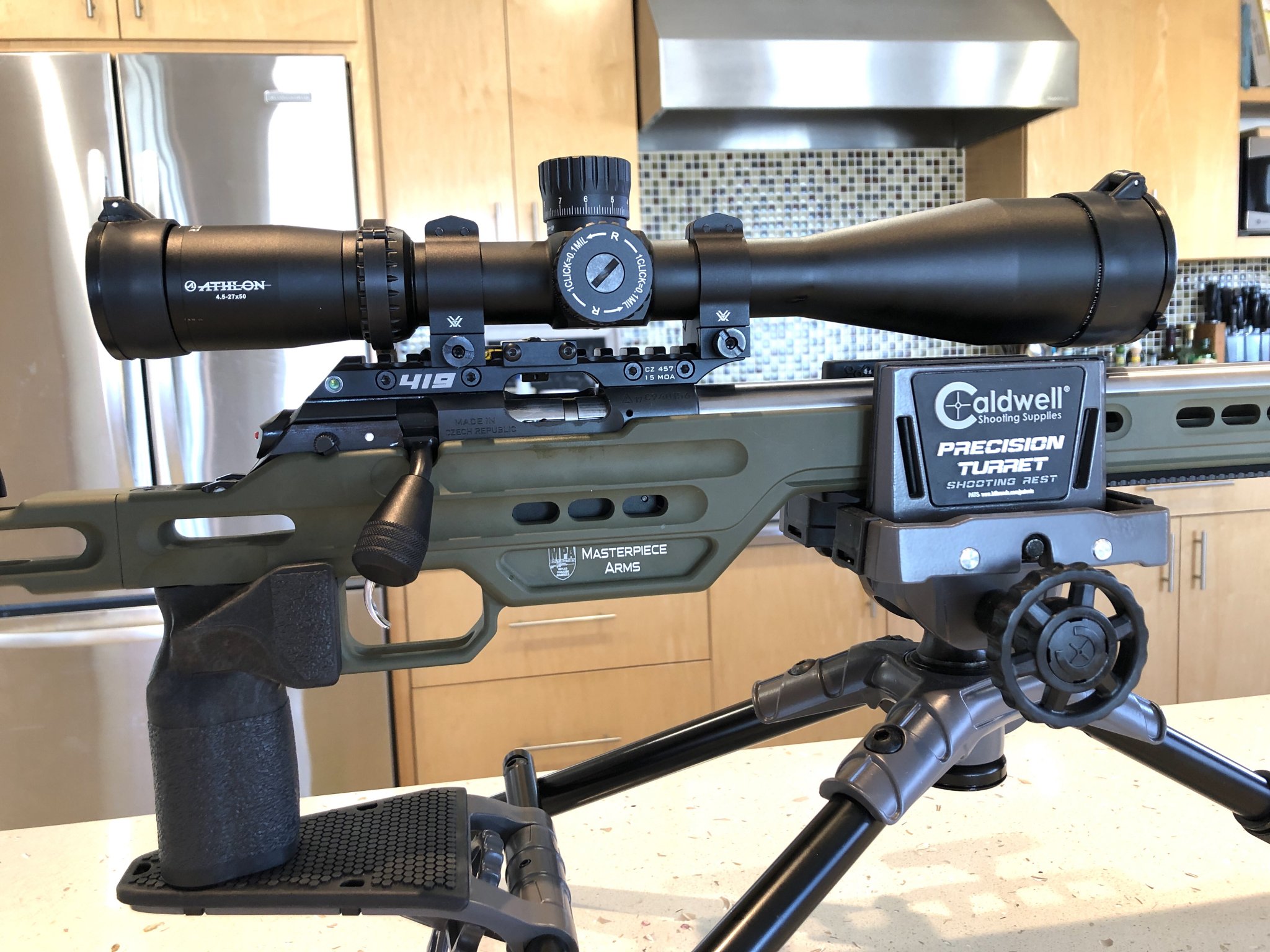

    Soooo this thread got me thinking about the “blanket 65 inch lbs” for the two action screws.
    1. Inserted front screw went to 25
    2. Inserted rear screw went to 25
    3. Front screw to 35, then rear to 35
    4. Then alternating action screws in 10 inch lbs increments, continued to check on any bolt binding
    5. Got to 55 inch lbs on both, checked on any bolt binding......smooth, no binding.
    6. Settled on 55 inch lbs, now to get it to the range, zero it in and make assessments!

    Can you give me the details on that cool scope mount? I want one !!!
    Bought it from Area 419, it’s 15 MOA. It is intended for CZ 455 or CZ457. The dove tail that is part of the action allows their rail to slide onto to it, and hex heads secure to the dove tail. It’s approx 6” + inches long and allows picatinny clamping of scope rings.
