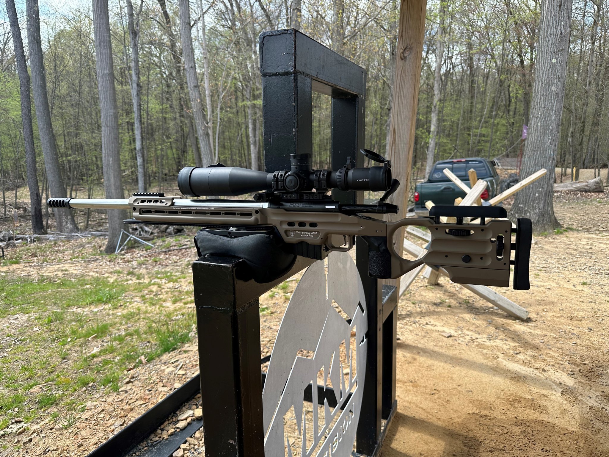

This is the 1.125” but with 34mm and a 56mm scope and a 40 moa base and 1.2” straight barrel and I have room so you should be fine.
I'm impressed. Several years ago I shot .22lr at 50 yds/meters. That was a challenge to shoot 250 25x. My gun platform was built off a Turbo action.
What's the setup of that rig you have pictured, if you don't mind sharing?
Actually a lot of shooters hitting to 400+ now with the .22s accuracy helps but wind reading is key at those ranges.
That rifle is:
Vudoo V22 action
Bartlein 23” 1.2” barrel with EC V2 tuner
Timney Calvin Elite trigger
MPA Matrix Pro chassis
MPA mount
Zeiss S3 6-36x56
I use SK Long Range ammo in it but also use Center X at times. I have a brick of the Lapua Long Range I need to try.
