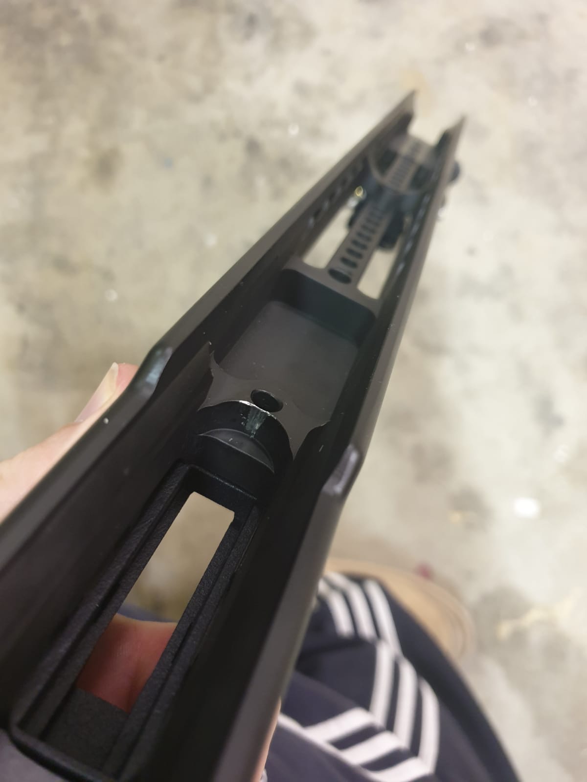

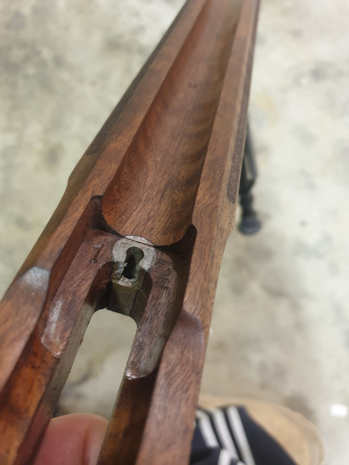

    Pop the chassis off and take a pic of the rear and front of the chassis inlet, your looking at the end problem and not the cause imho. I recon ike other 65pou s is way too much, cz recommends half that, and i reckon uts not seated correctly in the bedding if it is touching the spigot, possibly the bolts you are using are the wrong length too.... the more you push about shaving metal off the bolt the possibility of doing unessasary damage increases
    Here us the issue with mine im cureently sorting out...

    I think I have a solution, it appears mpa use a vblock type bed, not pillar, so if yours is like mine then if you pop off the barrel and fit the action you will probably see there is a gap between the bottom of the actio and the chassis bed where the front screw passes through, the back is most likely sitting on the recoil lug behind the rear pin, then when you are ratcheting up the tension it is forcing the action to squeeze between the sides of the chassis and the barrel is is dipping down into the chassis.... sound about right?
    that's a great thought I'll try it tonight when I get home from work thanks

    Im trying a little experiment with mine. After chatting with a local Smith we have concocted a plan. The mpa appears to use the vblock style bedding, there is no way that the pillar area is touching as they are well recessed , so it is sitting on top of the lug and the sides. My old wooden MTR shot really well so it needs to be as good if not better as that to be a viable option .... TBC
    Righto, I think i have a solution, im still not finished tweaking but it is definantly starting to show promise. With oit any mods if you over torque past 30lb you will start pulling the action front end into the chassis, you can see the barrel dipping down lower as you go.... so avoid this...
