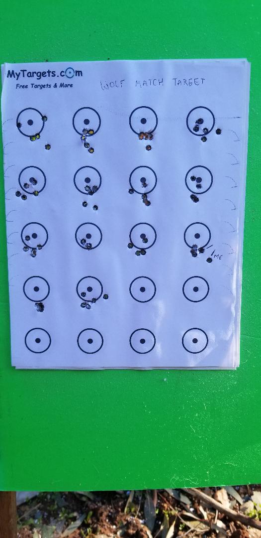

As for myself, I'm new to the world of precision rimfire shooting, and this is my first higher end precision rimfire rifle. I don't consider myself to be a bad shooter, but I don't consider myself a total newbie, either.
I'm working on finding that perfect ammo/position/contact combination, but this is a group I shot today. As a result of a reply on the prior thread by Seymour Fish, I tried to take out as many variables as possible. Barrel was cleaned by running a snake down the barrel, and I cleaned up the chamber with a bore brush. I then used Wolf Match Target in the prone position, first from the bipod (with the steel cleats inserted, not the rubber feet), and then off a sandbag. Prior to shooting the groups, I reset my zero, since the rifle had been taken apart to be retorqued.
Again, I am new to the precision rimfire world, and I'm hoping the scatter of the shots is something I can fix (whether me or finding the right ammo. I'll post more group pics later. Average overall velocity was 1061 FPS (averaged across the 100 rounds).

First, understand I am not familiar with your exact rifle/combo of parts, but several things you mention raise some concern and need to be looked at closely.
"I recently took the rifle apart and checked the torque on the two inward set barrel screws, receiver screws, and scope ring bolts. When I put the rifle back together, the bolt functioned much better. Something moved around somewhere."
This sounds like you have a screw intruding on the bolt raceways somewhere....remove the bolt and slide your finger over all the internal surfaces the bolt can touch. ALL screws must be slightly BELOW the surface. Remove the offender and shorten it.
The CAUSE of the broken mag well needs to be determined, if possible. It may have been a simple incorrect assembly, but may be something is in a bind in the chassis, may be as simple as a spacer or washer was put in the wrong place/order.
" is that they bolt will unexpectedly come all the way out when cycling the action "
This may be rectified by fixing the problem/s above, (again, I am not familiar with your CZ) but is probably a sticky part, either a burr somewhere or maybe just gunked up. The bolt release MUST move freely and fully through it's entire travel range with the bolt removed.
On your prone technique, cleated feet are not needed (unless shooting on ice or very slick, hard surface like ice), you are probably overloading your bipod and this causes inconsistencies, slight forward pressure is enough, the legs don't have to bend. I've found an ATLAS is much more forgiving, with a larger "sweet spot" than a Harris, but many disagree.
You are using a rear bag, correct?
I recco you buy some cheap ammo (CCI SV) and shoot at 25 yards until you learn to keep ALL shots touching. Make EVERY SHOT count, THINK about every step in your position/cheek pressure/bipod loading/sight picture/trigger pull. When you can do that, move to 50 yards, then the higher priced ammo, when you can out shoot the cheaper stuff.
There's absolutely NO REASON to waste money on 1/2 MOA ammo when YOU can only shoot 2 MOA.
DRY FIRE is actually MORE important than shooting. Put up a tiny dot at 25 yards (make sure you know how to check and adjust parallax properly, it's NOT just the clearest focus on your scope). and watch your crosshairs closely when you break the shot, ANY crosshair movement requires fixing, adjust until you figure it out.

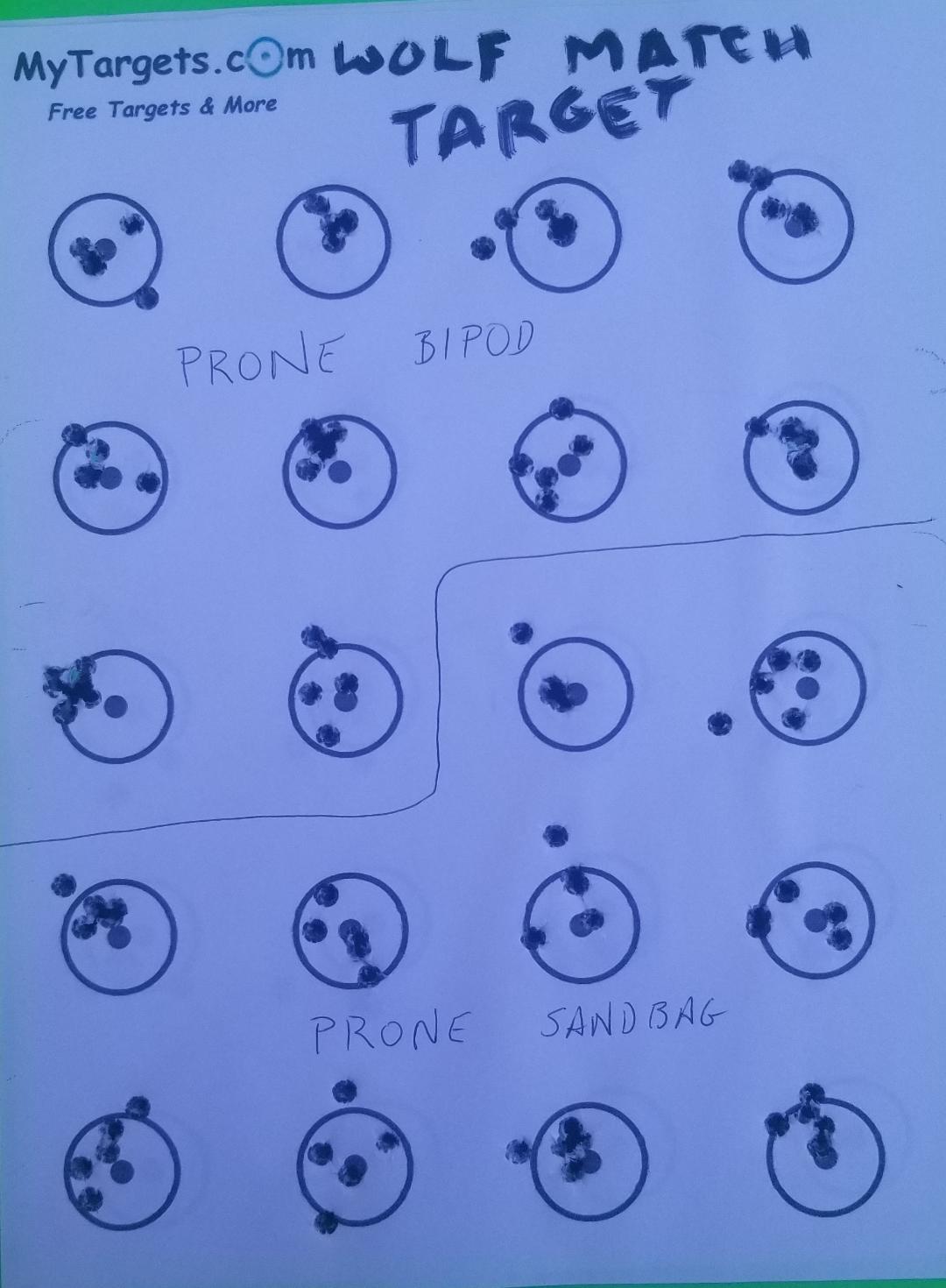

I was able to shoot the rifle today, hoping to have some positive result from the changes I made, and some groups were very nice. Unfortunately, there was still inconsistencies. (I couldn't bring myself to drop the range down to 25 yards just yet.) Ammo was Wolf Match Target again.

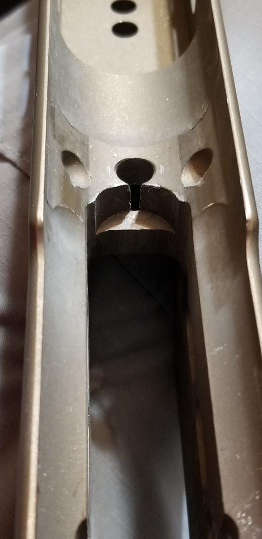

I disassembled the rifle and receiver from the chassis one more time, and noticed something I hadn't before. Stupid me, I took for granted that the chassis would allow the barrel to free float. I found the two screws holding the spigot mount to the forend were impinging on the barrel enough to leave marks on the barrel.
I'm hoping that this is the cause of the problem. If not, the rifle is going over to my friend's place so he can test drive it.

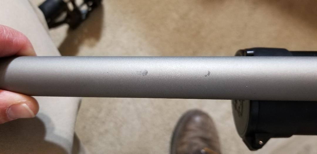

So another update on this one.. I shaved the tips of the screws off to clear the barrel. Took it out today after torquing the chassis back to the receiver. I DID check the clearance with a piece of cardboard about the thickness of a business card. It was a bit close at the forward end of the receiver, but felt it was clear enough. I shot CCI Standard to get back on target and then fired for groupings. I'll be damned if it didn't look about as bad as before, if not worse in some cases. I checked the forend again by eyesight, and it was CLOSE to, but wasn't, touching. Took the rifle apart and tried to get some shimming in the chassis, and really only found a good spot just forward of the receiver. So, about 1" of the rear of the barrel has a shim on it. Shot some more of the CCI with it, and didn't really do anything for it.

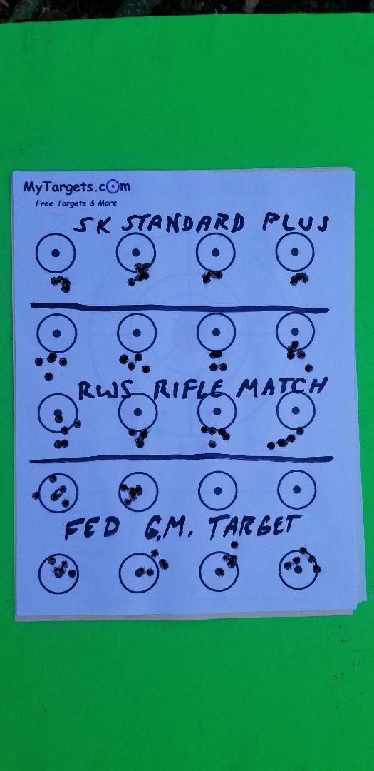

Just before calling it a day, I shot the remainder of the SK Standard Plus, and Thank Goodness, found an ammo that seemed to shoot well. So, in other words, my rifle doesn't seem to shoot CCI Standard, which seems to be a fairly common go-to ammo for a lot of people. Now, I need to wait for more ammo, since now I only have CCI Standard LOL.
Whether the shimming did anything for accuracy with the SK, I don't know. I DO know that the forend has much better clearance now than before.
When looking at the pictures, you'll see that under the SK, I also shot RWS and Fed GM Target that didn't shoot well either.

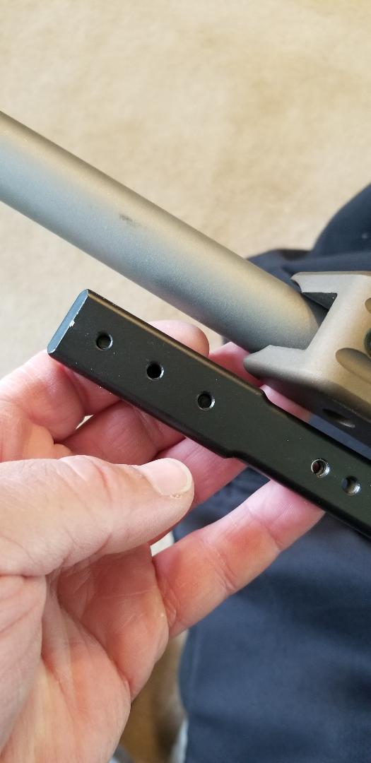

Another note (problem) on this rifle. I found that the screws holding the barrel into the receiver were protruding out of the receiver and were contacting the chassis. Ordinarily, I think the MPA chassis was designed to accommodate this with two small pockets machined into the chassis that can be seen in the picture above. But what I saw were marks on the chassis behind those pockets which to me showed the pockets may have been misaligned.
The chassis is designed with one raised section left and right of the centerline of the length of the chassis that are about 1" long each. The receiver is centered in and resting on the chassis with these sections. The dimples are machined at the forward edge of these sections. These two points and where the rear tang rests on the receiver are the only points on the chassis where the receiver rests.
I found machine screws at the local hardware store that are a bit shorter than those supplied by MPA and have since changed them out.
Now with the front of the receiver sitting lower in the chassis, there is JUST enough room to slide a thick piece of paper between the barrel and the chassis. I know the aim of freefloating a barrel is to achieve at least that amount of clearance, but for this system, I would like more, especially since when I apply pressure to the two, I can achieve contact between them.

I attached 3 pics. One shows the barrel screws, another is a not great pic of the clearance at the front, and the third is a close up of the dimples and the protrusions the receiver rests on.

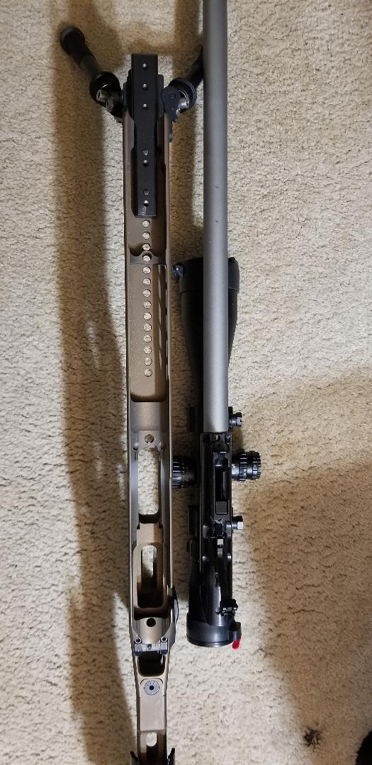

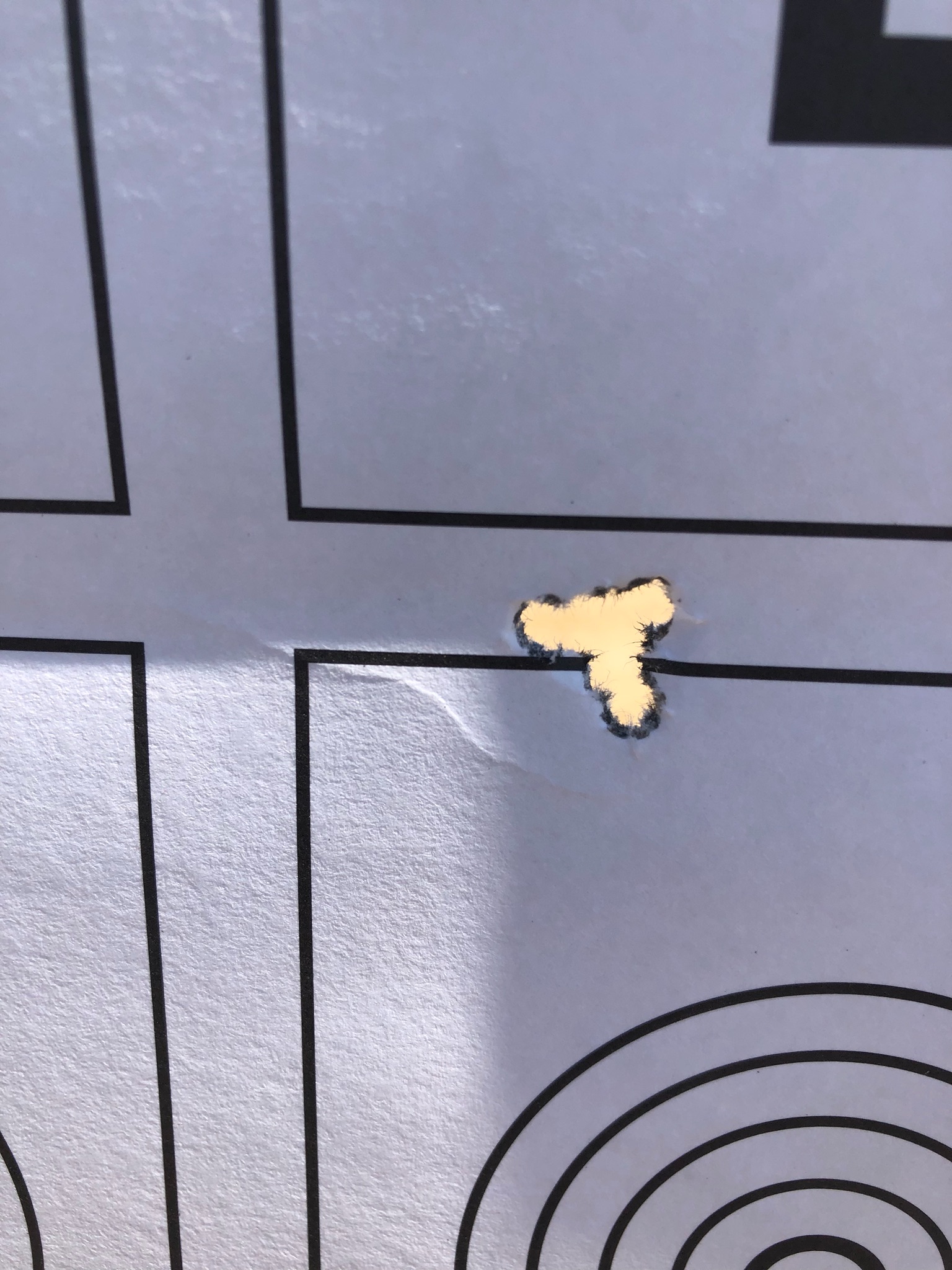

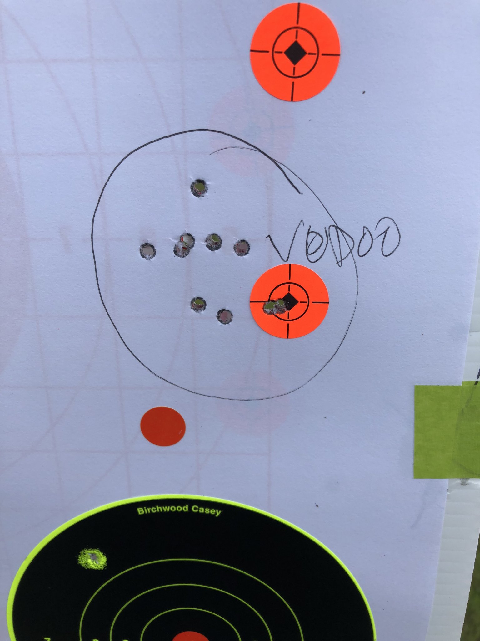

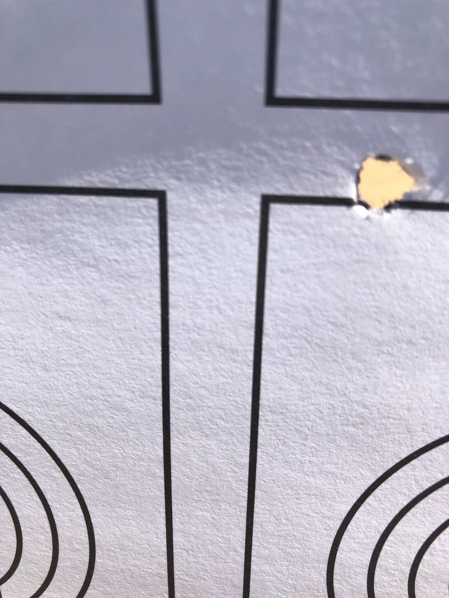

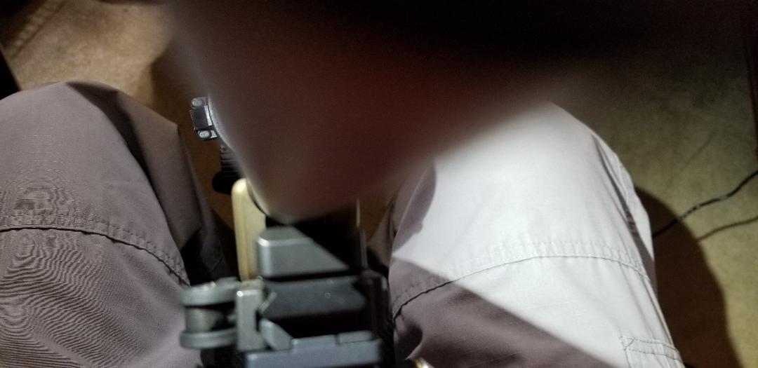

Not exactly the same issue, but: picture 1) was a Vudoo 22 in a MPA chassis. Picture 2) was switching to a Manners stock at 100yds, Picture 3) was same setup at 50yds.
Turned out the issue was interference with the magazine, once we figured that out the MPA was as good as the the Manners. Little things make a difference. Don’t give up on the MPA.

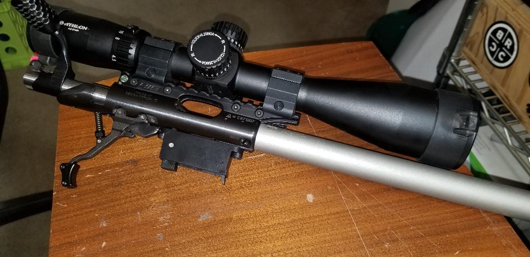

I like the MPA chassis and really would prefer to keep it under the CZ action. However, MPA really screwed it up with my setup. I did buy the rifle new, so I'm not sure how the chassis to action fit got screwed up so badly. In addition to the raised screws I had to shave off and the barrel retention screws that I had to change out, I found today that the barrel was bouncing up and down on the spigot mount (the black anodizing of the mount is worn off ever so slightly, and there is a corresponding mark on the barrel). As to shimming the action, I did that once already, and it shot the Wolf Match Target well, but I raised it up quite a bit and didn't want to torque the action much. To get that much of a lift away from the chassis again, I would only feel comfortable bedding the action, or shaving off some of the chassis section that it was close to.
I am going to send MPA another letter, and see if they'll ship out a new chassis first, with a return label for mine - I don't want to send this one back when the question of their customer service is in doubt.
I attached a pic of the spigot mount, and I found some wearing on the section of the chassis where it's closest to the barrel, now, as well.
It sounds like you put the Vudoo back in the MPA and shot it after fixing the mag problem? And it shot well after the fix? How was the mag interfering? Great groups, BTW!
Is this a common issue or was this an issue specific to this rifle/chassis combo? Was the inletting bad on the chassis? What I'm getting at is if I buy a vudoo with the MPA, will I have similar issues or have they addressed it? Thanks!
No, the issue with that chassis -rifle combination was not resolved. Shooting it in the Manners.
The MPA is being used with a deviant 700 and absolutely no issues.
My thinking leads me towards a mag interface issue. I know folk that run the MPA with they’re Vudoo and have no problem. I have 3 AISC double stack 10 round mags for my 6 Creedmoor, 2 work fine the other doesn’t. Not so much of a chassis issue, but a mag issue.
Did you bring up this issue to Vudoo? Curious, I thought they tested all rifles before sending them out. Seems odd that this would miss QC
