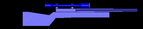

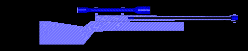

If you wanted something kinda effective it would have to be something along these lines with weight up front
http://www.varmintal.com/aeste.htm
Reactions: echo6tango

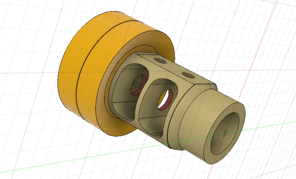

The new EC tuner brake might be the closest to ideal tuner brake.
EC tuner brake is one of the first muzzle brakes i have seen to actually move the tuning weight past the muzzle, only limitation might be if its heavy enough given it same diameter as the brake and has minimal adjustment range.
https://erikcortina.com/shop/ols/products/ec-tuner-brake-ss-65mm
The weight is a bit light for heavier contour barrels.
The original posted in this thread absolutely changes my group sizes. This brake didn’t.

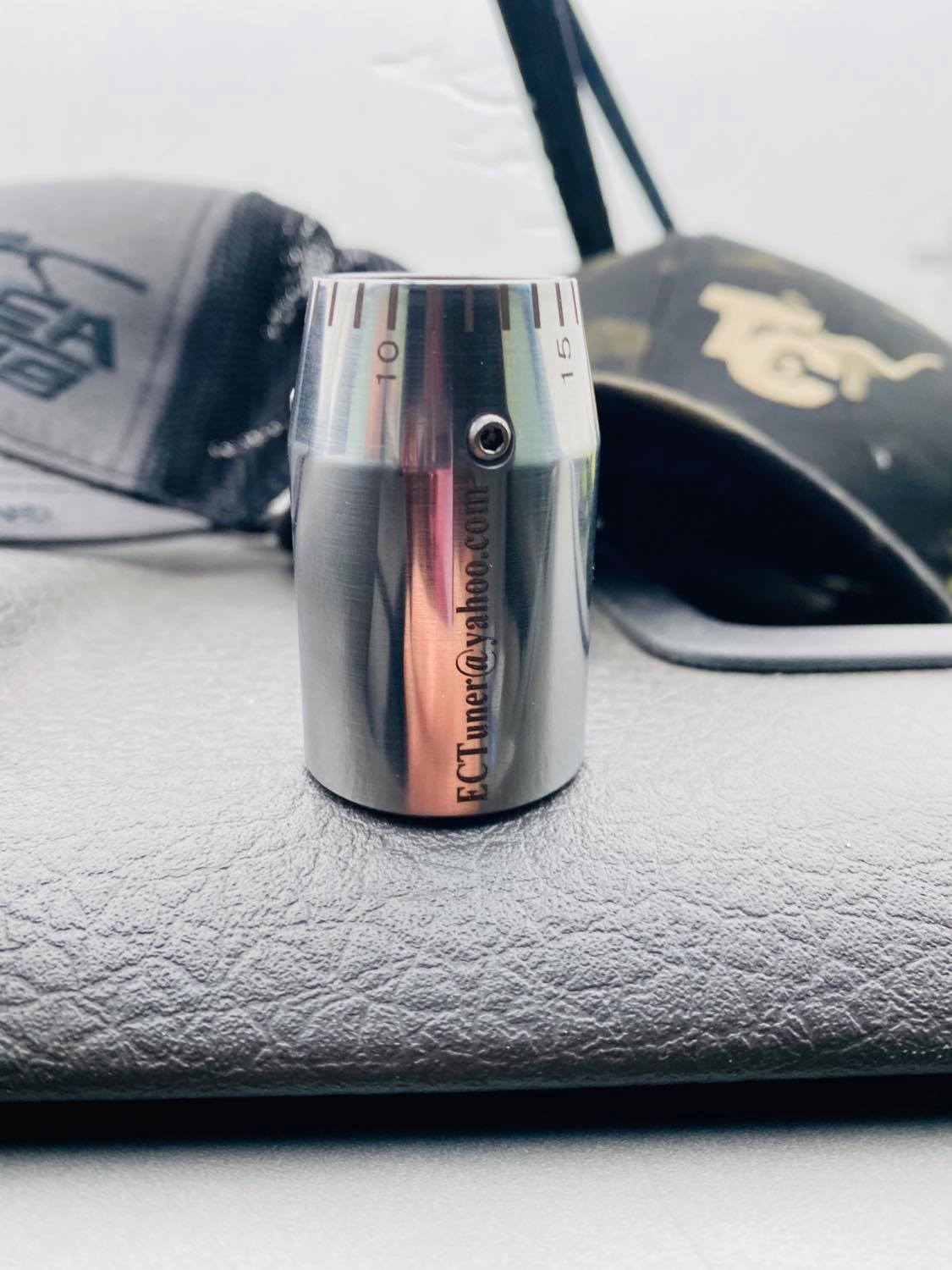

Total weight of the device is good for determining the dampening affect but weight of the actual tuner is what’s important. Do they list tuner weight or just device weight?
Listed EC tuner weights
Normal tuner is about 6oz
The one on the brake is 1.75oz
Reactions: rydah
