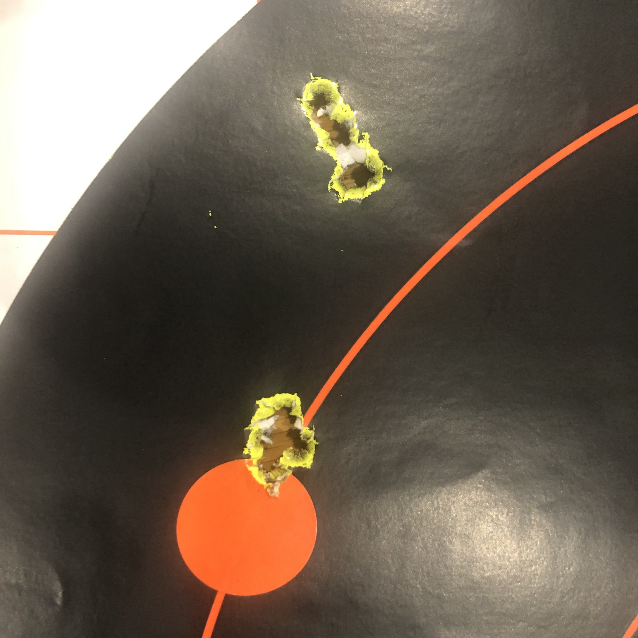

First pic below is a three shot group at 100, and this is not abnormal for the Berger loaded to mag length.

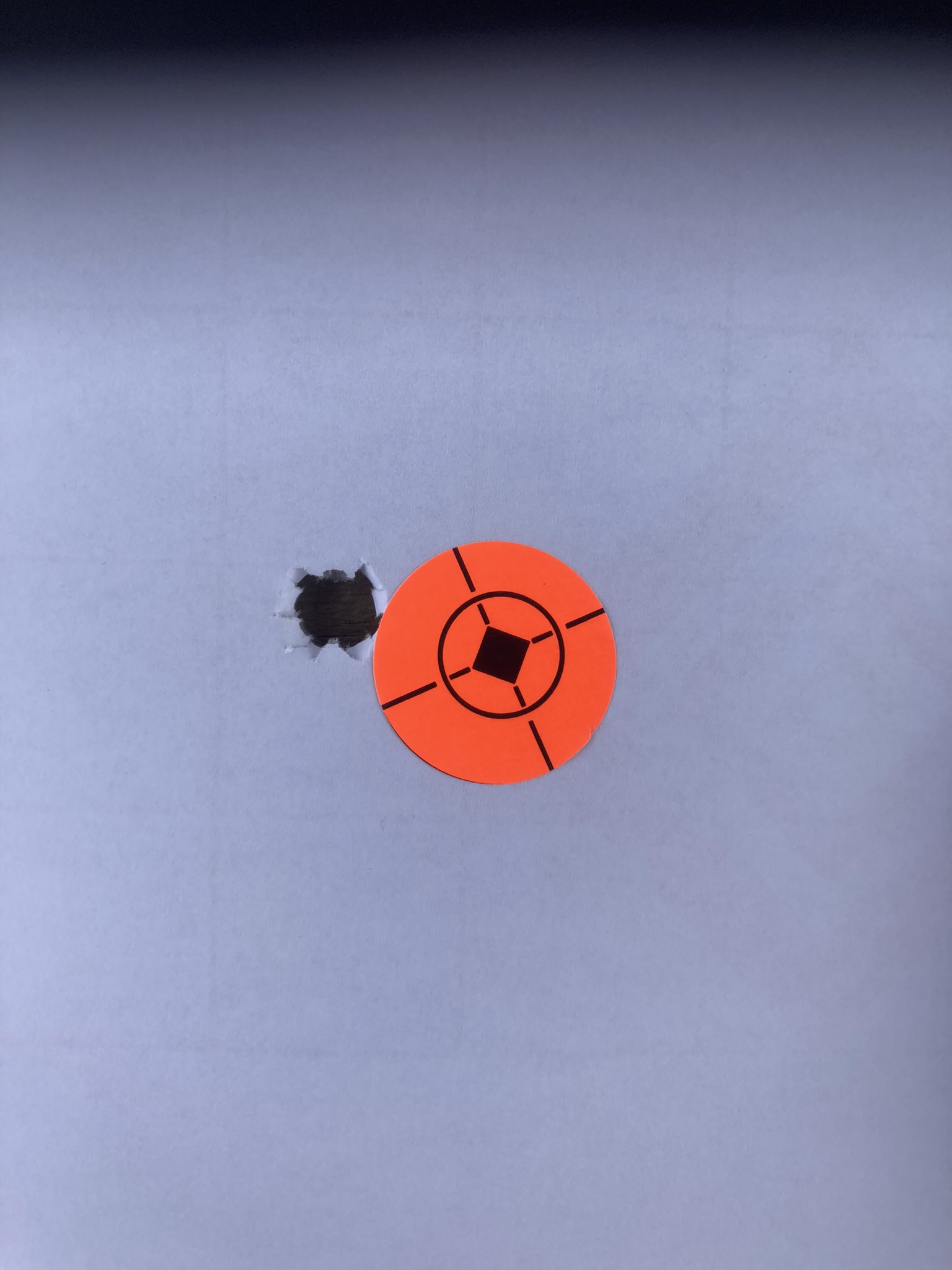

The second pic has two 5 shot groups at 100. Scope was dialed to offset the groups. Both done with a Berge 140 Hybrid, H4350, and a short jump (single feed). One group was around 0.35”. Second group has three though one hole, two through rhe second hole, because i broke position. The 035” is close to my “best” performance, mostly due to my limitations. Has seen one 0.1” three shot group, but that might just have been luck. The gun shoots better than me - by far.
Like me, you will likely find that because the Berger Hybrid is a very pointy bullet (secant profile around the nose section), if you want to load it to say a 15 thou jump (where better accuracy is possible) that the loaded round will be very long, and it won’t fit in the mag anymore (single feed only).

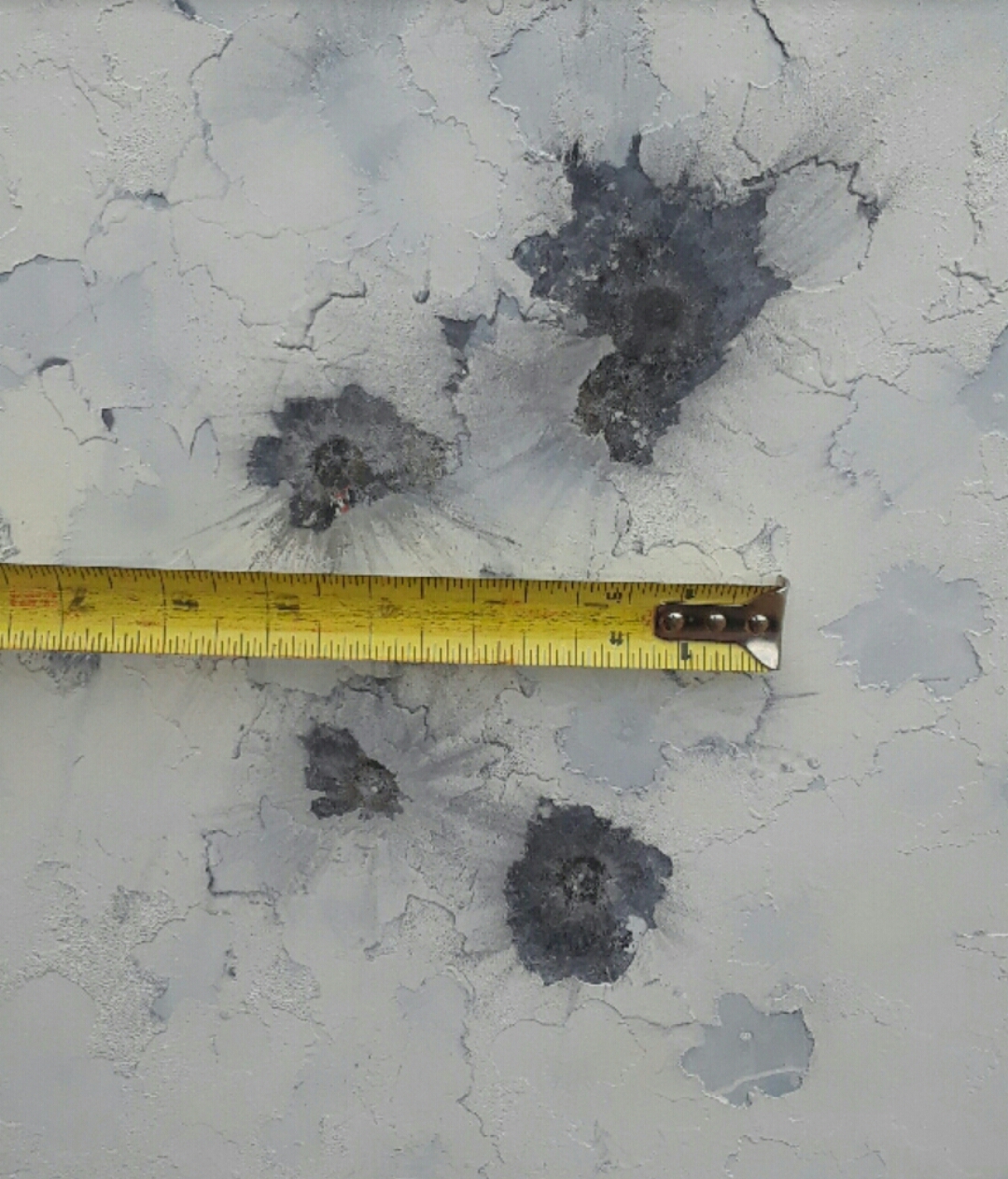

130 Grain Norma Golden’s. Three shots (primer/powder/bullet shortages precludes shooting 5 shot groups. Mine will put 130 Berger VLD’s 130 grain Sierra Matchkings and 130 grain Norma’s into less than 3/8” all day long.
