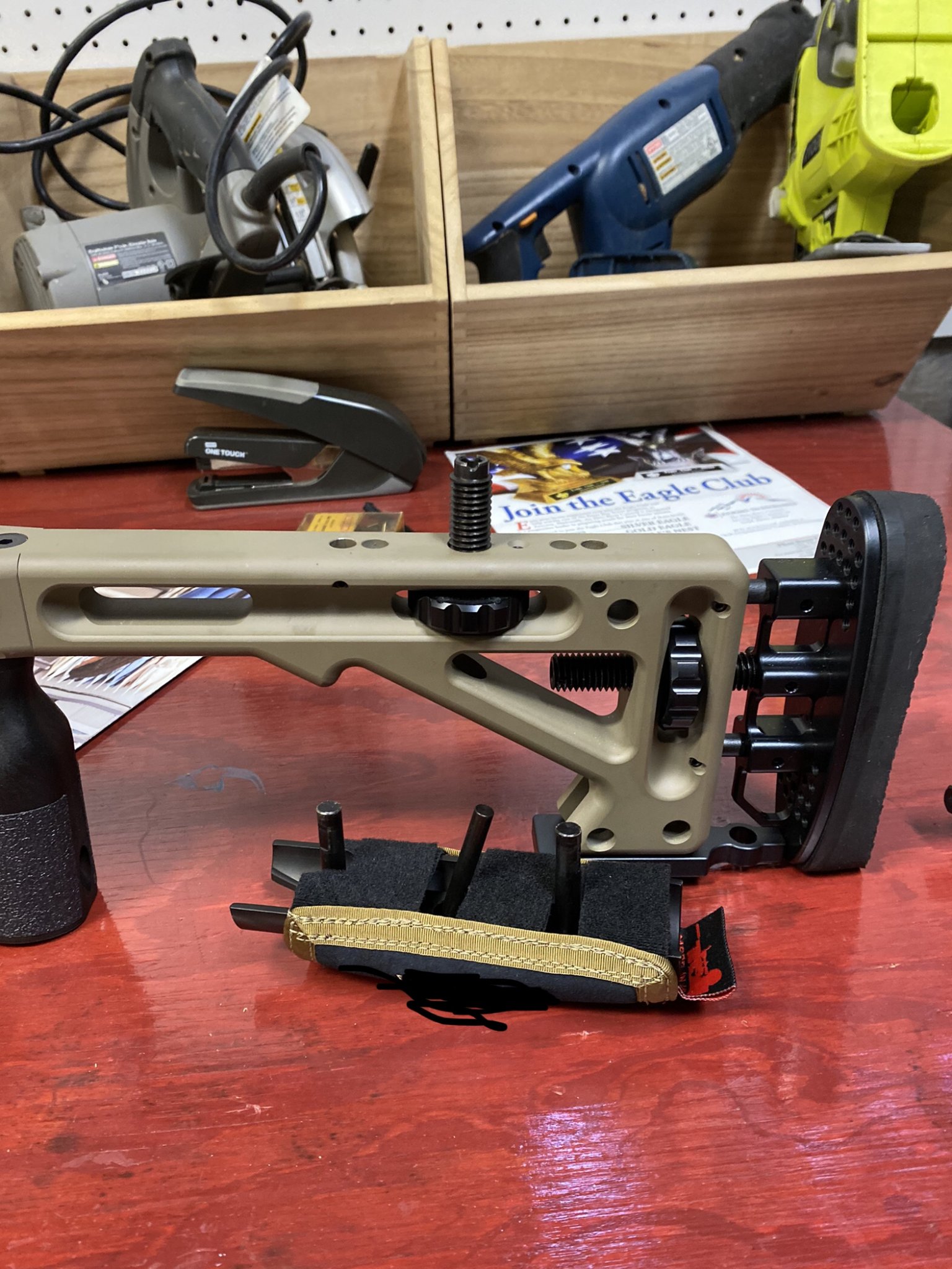

MPA chassis-does anyone else have to remove their cheek piece to use a bore guide?

    I have tried a few guides and the possum hollow fits great, but any of them require me to remove the cheek riser to get the guide in there. Kind of sucks. I also need to figure out some way to get a better feel on my cheek with the riser. Any suggestions or tricks from those who have been running these chassis for a while would be greatly appreciated! I love the chassis, just need to figure this part out.
    I adjust it all the way down, then you can fit the bore guide in. The folder would b easier, but this isn't exactly hard.

    Quick detach works fine.
    I got the quick detach and a boretech bore guide for my MPA comp chassis. The screw for the quick detach still gets in the way.
    Sounds like a good excuse to get the folding stock adapter ...
    Yeah I think this is the most likely resolution... but I have 2 identical set ups in different calibers, and different colors. That would be 2 folders. Maybe should just sell em and get 2krg? I have hybrids so not sure of the weight of others.
    Couldn't I get the folder for the BA comp and put it on my hybrid so I'd get the thumbwheels back? I miss those
    I don’t think you could go wrong with either of those options. I could see myself getting the quick detach personally.

    Yeah I can do that too but still have to move it all the way down so... guess I either need toget the quick detach or a folder
    Get the folder. With the quick detach, the screw still gets in the way. I got it thinking that it would suffice. It doesn’t. Think I will have to get a folding option installed if I want to clean my rifle without having to remove the cheek riser or the recoil pad lowered.

    He did get back to me. Said the ba comp folder would fit, but it was "1/6 wider than the hybrid"
    I replied late today asking about the "1/6" to see if that was a typo. I'm hoping it was and it's 1/16. I could probably angle that much out and cerakote it and have a good looking rig. Will update when I find out more.
    Woody just replied and said it was a typo. Should have read ".06" so that would be a tiny bit less than 1/16", which I can live with and easily sand down an angle and re-kote if it really bothers me.
    Glad to hear that it’ll work. I would think that would manageable to work with if you wanted to make the fit and finish perfect and more than adequate with a .06 that it would be tough to even notice it. I’d be interested to see what it looks like once you get it installed.

    On 1 so far I machined the set screw hole larger to accommodate an easier bolt. I removed the adjustment wheels and just use the set bolts now that engage the guides. Made plastic spacers so that when removing I just drop it back on and voila the height is the same.
    Same thing on butt pad except no spacer because I made my own plates and they already index to location.
    Now pulling cheek and butt are easy peasy

    I have it easy. I build recycling and the such production lines for a living. So I also have a full machine shop I own. It doesn't cost me anything but my time to play and modify. Which is also why I have so many of each 1 thing. I can modify and replicate after rhat.
    After I get back from next work trip I'll try to remember to take some pics of the changes.
    Yeah that would be cool. I may end up going a completely different direction and just getting an mdt acc . It's not quite as light weight as my hybrids, Butttttt, I really like the stock. I got to use one a little bit and I just like how it adjusted in a few places. Of course I like the mpa everything else so...
