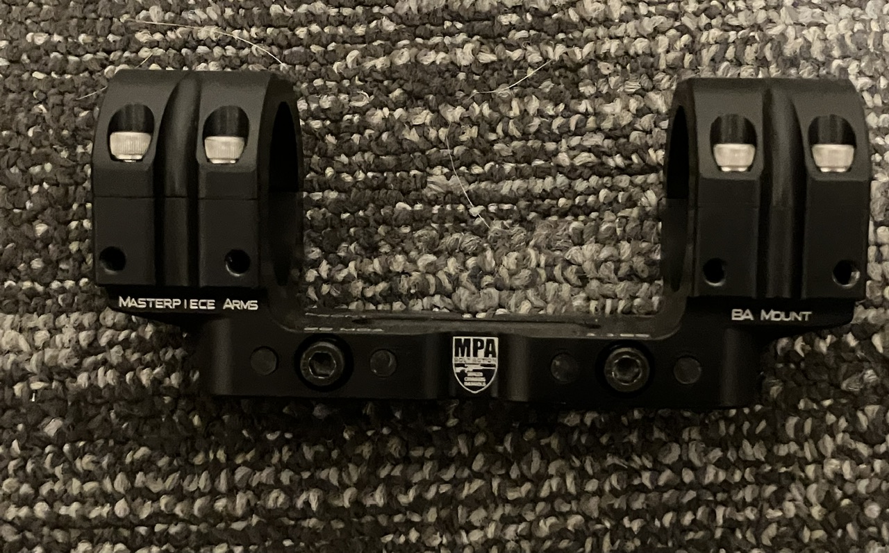

Hello, I have an MPA BA PMR PRO II coming in 6.5 Creedmoor soon and a Nightforce ATACR 7-35x56 sitting on the shelf for it.
Should I do rings or a scope mount? Any idea what height I should get to keep the bell of the scope closer to the barrel? (not too close but like a 1/4" - 1/2"
Any other thoughts?
Thanks!

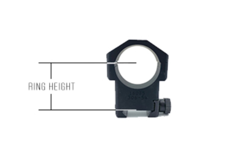

Rings or mount doesn’t matter. I do rings as it’s cheaper. Somewhere around .9-1.125 should work but the trend is higher, you have a cheek rest that’s adjustable to accommodate that.

Rings are often cheaper from the same company and more flexible for scope mounting position adjustments. A lot of the newer 1 piece mounts have almost no room to adjust the scope in the mount itself, so you are stuck with only being able to move it on the rail. With some scopes with a longer eye relief and rifles with a short rail, esp. if you have a shorter LOP, you can run out of room with a tight 1 piece mount. I tend to default to canti mounts just because I've ran into tons of setups where a non-canti mount would not go far enough forward, but I've never an into a setup I could not make a canti-mount work with ease.

I love mounts better for the one piece design, and if you buy a reputable brand i.e. Spuhr, BO, Gray, Gieselle, NF, etc you can almost bet they are most times, concentric & square (I say almost because men and the things we produce are prone to error and imperfection)
If you go ring just make sure your height is correct (often times people buy too low)
If you go mount, I'd wait until scope is in hand and measure properly

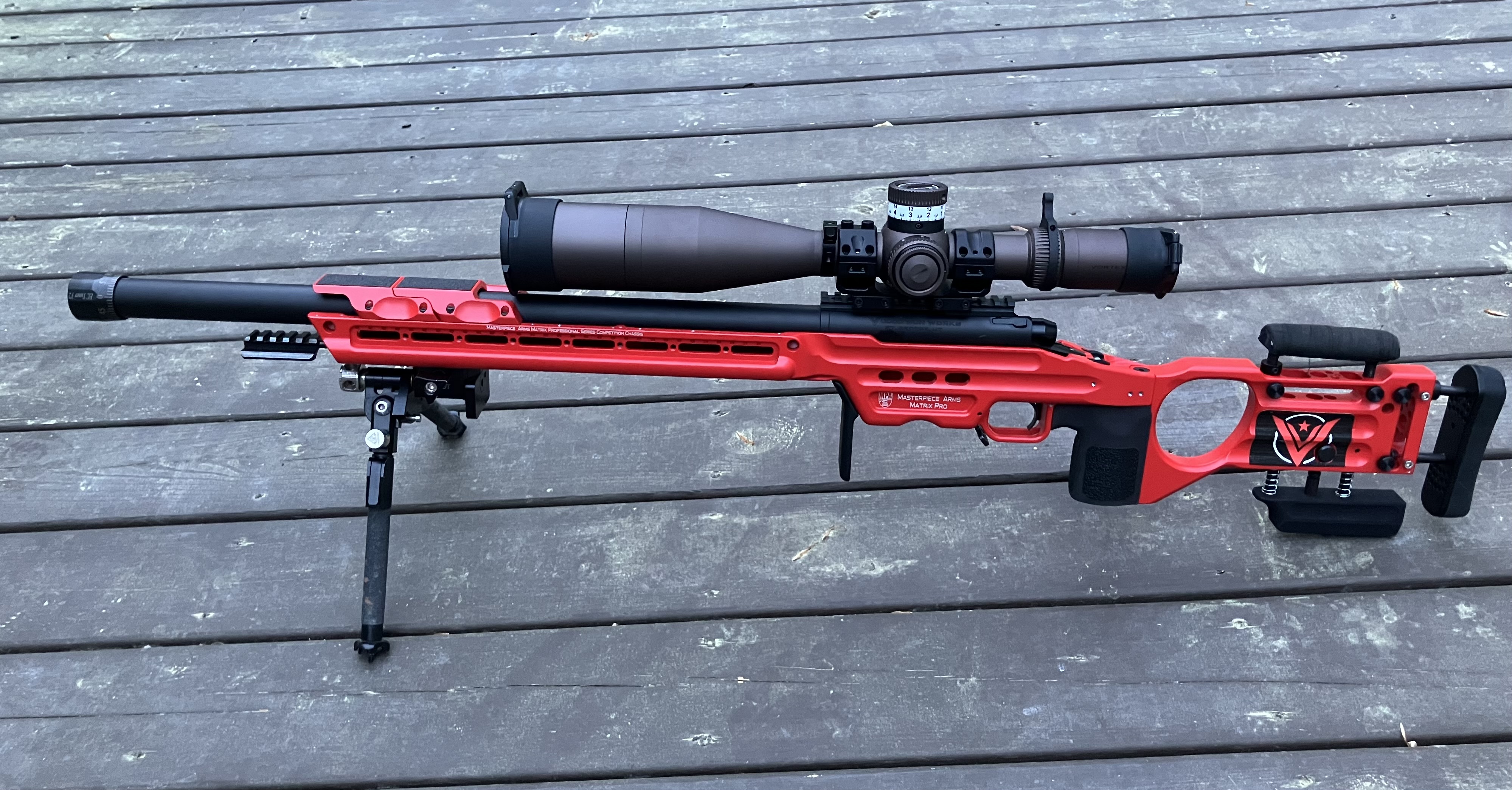

For reference here is a pic of a MPA Matrix Pro II chassis with my Vudoo in it with a 1.26” height mount holding a scope similar in size to the one you plan to use. Asking you can see the chassis has plenty of adjustment.
