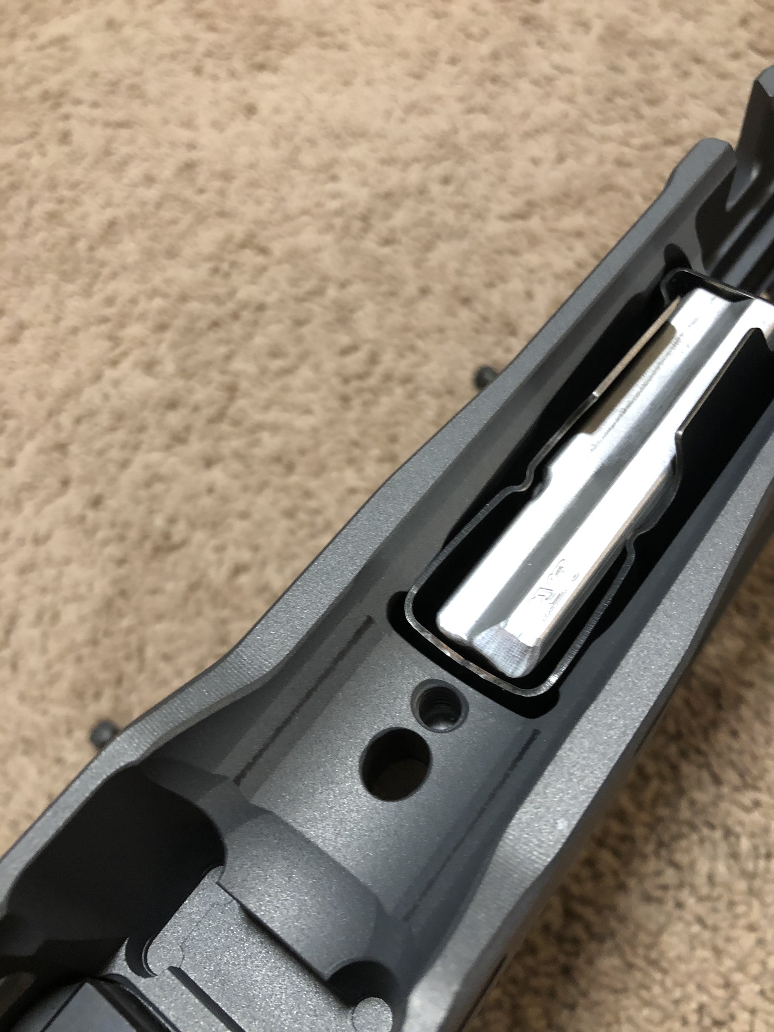

Wanted to post this here and get it out of the build forums. Will update as I hear back from MPA and BigHorn and try different things etc.. That way I can pass along what I learn to anyone else.
Just got my first build done with everything coming from Altus in Florida. Guts are the Bighorn TL3, AW cut action with proof stainless barrel resting in the MPA Comp chassis folder (new one without the castle mag cut). Barreled action is in the chassis torqued to 65in-lbs and the MPA lug lock is in and torqued to 30in-lbs. No mag no problems... action is smooth and slides easily in and out with no binding or catching.. Try to seat a magazine and problems start.
I got a box of ammo down the barrel and break in is done. Having mag problems though. Rifle came with a 5rd Accurate Metal mag and trying to get that mag to seat with rounds in it is difficult and to use that mag and have it feed feels like I'm trying to close an action full of sand and gravel and the brass has some nice scrapes from feeding out of that mag. Have to use a lot of force on the bolt knob/handle to get it to strip the round and chamber and it binds up and catches. If i press my thumb on the back of the bolt assembly where the firing pin cocked pin protrudes I can actually get the bolt to close easier without any binding.
Switched over to my magpul 10rd and 5rd AICS mags and those don't want to seat at all with any rounds loaded in them and when I could get em to lock in place the bolt feeds a couple of rounds fine but then I get the bolt riding over the top of the rounds and the mag follower is stuck and the rounds arent coming up high enough.
This is with a brand new magpul aics mag and ones that are older and work fine in my other rifles. The magpul 5rd mag seems to work better as far as feeding goes but still does not seat properly.
Got home and tried the magpul "fine tuning" like MPA has a video of with shaving a little material here and while now they lock into place fine, they still have same feeding / bolt over the rounds issue. So I think the TL3 with AW cut I got isn't going to run with the magpul mags... which sucks... cause they've worked in every other rifle/chassis I had... So that leads me to metal mags and trying to decide on which ones to try now.
Emailed MPA and BigHorn to ask what could be causing the issues and also what suggestions they had for me. Seems to me like the magwell in the chassis is too tight for the magpul mags causing them to bind and follower not work properly. But the accurate mag maybe rounds are too high up and thats why there’s so much binding and requiring so much force to chamber a round.
**UPDATE 1 - botched a magpul mag up with trying a little at a time sanding in order to get it to seat properly. Was able to get is to easily seat and lock into place but still was getting bolt over rounds and could not make it through a 10rd mag without having problems.
**UPDATE 2 - sanded and adjusted the feed lips on the accurate 5rd mag some and can get “easier” feeding but still binds up my action and bolt throw trying to cycle through the rounds quickly and brass is getting scratched up still. But still working on this mag to fine tune it and see if I can get it working smooth.
**UPDATE 3 - MPA wrote me back saying that the short 5rd accurate mag (which shipped with the rifle) is too short to lock up and seat properly and that could be causing my feeding issues. BigHorn wanted and got some pics sent their way. Altus said they would reach out to me and call. Member here is sending me an AICS mag to try and I'm going to try to borrow a 12rd MDT mag as well to try.
**UPDATE 4 - more polishing and tuning the feed lips on the 5rd mag (actually closed the gap some so rounds weren't up as high) and it is seating solidly and a LOT easier to feed and cycle ammo and brass isn't getting chewed up. Going to polish a little more and run the bolt tonight on and over the mag while I watch some TV and wear it in more. Gave up on the magpul mags after losing one to the modification bin... but have a bud that wanted / needed some so that works ok. Hoping the AICS and MDT mags work out the get go and then I can just pick some up of my own. Still disappointed that it required that much work and tweaking to get a 5rd accurate mag to work but with all the reading I've done it seems like that is the case with metal mags and a lot of rifles members on here have.
**UPDATE 5 - talked with Altus, BigHorn and MPA. All three suggested same things as members on here and that some ‘tuning’ for metal mags might be needed. Never realized that would be the case until this rifle build but with their suggestions and everyones help on here I’m getting it sorted out. What i’ve learned so far.... Magpul mags simply don’t fit in my chassis without too much modifying. Too tight in magwell causes follow to bind and the front of mag feed lips hit inside at front of action so those mags are gone. My only metal mag (5rd accurate - came with rifle) is super short in the magwell (MPA said it might not actually be able to seat and lock properly) is seating fine and mag lips were adjusted from 0.445-0.450 (maybe more) down to 0.410-0.420 and the bolt is not binding and dragging / chewing up the next round and it seems to be feeding a lot smoother and better now. Never had to tune a mag before but also never had metal mags and a custom action. All a learning curve for me but I think things are smoothing out and getting sorted. Huge kudos and thanks to the companies ( @BigHorn / ZAI Team @MPA @Altus ) who all emailed back and forth with me and offfered their tips and suggestions. Big thank you also to the members on here who calmly dealt with me and all my questions and concern with my new rifle build and (calmly) offered their help and wisdom with me and my not being able to understand the quirks that can come with doing a custom build ( @Sheldon N @reubenski @padom , and everyone else ). After I get the borrowed mag(s) in hand and try them out I’ll do another update to this and then hopefully be able to start a new thread about how amazing the rifle build is working out for me. Thanks and Cheers!!
** UPDATE 6 - Final thoughts and mag results testing for me is done and posted below.

As far as the Magpul mag--I have both an AW cut and an AICS cut Tl3, and if I recall correctly, AICS mags runs great with AICS cut, but not well with the AW cut. You would think, since its wider, the AW cut would not have an issue, but someone who knows what they are talking about on here pointed out the issue to me once--I believe it is that the AW cut does not stop the mag in the proper place (vertically), which causes issues.
I can force a magpul AICS mag into my AW cut TL3, and it will go and feed okay, bit something does not feel right and there is tension on the mag release lever when it locks in. In the AICS cut Tl3, no problems. That may be your issue.
In the AW cut TL3, I have good luck with all other mags: AICS, ARC 10 rounders, and AW mags.
Hope that helps.
Reactions: Cajuntransplant
Only issue I've had is with AW mags. Rest run fine, don't know that I've tried Magpul. My bet is the chassis mag catch is out of spec, sounds like on the short side, so it's harder to strip and a steeper angle up the ramp.
Try another chassis if you have one, or a buddy's and see what happens.

I read through all that this afternoon and I think tweaking the accurate mag I have has made it better. Magpul mags will not seat properly at all. Modified them to get it to latch and seat eventually but mag itself was binding somehow and causing follower to stick. Going to try an ARC 10rd mag. Only plan on ever using it for 6creed, 6.5creed, 308, 22creed, etc. not interested in the short dasher cases yet. So I think the ARC should be ok.

I think the mag well doesn’t like and is grabbing the magpul mags weird causing them to bind up. Tweaking the accurate 5rd mag has it working better now but not great. On the hunt for metal mags to try out now.
Hope that helps.
It does help. And I did read something about the magpul mags and them jamming up that someone else posted up about. I’m on the hunt for metal mags to try out now.
For the AW cut in an MPA comp chassis you need the MPA Long Action mag release catch. You’ve alomost certainly got the short action one installed. Call Josh at Altus. He’s familiar with this and will get you sorted.

I’ve never heard of this. I’ll shoot them an email and see what they say. I got the whole setup from them so I’ll check to se what they sent me. Thank you.

@Sheldon N I understand what you mean. And I am taking him up on the offer for sure. Super generous of @reubenski and it is greatly appreciated.
And I’m not trying to blame any one vendor or anything I just am trying to understand what the hiccup is. MPA and BigHorn have both been in contact as well as Altus already this morning.
BigHorn wanted some pictures and MPA suggested a different mag catch but both have said (I think) the magpul mags might require modification to seat and function properly.

Update and final results.
Got a loaned AICS ten round mag in from @reubenski and feed lips are drastically different than the accurate mag I got in as far as spacing and how high rounds sit. The AICS ten round mag from him feeds flawless with no rounds doing grinding or catching or dragging as they get picked up and chambered.
So I took measurements and looked at how the rounds sat in that magazine and I tweaked my accurate mag a little more and it got even better.
I also ordered up (at recommendation from some friends) the MDT 12-rd magazine and it came in while I was out of town and I got to try it out and it feeds better than the accurate mag and almost as good as the AICS mag. I might just need to do a tiny bit of tweaking with it and get it broken in but I think it’s a winner too.
Magpul AICS mags (for me) are just a straight no-go as they won’t seat proper without heavy modification and I think get pinched in the magwell and cause feeding issues.
Learned a lot bout magazines and feeding and tweaks and tips with this being my first full custom build. Thanks and kudos to everyone offering their advice and tips and suggestions. It was all appreciated!! Thank you!!
